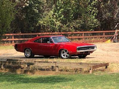

My '70 Charger weighed 3660 with the stock 318.
3750 with a 440/727.
4000 now even with aluminum heads.

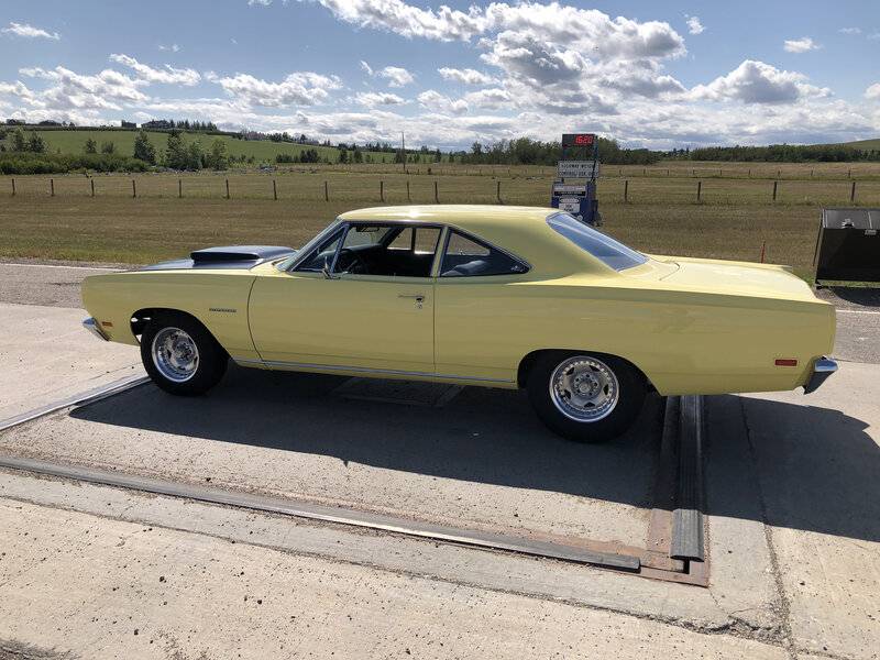

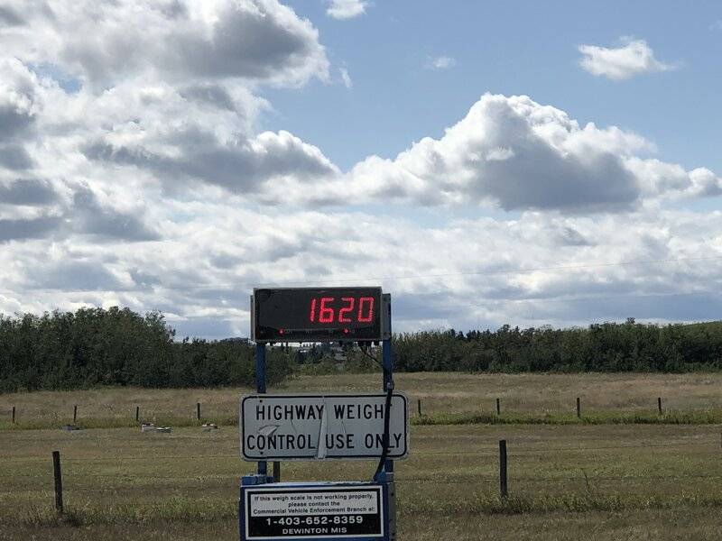

I agree with Kern Dog about the weight comments. Have a 69 Belvedere with light centerlines, lighter MT tires, aluminum top and front end on the motor and a Fiberglass hood and it weighs 3565 with a full tank of gas. Short of Fiberglass fenders, bumpers, trunk lid, and rear seat delete I don’t know how you’d get it to 3300 pounds

The picture is the cars weight in kilograms. Multiple by 2.2 to get pounds
View attachment 1192564 View attachment 1192565
Interesting... I thouht that all scales in the US were showing pounds, not kilograms :)
