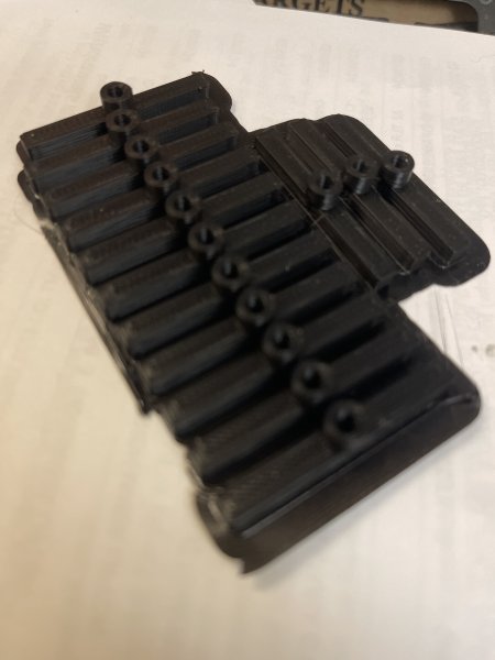

Ron 3D printed a batch of window slider thingies and offered the extras up to whoever needed them....... wouldn't even accept shipping

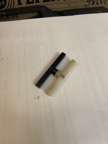

? What do they look like?
Mine are black. Dimensionally the same within a few thou. Use the 0.125 pin same as the original as seen in the picture. See the crack in the original? Thats where the stress is. It’s an interference fit for the pin. Same depth so they mate properly.
