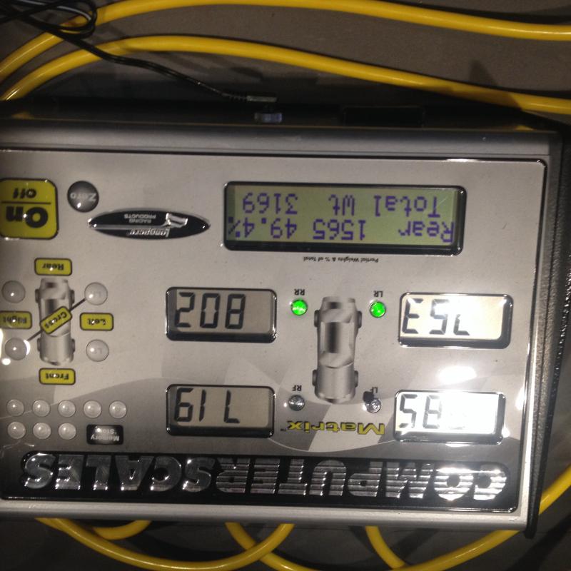

corner balance.jpg Jush had my car cornerbalanced sorry its upside down.
Canyon...tell us more about the "corner balance" ....
Thanks, mike
Mike I'll see if I can shed some light on this. You can load the tires differently from left to right. If you add load to the right rear it will also add load to the left front. As a general rule lower power will usually like slightly more weight on the right rear. This can be accomplished by preloading the ladder bar, 4 link, or Cal Track. That being said you have to be careful not to add to much preload or you'll end up with excess weight on the left front. Scaling gives you an idea of your starting point. The bottom line is how the car goes down the track. Beware of preloading by using the torsion bars. You can preload the left front bar it will add load to the right rear. That is until the front wheels are off the ground. Now you have lost any preload you added. Can get very scary on a car that leaves hard with the wheels up. Don't ask how I know. Trouble is most cars are drivers side heavy. So when you get the rears even the left front is heavy.Take Canyons car above. I'm assuming this is with drivers weight.
LF 885 RF 719 front 1604
LR 753 RR 802 rear 1555
right side 1521
left side 1638
cross weight 1472/1687 46.6%
My bet is it probably has a little more on the right rear than it needs especially at his ET and having large tires. I would take 30lbs of load out of the right rear to start. Now we should have
LF 855 RF 749
LR 783 RR 772
right side 1521
left side 1638
Cross weight 1532/1627 48.4%
Still not perfect but much closer. This can also be done at the track a little at a time but it may hook nice then be a handful if you're trying to tighten it up at the stripe. When I built my car every effort was made to place anything I could on the right side to offset driver weight. here's what mine looked like. It still needed a little tweak. As I stated before we used the torsion bar to set the preload. After it started picking up the wheels it would go right. This required zeroing the torsion bar and adding preload with the ladder bar instead. I haven't scaled it since but my bet is that it's still pretty close.
LF 926 RF 878
LR 760 RR 779
Front 1804 53.9%
Rear 1539 46.1%
right side 1657
left side 1686
Cross 1638/1705 49%
Total 3343 lbs w/me full fuel
