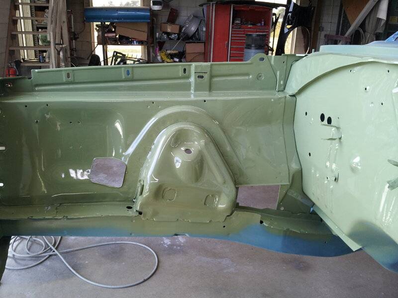

The roof of the '69 Coronet 500 had some surface rust. Stripped the roof to bare metal, treated with the acid, went back over it with scotch-brite pad to remove the white powder residue like GrabberGreenDream posted. I even hit it with a coat of etching primer before coating with DP-40 2K Epoxy primer/surfacer. That was about 20 years ago, and no sign of rust. Someday I hope to put some paint on it (maybe this summer?)
