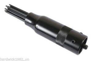

A couple of guys here used a special wire strand tool - basically lots of sticks of stiff wire beating down on the material to be removed....I can't remember what it's called, but it would be for the hard type of under-sealant found under the floor pan etc.
Maybe @Ghostrider 67 or @conv67bdere could chime in with the tool name and picture... :thumbsup:
Needle scaler?
These are only for hard sealers...
Needle scaler?

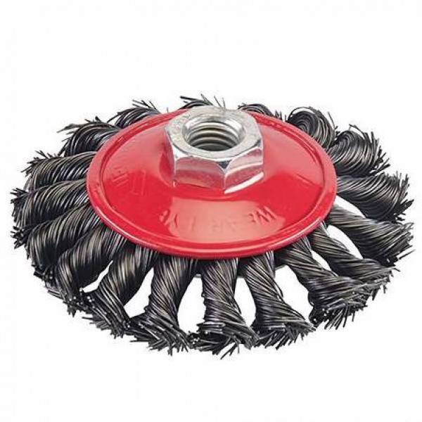

The only problem I saw with using needle scalers, wire brushes and such is that Ziebart has an almost rubber-like consistency. When I tried removing it, my wire brush kept getting "clogged". I found that diesel cut the substance because it's petroleum based and the smell wasn't as harsh as mineral spirits. As others have stated, soaking it in the diesel overnight helped a lot. Just my opinion from a prior BAD experience with Ziebart.
Yep...needled scalers are only for hardened sealants.

Yes, that stuff is gooey. Scraping is the way, or, cutting it with a solvent/ petroleum product. The Needle scaler IS only for dry under coatings.
