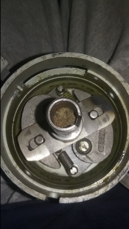

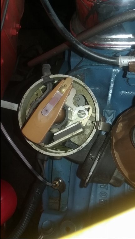

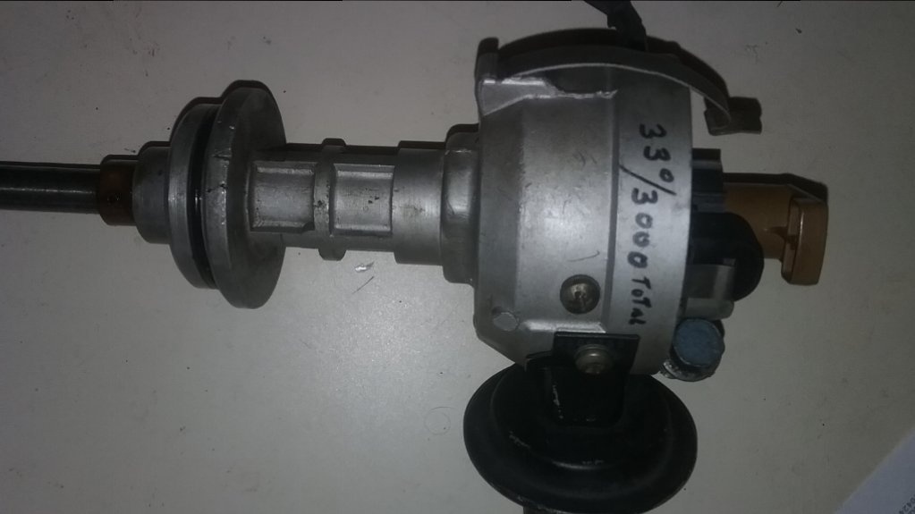

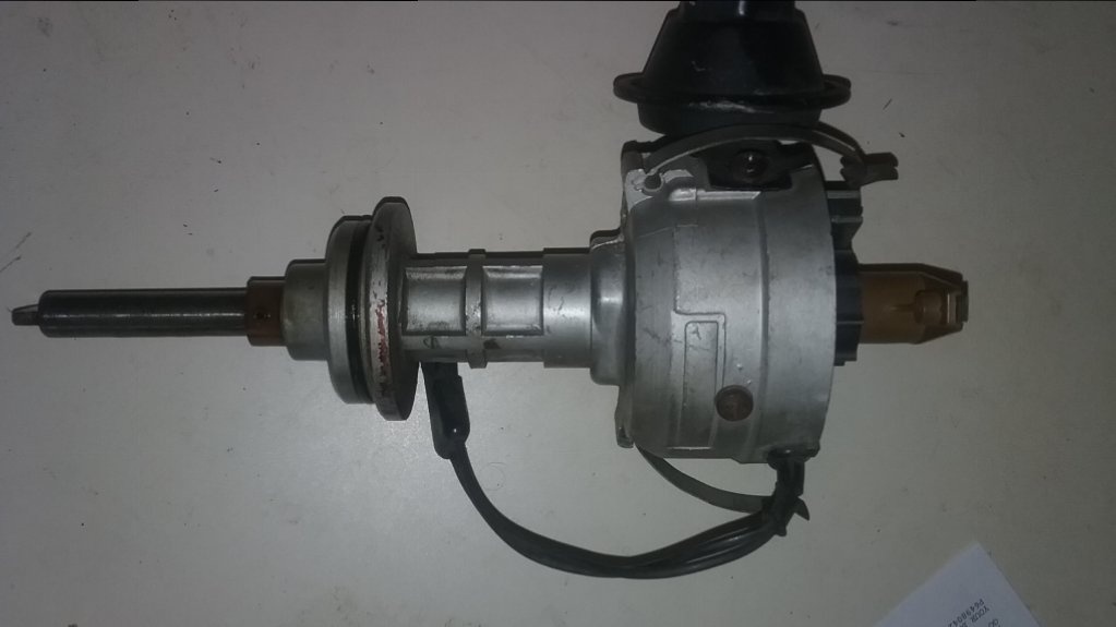

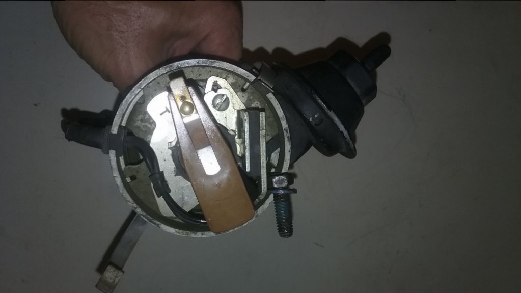

Can anyone ID this distributor? Can't find any markings. I read how to adjust mechanical advance on a MP/Mallory distributor but not sure if this is one. If not, how would I go about lower mechanical advance? Thanks
I'm not sure exactly which one you have, but it's not the newer adjustable style...you'd have to perform the old weld-and-file surgery--best bet is to get you one of these...http://www.manciniracing.com/fbomodilipl.html
Since you already have it opened up, not much more work to use the limiter plate....plus much cheaper than a whole new distributor.
