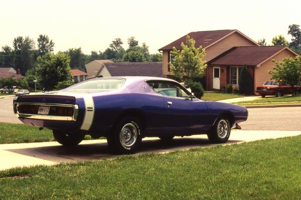

Hey everybody! I know I'm pretty quiet around here, but I'm in need of some assistance. I've got a 1971 Dodge Charger SE that's about to get new wheels and tires. I'm not really sure what I want yet though. I'm thinking some Magnum 500's from Wheel Vintiques in a 15X10 for the rear with a 275/60R15 and a 15X7 or 15X8 in the front. I'm not really sure what size I want to run up front, maybe a 225/60R15. That's where you guys come in. I want a lot of rubber out back with tires up front that give it a mean appearance. As for tires....I'm leaning towards BF Goodrich Radial T/As Let me know what you guys think!

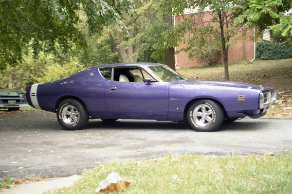

vbpgimage.php

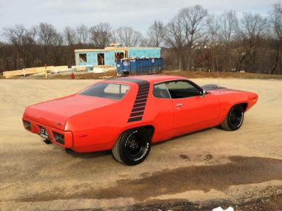

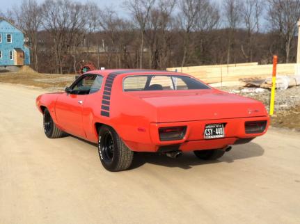

15x8 rear/15x7 front powdercoated police wheels
275 60 15 rear
245 60 15 front
Nice pic! You've got me rethinking the 15X10....besides, the tires that I want have a maximum recommended wheel width of 9.5" and by going 15X8 in the rear will save me about $200.

Many of us have gone through this, so good question. First thing is what will fit? Second is how much rake can you live with? Actually first is make sure you know how to calculate tire height.
i.e. 275/60/15 tire height is 275mm x .60 x 2 / 25.4mm/inch + 15 inches = 28"
215/60/15 = 25.15"
That's a lot of rake man! I think you actually want either 215/70/15 which are 26.8" or 245/60/15 which are 26.6" or 235/60/15 which are 26.0" tall.
As for the rears, I recommend either 255/60/15 which are 27.0" tall on an 8" rim or 275/60/15 on an 8" or 8.5" rim. 10" wheel for 275's is way too wide. Usually 295/50/15 are on 10", but remember that the shorter the sidewall the wider wheel you can fit on the tire. 275/60/15 has a pretty tall sidewall and most tire shops could not get one of those to fit a wheel wider than 9". If you get 8" or 8.5" though it gives you more flexibility to downsize to 255's later if you choose to.

I dont think you need to go bigger than 15x8. 275 60 15 will def fit and they will fill out the wheel well nice.
I'd look at going a little wider than 215 in the front. I was previously running 215 60 15s on my car before the 245 60 15s pictured, and i did not think they were adequate in both appearance and performace. I'd look at going to at least 225s if not 235s or 245s up front. My car rides so much better with the 245s compared to the 215s up front. Just my opinion but its coming from someone who was in a pretty similar scenario as you.

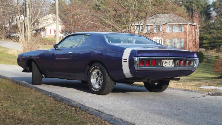

Hey do you have a side view of your car so we can see the rake and how the wheels fill things up?
Oh and don't get hung up on the whole 60 series vs 70 series tire thing. It's all mathematically related and doesn't mean anything without using the tread width first number to calculate.

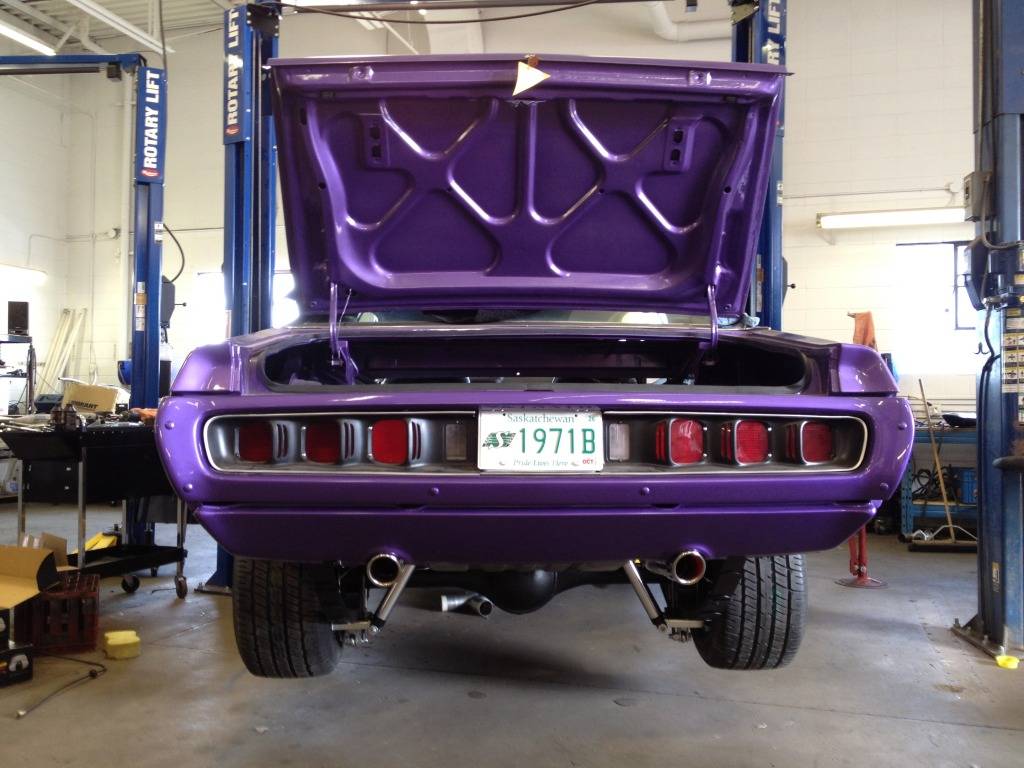

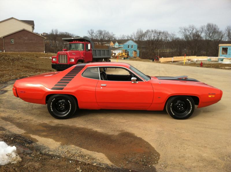

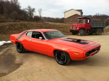

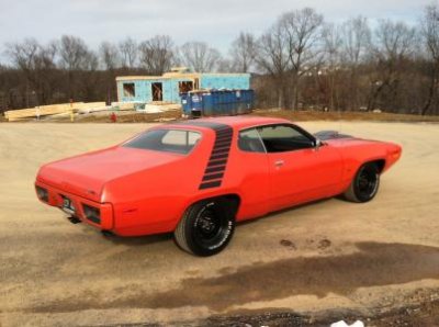

side view and rear
Yeah...I'm not sure how I came up with 215/60R15? That may have been a typo lol I want it to have enough rake to look mean, but not be too ill handling.
15x10 with 5" BS & 15x7 with 4.25 BS. 295/50R15 & 235/60R15 Mickey Thompson
I like my 17x9 better 295/45R17 Mickey T
Looks killer!
I agree, on your car those 17x9's look better. But on the other guys orange red car the 15s look better to me. By the way, I am also running MT sportsman S/T's on my car. I see the 17s are MT ET streets. How do the two compare in the snow and rain?

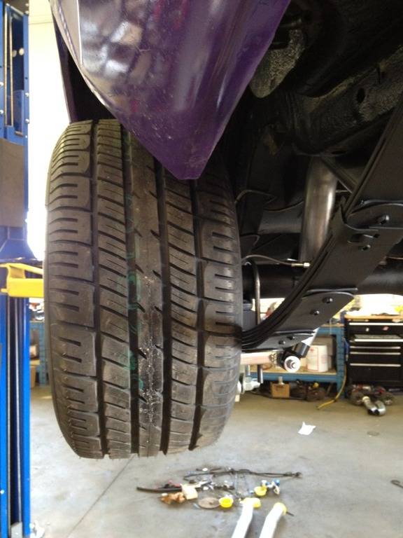

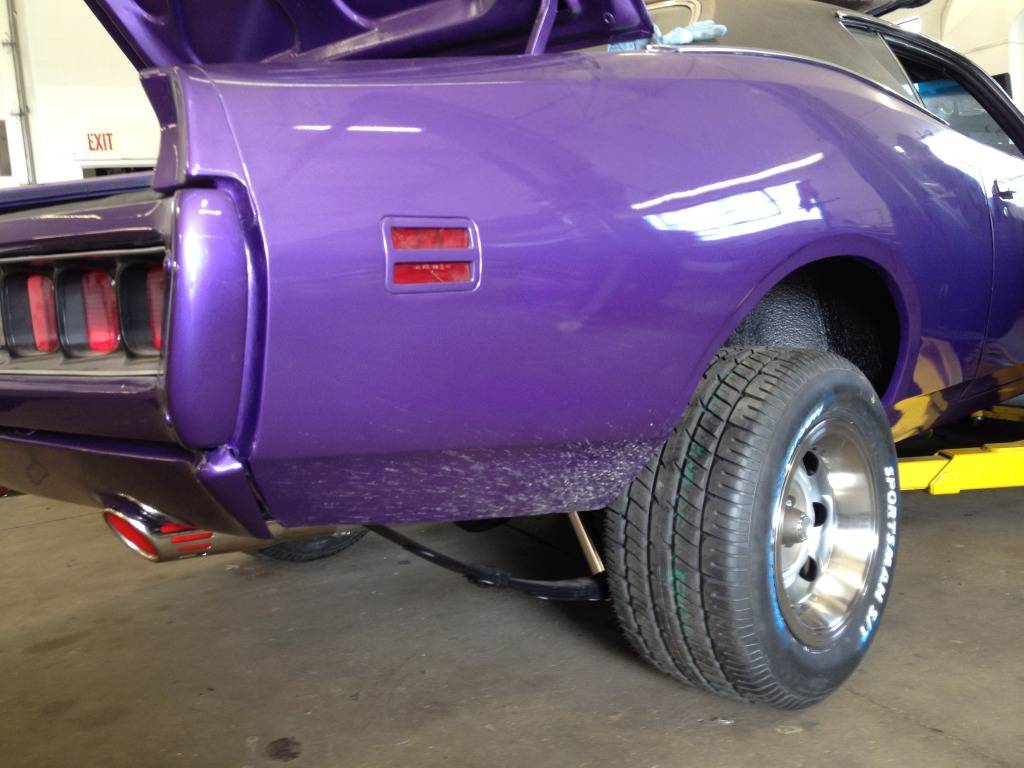

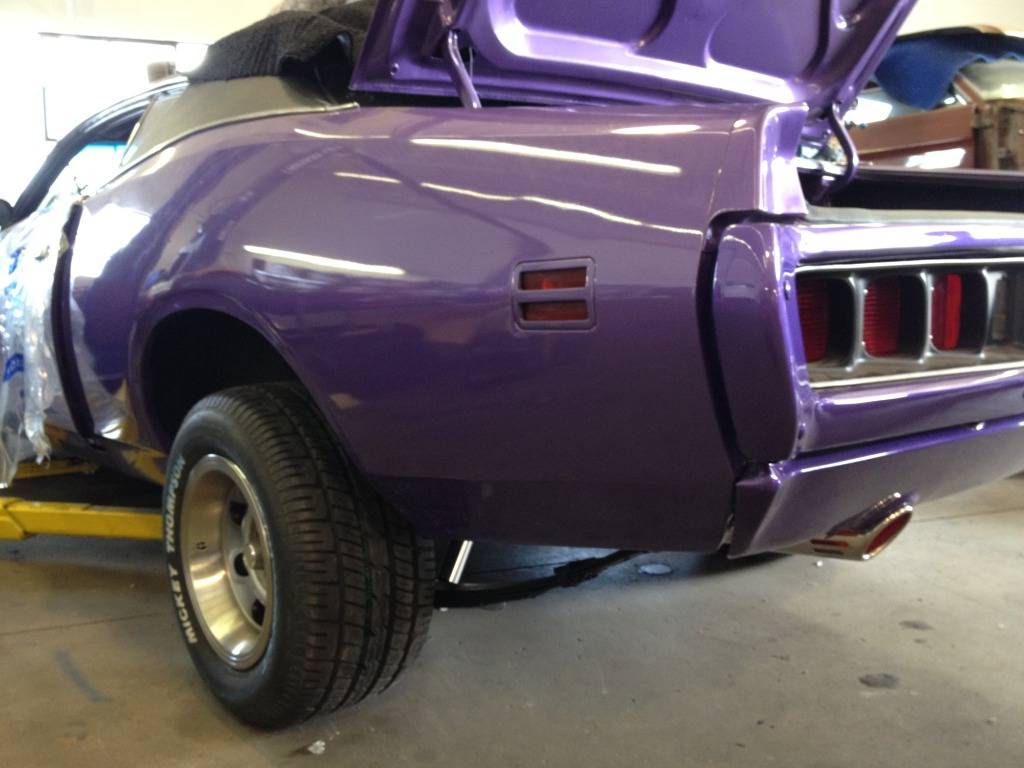

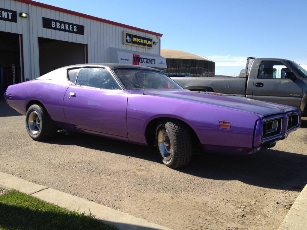

phpAnWmlWPM.jpg15x8 rear with 275/60, 15x7 front with 255/60phpK9ikvTAM.jpg
