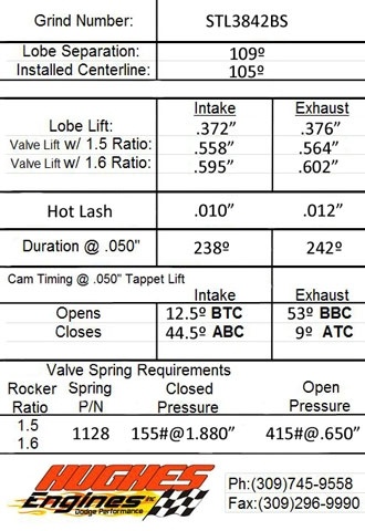

Anyone running Hughes STL-3842 cam???

I did a search but came up empty. Im just curious if anyone is running this cam and if so can you post a video of it running. Also what are your thoughts, pros/cons?
I have the Comp XE275HL & just not sold on it yet...

Just looking at the spec cards I would say the Comp cams would have a little more torque. 110 vs 109 centerline and a little less duration. I would think that would be the hot ticket with a manual tranny.

you cant look at the cam spec the same for a hyd vs solid, take the valve lash out of the solid & the .050 #s would be very close on the 2 cams you are asking about, also a hydro specs are at .006 for the advertised duration, most solids are at .020 lift, I vote for the solid.
A solid lifter cam should be about 10*'s larger than a similar Hyd. cam in order to be about the same size cam.

to check PV clearance you will need the cam you are using, with the small cam like that Huges solid, it should have plenty, BUT it still needs to be checked.
I guess my thought process was to have a better idea of what clearances I have using the 525/525 cam and a solid lifter; strictly for measuring purposes. I would hate to buy a cam and not have enough clearance and have to send the piston out to get cut or buy a different cam.

Yes that would give you a ballpark!!!
The other cam hughes recommended if i wanted hydraulic was the 3236
