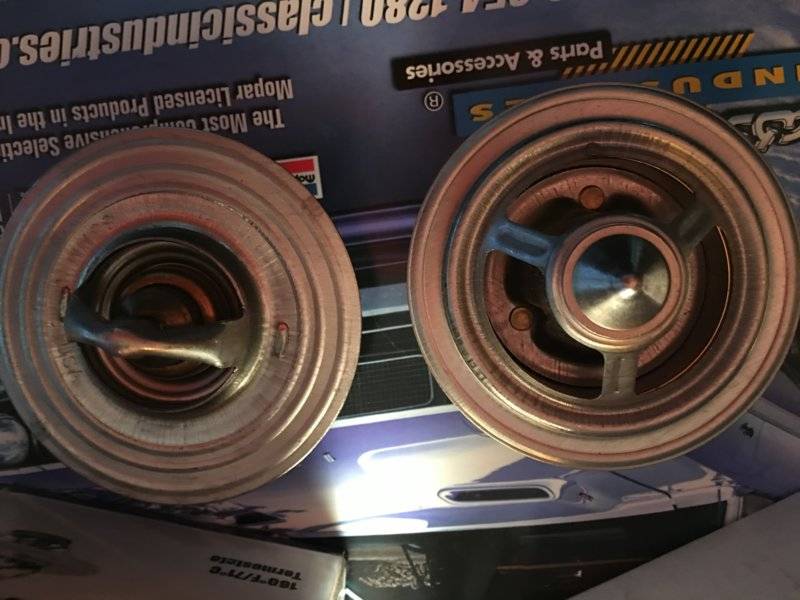

Can you expand on the great differences? How do you know you didn’t have a bad or malfunctioning t-stat when you started? Thanks
My Charger used to run hot at highway speeds. Clean water jacket, new 26" radiator, water pump, spring in lower hose. I must have had 8 different thermostats. One day i was disassembling an old 340 intake. Had a brass thermostat, factory part # on it. It's a 67 factory thermostat. Not a "high flow", just what the 67 parts book calls for. It has a 33% bigger opening at 1 7/16" that the Stant or parts store thermostats, which are around 1". I put it in the Charger, high speed cooling cured. The one I linked in my earlier post has the same opening.
The aftermarket thermostats for our cars have been too small for 52 years.

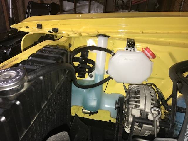

Carlisle trip went off without a hitch. It did rise to about 3/4 gauge reading while I was sitting in hot traffic waiting to get into the grounds. Slepr1 and other's, thank you! I did add the water-wetter. The only other thing I did was add an overflow container. I got a universal one from O'Reilly's for $9, see pic.
I guess Ma Mopar knew what she was doing with my 19" radiator, 318 car.
