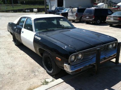

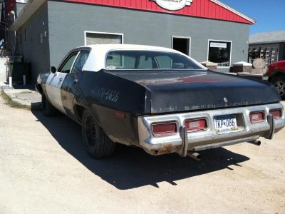

so heres the rusty cop car. the story behind it is that it wasnt a production cop car. a police station in maryland bought it from the factory and had it painted. the lights were removed and the siren and it was sold to my friends friend then. then he bought it. then i bought it. I agree with you both. I dont want to spend 200 on a pan so im trying to find out what will fit. i was thinking of doing msd ignition when said and done because i really hate how they used a ballast resistor on these cars. i have 2 spares in my glove box. This car is my winter car as sad as that is to say, but 500lbs of kitty litter, snowtires, and icemelt makes the winter here in minnesnowta not seem so cold. body work is the spendy part. i plan on doing the prepwork and welding on all new fenders getting a new rear bumper and rockerpannels eventually. for now it stays as it is. the ladies love it and the wife gets jealous.:argue: My friends in the lawenforcement program at school wish they could use it for the test and i just enjoy driving it.
