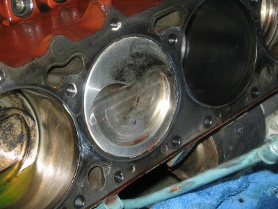

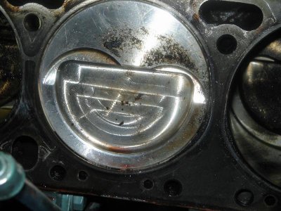

Nope. There's your problem. A 36cc dish is removing any quench you have. That's why you're rattling. Iron heads and 9.9:1 and no quench. There's your problem. You're going to have to change pistons before you have a quench motor. Do you have a picture of them?

Well, there's certainly a quench area there.....but what a frikkin huge dish. I figured it up on the united engine calculator and you'd have to be running a pretty thin head gasket to get the numbers you say....but it's certainly possible. Stupid as it sounds.......I think you're grossly undercammed.
Since C/R ratio is figured as swept volume over compressed volume, then you are probanly at around 9.5 to 1. The long stroke increases swept volume alot, so compressed volume has to also be increased. Hence the large piston dish.

Your pistons with the dish look just fine and the dish is a way to correct your compression ratio back to realistic levels with the 4.15" crank. You really should pour the cyl at TDC with a compressed head gasket in place and the chamber of your old head and new head. Get the real number and make adjustments if necessary. I personally would run a compression ratio that is suitable for the gas used, and for 89 R+M/2 that may be 9.0:1. Then pick a cam that has a power band from idle to about 5000 RPM and make up some cylinder pressure that way. As opposed to running too much compression for the gas used and bleeding off cyl pressure with a late intake closing cam. Sure, the big cam will make more top end power but what percentage of your seat time will you spend at 5000+ RPM?
