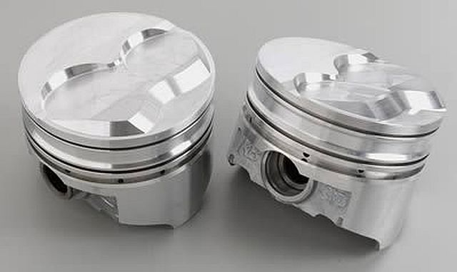

A nice flat dome like that shouldn't give any problems at all.
Wow I like that style dome piston. A nice flat type dome. I would think that works very good. What brand piston is that 67 B body ? Ron
They are sold under the Speed Pro Power Forged name now... They added the anti-scuff coating to the old Forged Aluminum TRW pistons, and they might be lighter too than their predecessor.
They can be purchased in a complete set that is weight matched,,, but I still had some more weight taken off the lightest one of the bunch and the rest made to match..

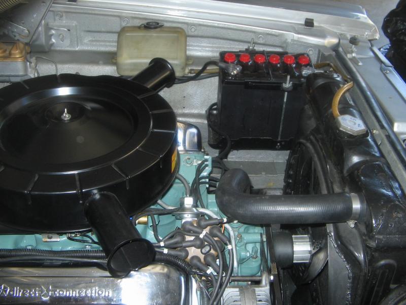

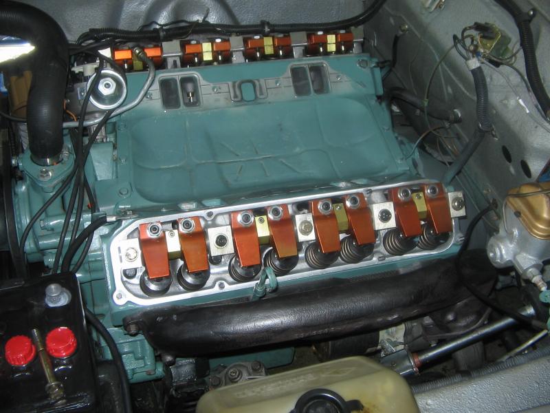

I decided to install the Eddy produced MP452 heads as cast. The math works out to be 8.82:1 static. Should lose some ponies but be able to run almost any available gas. I'm going to try keeping the Racer Brown ssh-25 cam for the time being. After I get a few miles on it, I may change. Just finished today. The silicone at the corners of the intake gasket has to set up overnight, so I'll be starting it in the AM. Hoping that I have accomplished my goal of a "stock" look to the non-Mopar enthusiest.

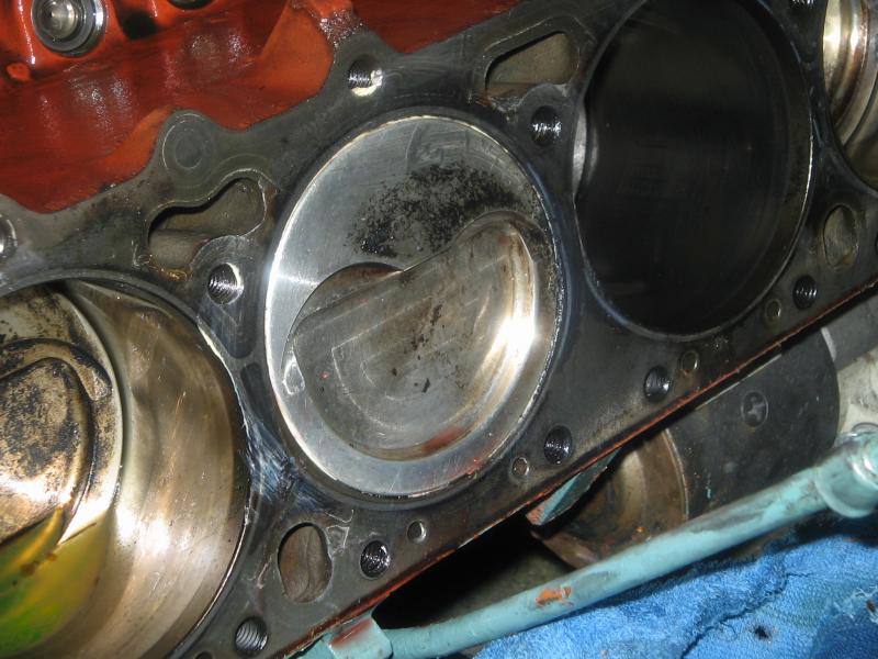

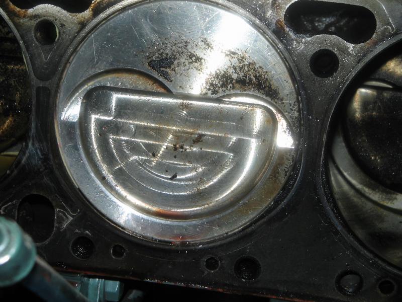

Doright, that is a low compression 440 (judging by the dish in the piston) and the cam you have selected is not a good match in my opinion. If you want to just go down the road for now I'd get a much smaller cam, slap it together and drive it while collecting parts for the killer motor. Or just build it the way you want now if funds permit.
I agree, those pistons are not 1969 type. They look just like the ones came out of my 1977 440. They sit .100" or more below deck. And with the dish, your C/R is probably less than 8 to 1.
Test drove it this AM. No more rattle whatsoever. Dynamic compression ratio appears to be 7.31 with my 140# hot cranking pressure. I'm guessing 89 octane is all I'll ever need. Now I'll play with the distributor as it will probably like a faster advance now.
I dont know looks like an all original 70 block to me? I dont think this engine has ever been apart yet.
