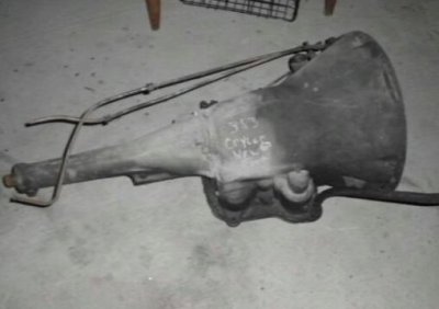

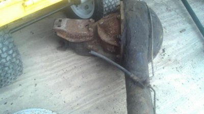

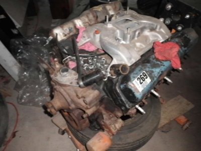

Here we go some pics of the stuff I have got already. 440 with intake.jpgrearend 1.jpg727 tranny-1.jpg

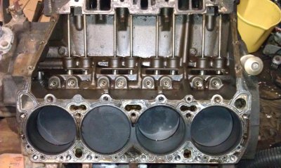

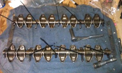

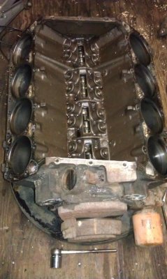

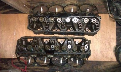

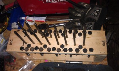

Here are some pics of what I got done tonight getting the engine stripped down as I want to get it all to the machine shop soon. Everything looks pretty good for the most part the wooden thing is a holder I made to hold all of my pushrods and head bolts in their original positions in case I reuse them ENGINE TEARDOWN 1.jpgENGINE TEARDOWN 2.jpgENGINE TEARDOWN 3.jpgENGINE TEARDOWN 4.jpgPUSHRODS HOLDER.jpg

I hope so I will be washing sandblasting resealing and finally repainting the new rear end some time in the next couple weeks. I will also look at the brakes on it to see what needs to be replaced . The rear end also came with the rear sway bar which I am missing as some one removed it and never put it back on as well as some leaf springs. I think I will sand blast and paint all of these as well.

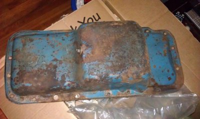

Here we go another piece of the puzzle arrived tonight was sitting on the porch when I got home. It is my 971 oil pan the one I need to use to put my 440 in using schumacher's motor mounts to hook to my sb k frame. I found it on craigslist and thought for sure I was gonna get ripped as he would only ship if I mailed a money order. The price was so much better than the others I found so I took the gamble and it got here quick and for only $50.00 shipped I'm not complaining.971 oil pan.jpg
Nice organization of the parts! Must not be your first Rodeo. Motor looks pretty decent. A standard steering wheel puller will get the dampner off for you. I believe the thread size is 5/16" (course)..

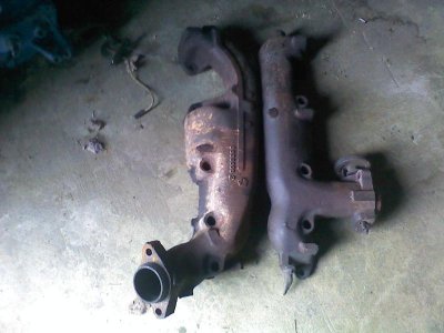

So I'm trying to figure out what I'm gonna do for manifolds I would really like hp manifolds but can't seem to find some for a decent price. The guy who sold me my oil pan has a set of manifolds off he thinks a 76 new yorker and he said he would let them go for 40 for the pair and ship them for about 40 more. Here's a pic of them not sure if they would even work for me though. 76 manifold.jpg
