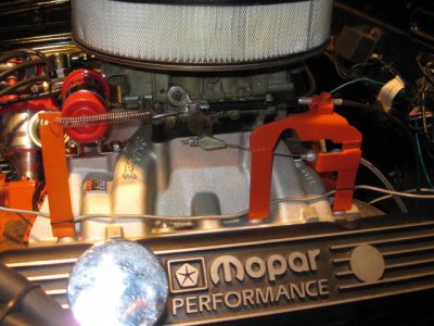

Hello Ron sound like the same exact thing that is going on with my car. I have a 1964 727 cable shift transmission on a 440 65 plymouth I had the same thought that your going through. My lever does the same thing no resistance until half way. I am still looking into this myself but, this is what I did just like 440ronnie67 did put a return spring on it I also have Lockar cables WOT pull the cable tight then slack off 3/8" or so tighten the set screw down and try it see where it shifts. My tranny is very soft shifting but I can feel it and shifts from second to third at about 40 mph may need to make a minor adjustment there to about 35 mph. let us know how you make out. Here is a picture of my home made cable bracket for the carb. car 013.JPG
