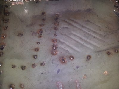

Did a little bit of re-work - had plug welded in the floors, but after seeing the other posts, didn't have nearly enough welds.
So I've gone back and added additional welds to better secure the flooring ( and car )
Driver side:
Passenger side:

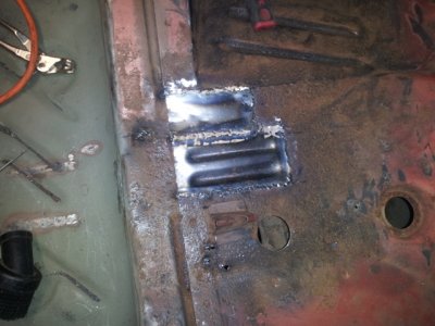

And patched up some Swiss cheese flooring under the back seat ( got more to replace here too )

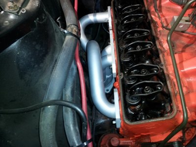

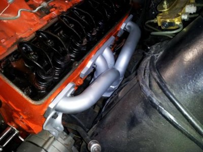

Headers in . . . VHT cearamic painted . . .
Spent most of the day working on the Shoe Box - baked the headers in the oven before painting them ( cool process ). Then cleaning things up.
Boy were these headers made "just" for this car . . . used my shoehorn to get them in ( 1/4" clearance is all I've got )
Here they are . . .
