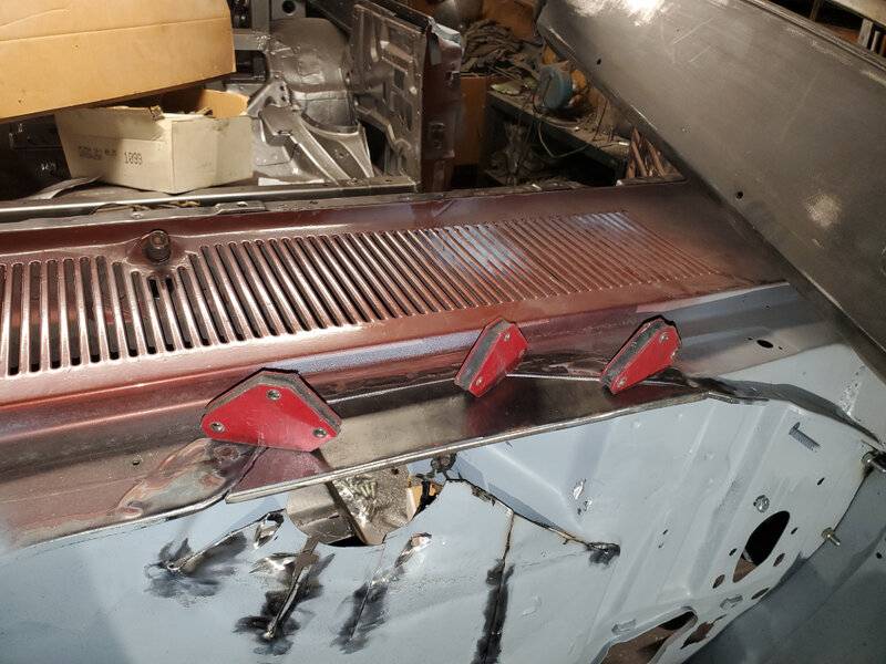

Let the fabrication begin . . . not quite sure how this will go . . . or how it will be done . . . but, time to CUT . . .
Trying to remove the bends and re-use as much of this metal as possible . . .
getting it straighter . . . and getting it moved into position . . .
Then there's this . . . odd looking cutout . . .
So . . . the plan is to fill it in with some new metal . . .
So that it'll look like this . . . I think that this will look a lot better . . . I hope . . .

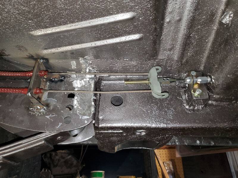

Oh . .. forgot this update . . . although the work needed to be redone to give me more adjustment on the brake . . .
Remember, I've completely modified my E-brake to move it to the center console, so this is all fabricated and it's a LOT of trial and error
( mostly ERROR )
Also, you can probably see on the right of the bolt holes, the grinding where I had to remove the bracket that was originally put up, as it was FAR too close, and I moved it 4-5" to the left ( wish I had done 1" more now ) . . .
I'll have to get that primed and painted . . . I'll get a picture of the new attachments . . .
Trying to figure out how to get this thing done . . . making progress . . .
No more dent in this part of the firewall . . . now to get the rest of the lower part figured out and smooth ! !
Got this just about wrapped up, of course my welding needs a bit of grinding, so I'll be working on that, but it's looking close . . .
going from this . . .
To this . . . Quite the improvement I must admit . . . even matched the step on the side . . .
Not too shabby . . .
And the blend into the step turned out alright too . . .

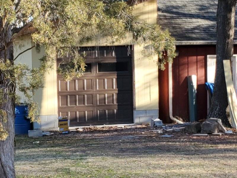

Shop building . . . and also shop moving progress . . .
Got the first part of the shop built . . .
All the stuff from the old shop moved into the new shop . . . including the 67 Belvedere . . .
