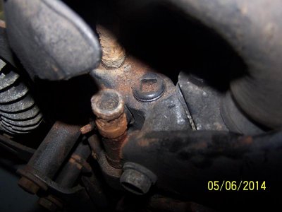

You could remove the 1/2" plug in the water pump housing next to the heater hose tube and get a reducer fitting to accept the new probe. Or get a different style plug with a flat top and drill and tap it for your probe. The sender should be in the water pump housing. Here is a picture of the plug I am referring to. 100_6316.jpg

Just checked....I found that plug....Perfect!!!!! Now to find the reducer.

I have the same plug. Now, mine is the same size as the sensor coming out.

I used an impact to remove that plug.go forward a little bit and then backward.had to do this a few times and it finally came out,the gage I bought came with the adaptor to fit that size hole,mine is a mechanical gage,they are more accurate.

My plug was seized, no amount of heat or mechanical strength could get that dang thing out.
Mine is too......going to try again tomorrow.......if it doesn't come out, I guess I need a water pump housing to make this work....figures......
It may help the get the engine up to operating temp, then use a impact wrench to try and remove the plug. Good Luck!
Thanks....the impact gun was my next thought......
