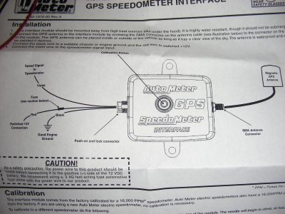

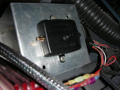

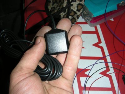

Got a few goodies today, my headlights, maxi fuses and I got the speedo sender the other day. Spent hours cussing under the dash getting the speedo sender installed but it's done just have to try it out now. I found out there's a downside to wiring your car and making your own dash, you can't cuss about the idiots who made it such a pain to work on. The sender install is actually super easy it was just getting the wire routed to where I was happy with it that caused the headaches (not easy working over the steering column). I mounted to the backside of my fuse box bracket in the glove box, you can reach the button and see the speedo if you ever need to calibrate it but since my speedo has never been hooked up it's all plug and play. If you have to calibrate it you just hold the button until the speedo reads 80 mph and your done. Here's a pic of the antenna (strong magnet) which I put in the rear window (15ft of cable), the diagram and the unit itself.DSCN9626.jpgDSCN9628.jpgDSCN9629.jpg

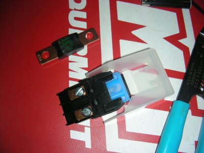

Here's my maxi fuses (still waiting on the fuse holder for the 125 amp fuse). The 120 maxi is for the 100 amp alt which I'll run some 4 gauge wire that is good for 140 amps to get rid of the fusible link (don't like things that have to burn in half to do their job). The other fuse (60 amps) is to do away with the main fuse box feeds fusible link which I'll conveniently put right under the dash where it's easy to get to.DSCN9631.jpg

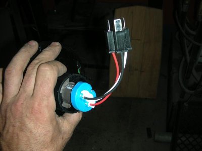

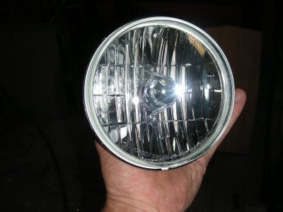

Last, here's the headlights. They are United Pacific brand, look nice and aren't made in China (or USA). I went with regular halogens for 2 main reasons, I like things simple (no ballast) and all my cars have halogens and I'm completely happy with them. These have your standard plugs right on them so you could literally just plug them in although I would highly recommend relay's. The bulbs are standard halogen bulbs. Now I need my solenoid valves to open the headlight doors and I'll have light.DSCN9633.jpgDSCN9632.jpg

Tried the Speedo out today and nothing...........I thought to myself "how in the hell could I screw this up"? Red wire goes to battery, Black to ground, Purple to Speedo signal terminal and you just plug in the antenna???????????????? And then WALLA!!!! it must need a little time to pickup a signal or something but after about an 1/8 mile or so it kicks in and works flawlessly "SWEET". Now to the headlights.
It seems like it should pick up the signal pretty quick, antenna does it for ya GOOD deal! I use the halogen bulbs in my 73, its a illuminating experience! One step at a time and as you say "WALLA!!!!" Cool as it gets and hope it go's smoothhhhh as can be for ya! :)

What a weekend!!!! Lots of cruising in the Charger, cookouts and fireworks. Lack of headlights was getting old and keeping me from taking the Charger places so I tackled that this weekend. The headlights came with plug in's for the old sealed beam terminals but I don't have terminals (rewired the car) so I needed to figure out which wire did what (internet was contradicting on it's info). Surprisingly putting 12V to them didn't help because I couldn't tell the difference between the high & lows and just blinded myself repeatedly. Finally sitting at the bank I reached in the glove box and saw my spare bulb for the Dakota and what do ya know (it uses the same 9007 bulb) so that was pretty easy to get figured out. I was busting my butt to get it done in time to take the kids to a buddies for a cookout and fireworks but ran out of time so I threw all the needed tools in the trunk and said to hell with it. Now I can't come home until I have headlights haha, it only took about 15 minutes in his driveway to finish it up. I'll do a thread on the install once I get the pics and get a drawing of the wiring made but don't expect a Propwash quality how to do. I wanted to have lighting at least equal to my daily drivers but the quad 65 watt halogens really surpass my other cars and light up the road very nicely.
