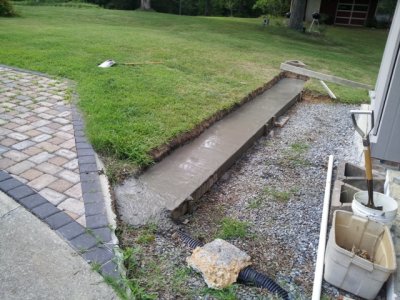

Got the last of the concrete done tonight, as I was a bag short the other night I attempted it.
Oh, great story . . . was at the local home supply store and they had only (2) bags of Portland cement left, and both bags were ripped open . . . so the I asked the sales man if he could put them in the paper bags that I've seen them re-package tore open bags. He said he could but needed an extra set of hands - so I helped. Got both of them bagged up, but nicked my arm on the pallet and was bleeding. Normally the bags of Portland ( 94# bags ) run about $11.00/bag . . .
the salesman grabbed his marker and wrote $1.00 on each bag ! ! !
Couldn't pass that up !
Here's the completed concrete work . . .
This is not structural, so I'm not worried about the double pour that I had to do . . . it's just holding a dirt retaining wall . . . turned out pretty nice !

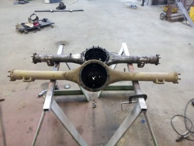

Oh - need to share this picture with you . . . the final result - an original housing and the narrowed housing . . .
You can see the jigs set out for their pictures in the background . . . trying to get all this documented ( 2 very long nights . . . but we got it done )
. . . but the end results of the weekend ( outside from having an absolute blast )
was a total success of the narrowing process . . .

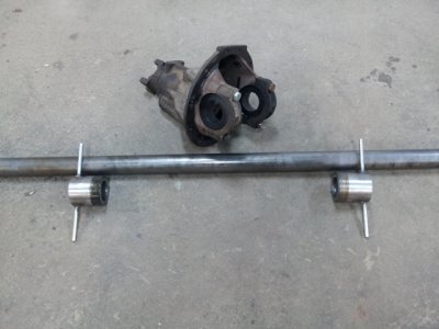

747 Mopar had the "plan", and already had all of the pieces made by the time I was able to get there . . . and his plan worked great.
Here's how the "plan" was suppose to work - here's all the pieces . . .

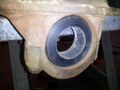

Then we took one of his spare carriers, and the plastic bushing got mounted into it as follows:
The 1 15/16" steel rod was to help ensure that the rod did not "bend" and give us untrue readings.
The metal alignment parts with the handles allowed up to move them and make sure there wasn't undue pressure on the alignment parts.
The plan - measure 27 times,
cut once,
cut the required section out,
use alignment tool to re-align parts,
then weld them back into place.
We'd slide the alignment tools in the end and check the fit - testing for a pretty smooth twist of the tool.

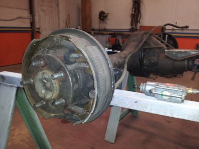

First, we start with the axle . . .and then we strip down the breaks . . .
Drained the differential fluid out - and remove the entire pig assembly

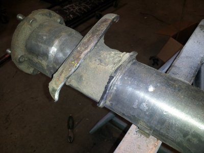

We then found that one of the cuts was going to be under the existing spring perch, so we cut half of it out of the way ( we left half of it to help with mounting the new spring perches later ).

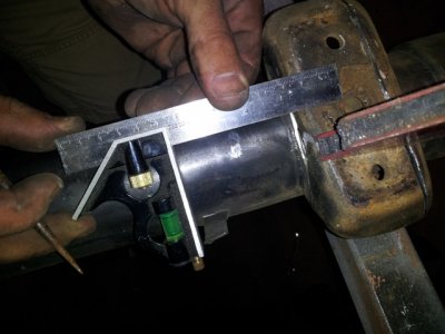

In addition, we placed a piece of angle iron on the axle to draw a straight line on the axle for re-alignment purposes.
The spring relocation moved the springs in 4", but we were only moving the axle in 3".
We measured in 4 inches from the center of the existing perch, and this is where we want to cut the axle housing . . .

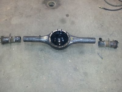

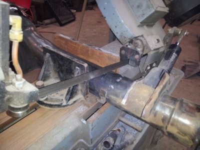

One we had the mark on the housing, it was time to put it in the band saw and cut it . . .

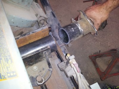

No turning back now - this is only the first cut, we still have another cut to remove the 3" piece that we are narrowing the axle.
The entire axle with both of the first cuts completed . . . set on the floor for display - then we cut the 3" piece off both of the end pieces.

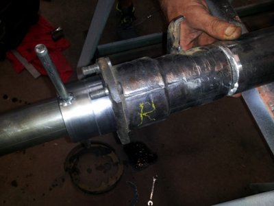

This is where the alignment tool comes into play - the outside pieces are reassembled using the alignment tool and the 1 15/16" steel rod a a guide.

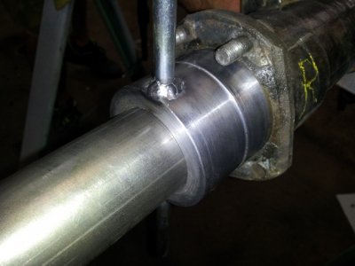

The alignment tool fits into the end of the axle, where the bearing goes, and hold it it the proper orientation - and square to each other.

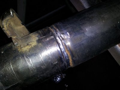

The ends were ground to V-grooves for welding . . .

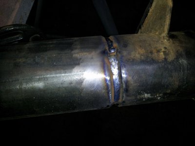

Then we welded up one side ( 747 mig welded this - my turkey dropping welds weren't going to hold - LOL ).
Then the other side got welded the same way - both sides we aligned the marks on the axles to keep them square. ( ok, this one could have been left out )
Then the remaining gaps in the weld were welded up till they were filled, then ground back down to be level . . .
And this is now ready to attach the new spring perch . . .

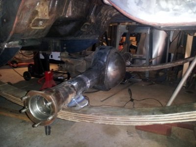

Just got in from the shop after setting the narrowed axle in place to see how it looks . . .
SWEET ! ! !

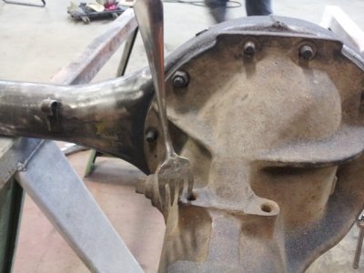

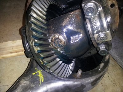

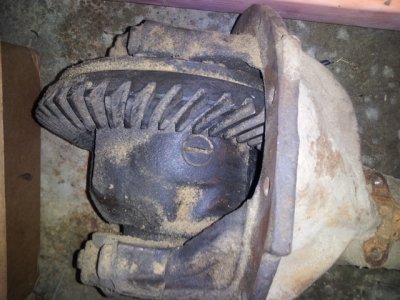

Then a picture of a "proper" carrier . . .
And one of our gremlins . . . this is what we found in the Belvedere carrier - it's been WELDED in place.
But it's not a POSI rear end - so this one is going to be replaced . . .

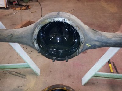

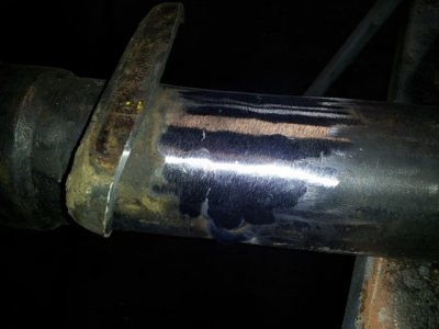

After cleaning up all the dirt and oil on the housing, and actually getting to see metal for the first time in years, we noticed that there were a number of "marks" on the front and back edges of the driver's side housing. We could not figure out "what" was the cause of these marks nor "why" they would be there . . .
Things went great, except for having to stop and think through "where" and "how" we were going to cut the housing - but that turned out to be a pretty much agreed upon decision. So the housing got cut, we had the steel rod positioned in the carrier and the end pieces ( now 3" shorter ) were slid back into place - the passenger side of the housing looked great - then we attempted the driver side - we we're so lucky.
Pictures . . . we we're so focused on the mis-alignment, I forgot to take any pictures of this "error". Sorry !
The driver side of the housing was good on the top and the bottom alignment, however, the front to back alignment was off by at least 1/4". The steel rod was much closer to the front of the housing, then the back of the housing ? ? Which caused us both to scratch our heads . . . we were able to get the housing into the 20 Ton press and get it "mostly" moved back into place, and then used the torch to heat the housing and get it to "move" back into position. We got both sides aligned very well, welded up, fill welded and some initial grinding - all with the alignment right on track. Then we welded the spring perches onto the housing . . . and the alignment was then off by about 1/8" for both sides. So - back to the heat on the housing ( in the right location ) and let it cool naturally, and we got it all back in alignment !
