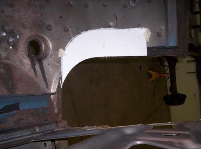

View attachment 186148 I traced around the stock AMD inner fender well for referance.
Then compared the US Car tool piece pretty close I can make it work. I'll roll a step in it so after it's welded up you wont be able to tell it from stock.

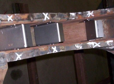

I plan on putting in some extra gussets inside the frame rails for more strength.

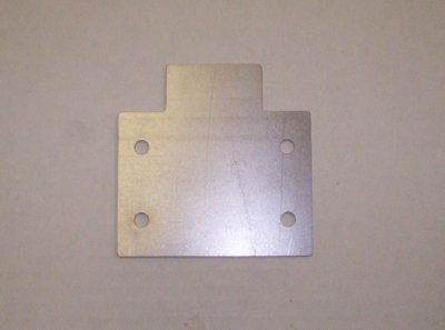

This quick aluminum pattern for size.

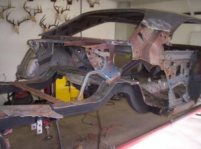

I'll be checking those out! Looks like you have your car on a rotisserie, If so it really should be supported in a couple of places in the middle, also some braces across the door openings. With that much sheet metal gone it WILL sag in the middle. Cool project, I'm following along!
Damn, just checked them out, 66-70, mines a 64
It is off the rotisserie and on a stand I built ( you can see it in the frame rail shot) I have the chassis dimensions from thwe manual and will be checking them before welding anything. I plan on tacking/screwing everything together once to check for fit, then take it apart and start welding back together.

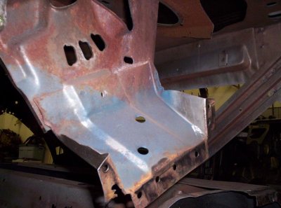

So I got my frame rail gussets made & ready to instal.
This is what they look like in place.

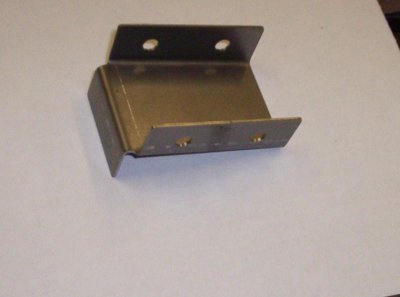

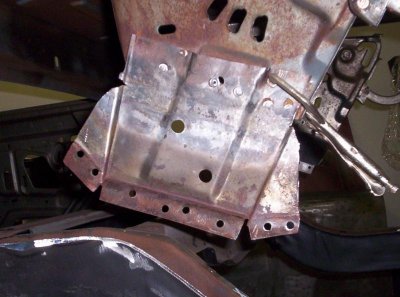

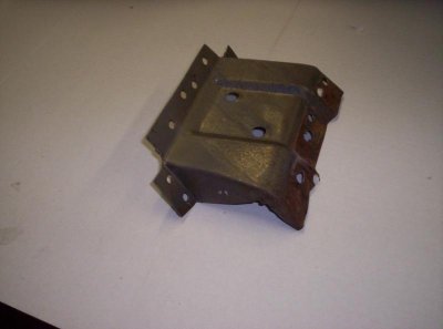

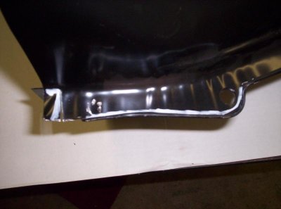

Heres the stock wheelwell trunk brace. I reworked it by heating, straightening, & tweaking with a couple bends.
View attachment 186527I think this will look much better than the US Car tool brackets.

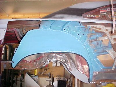

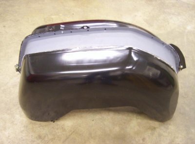

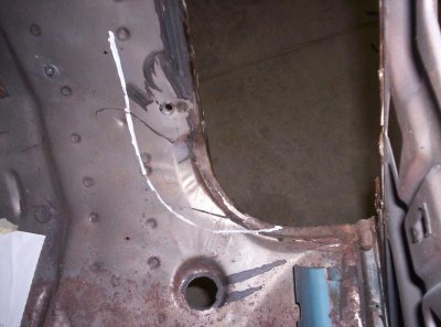

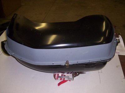

I put the 2 halves of the wheel tub together to check fitment. Had to to some tweaking as AMD makes some pretty sloppy stuff. To much in some spots, not enough in others. White line represents places where metal needs removed to fit correctly.
You'd think they'd now the 3 big holes were used for alignment for spot welding the 2 halves together. So after some trimming I got them to fit pretty well.
I put the splice piece on top to make sure the profile was right, had to make some cuts in the flange to get it right. Nothing drastic but will make it fit better down the road.
I rolled a lip on the slice and screwed it together to mock it up.

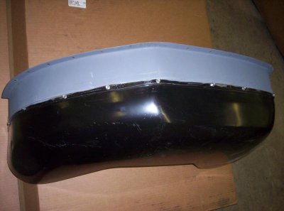

Well after wrestling with the outer tub trying to get a good fit I have come to the conclusion that I will final fit the inner tub after I get the 1/4, trunk ext., & rest of the sheet metal in place. I think I will save myself some grief this way as the spacer piece and inner tub can easily be adjusted to fit the outer tub/trunk floor. I'll post more when I get to that point. My opinion so far is the Car tool kit is a winner. I tend to be a bit on the fussy side on fit up and apperance.

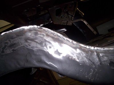

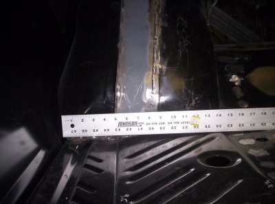

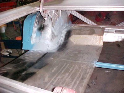

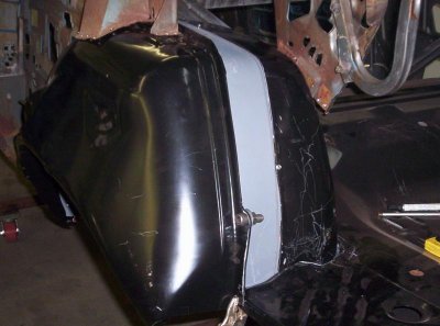

OK so got back to the tubs, I cut clear to the frame rail, removing the lip, then welding it up.
I sheetmetal screwed the 2 pieces together before welding and tried a trial fit and used a few screws for referance holes on the final fit up to the other half. The step I rolled in the extention was .6 for you guys wondering. I then stitch welded the extention in skipping and quenching often. I then placed the half in and spot welded the 2 halves together and then welded all the way around the bottom.

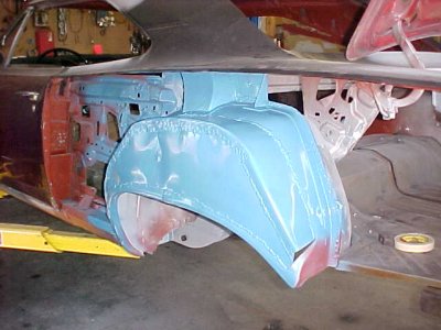

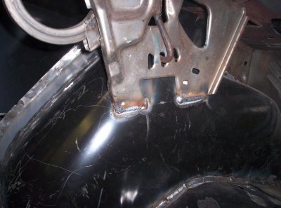

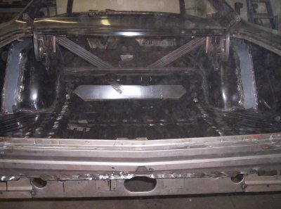

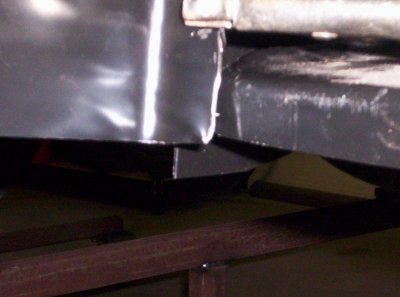

So this will give you a idea of the width. I had flattened out the lower trunk lid bracket to weld back in place, but I could see my brackets were to close together. 39 7/8 as opposed to the 40 3/4 it was originally. So I trimmed the recess in the middle out allowing me to push the brackets out to where they were supposed to be. And it looks pretty good also I think.

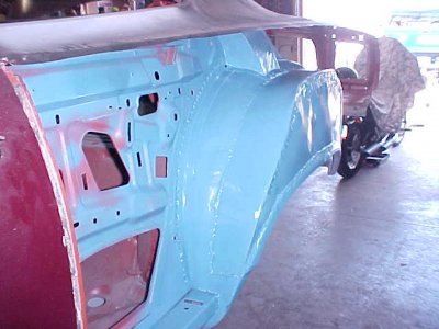

So all in all a good kit. instal was pretty straight forward just take your time and cut a little at a time till you get it where you want in. A little tricky getting the spot welds behind the trunk hinge bracket. Just be patient and take your time.
