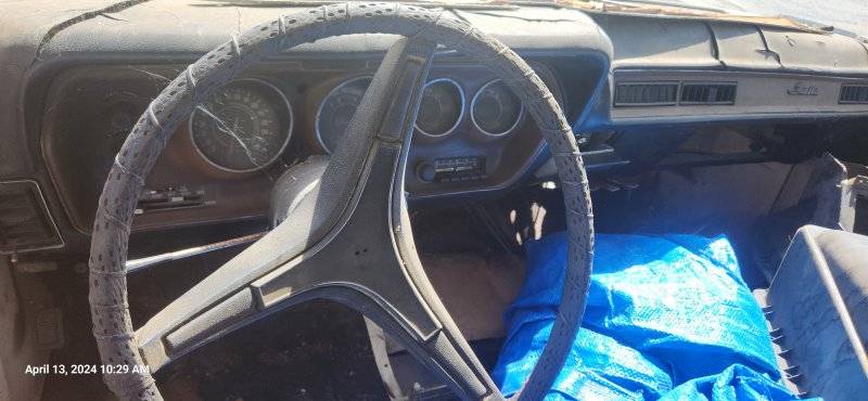

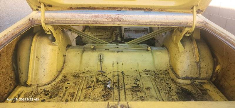

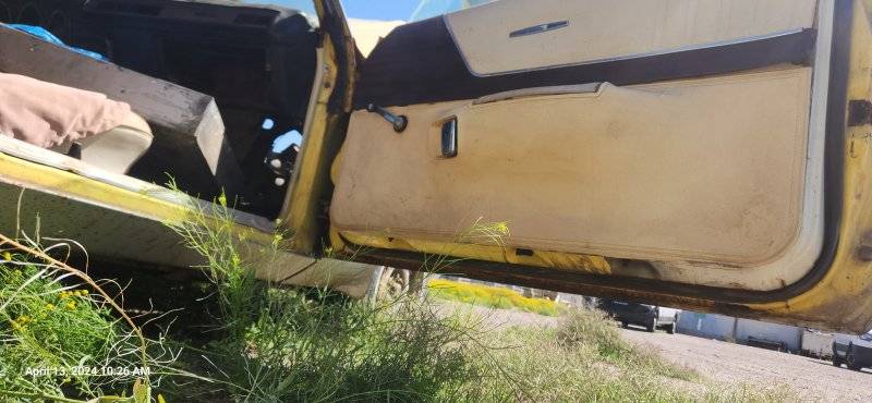

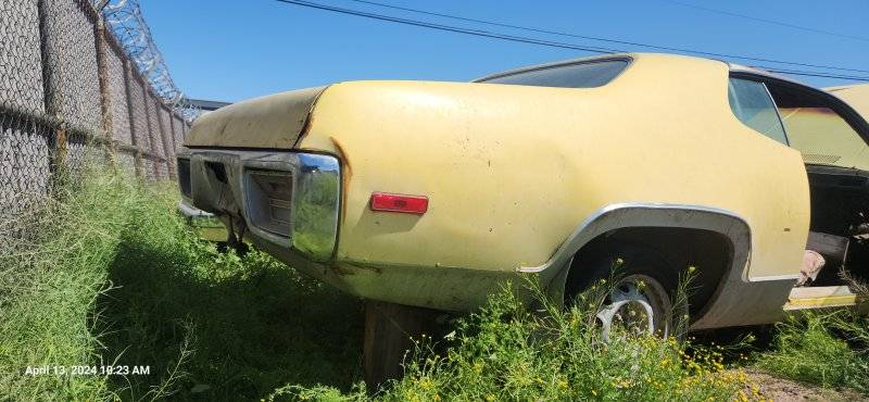

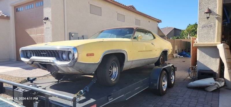

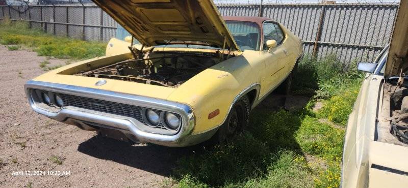

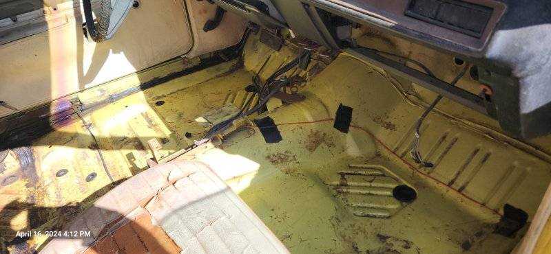

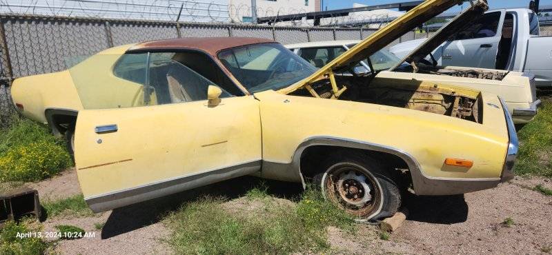

This car was sold new in Phoenix and never left. It is yellow, but not staying yellow. Originally a 400 automatic, console, buckets, AC, and half vinyl top. I have the interior mostly out and the trunk cleaned out. I am not surprised at the condition of the body, there is something to say about desert cars. It is getting dissasembled all the way to rolling shell, first stop will be to Al's unibody, then back home for the install of the full US Car Tool frame kit. Then to to the blaster for strip and epoxy coat. Then back home for suspension and drive train mock up before going in for paint.

That one doesn't look like blasting is necessary.
I would have a real hard time deviating from the original FY1 yellow on that car.
Is that a Satellite Sebring Plus? I love the color separation with the trim and argent silver below.

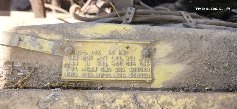

Yes. RP23 is SSP for '72. My first car in '85 was a 318 Honeydew Gold/Silver lower car.

Nice! Rust free, mostly dent free, rallye gauges, console and a big block. Great start!

Nice car to start with!! I had a green, green top and green interior '72 Satellite I sold that someone painted yellow and at first glance of the first photo I saw the body and thought it was it... Overall clean car but had rust where the door hinges mount.. The rest was solid like yours. Don't know where it ended up as it was resold again. Enjoy the build sounds like a good one!
