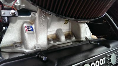

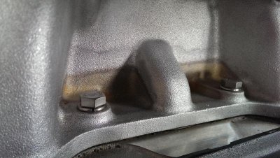

So... Like a dummy I left my house last week to go grab lunch with nice blue skies and the RR was left in the driveway with the hood up when the skies opened up and it poured rain... I didn't notice until it was too late but some water pooled in the intake and after the heat from the engine dissipated the water I'm stuck with these ugly stains on my intake... Any suggestions at all to get this out or mask it? I tried a de-greaser and brake cleaner both didn't help at all.

It looks to me like "HEAT" stains...am I correct in assuming that water had "pooled" and when you started it up, it boiled off?
It looks to me like someone took a heat torch and tempered the aluminum, so Im thinking it was "run" with the water on it.
Use a small brush like one of those that are a bit bigger than a tooth brush or even one of these can be used too.
Mothers mag wheel polish, brush it on real good let it sit for a few minutes then buff it off. Polish to the shine you want.
Essentially that's what happened... I didn't notice the pooling so when I ran the car the intake temp just baked the water in.... Not cool!

So, Being PORUS, and aluminum I'm assuming the impurities in the water were absorbed into the heated Aluminum, boiled off and caused the "staining"
Honestly?
If worse comes to worse, replace the manifold BUT, I'd suggest shipping it to LeAnn at Phoenix Specialty Coatings in Kentucky (God's Country) and having it Clear Powder Coated...
That is what I would do.
pull it and use a spot sand blaster with aluminum oxide.ive done it many times with old as cast wheels.brings em right back to new.
Might try something like CLR and a toothbrush. I would assume the stain is impurities and minerals left from the evaporation. C calcium L lime R rust. Used it on other parts before. Never aluminum. Might try a small spot first.
I send my intakes to LeAnna. I have them power coated in "Alien Silver" which has a fresh new aluminum intake look to it. Go to the web site and look or ask for a picture of what the color looks like.
