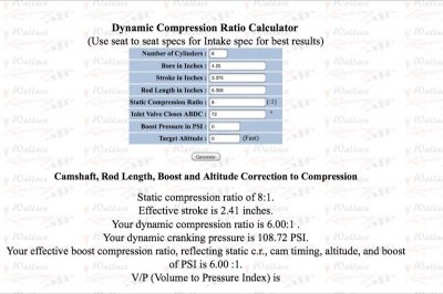

I entered your info into Wallace racing's calculator and it looks like your 383 is about 8:1. That 509 cam is KILLING your cylinder pressure. If I had your budget, I'd do this:
Step 1: Keep the 383 and just swap out that cam and lifters for some thing more reasonable. COST: $300 or so.
Step 2: Buy that 400 from your buddy. COST: 18 beers
Step 3: Have the 400 assessed by a machine shop. COST: free to $100
Step 4: if the block and crank look good, save some cash to properly build the 400 as your 'final' engine for your car. Then put a 383 pie tin on it. If you want to go nuts, build a 451 stroker, you've already saved so much cash on the block, it makes more sense than building a 440. COST: ???
