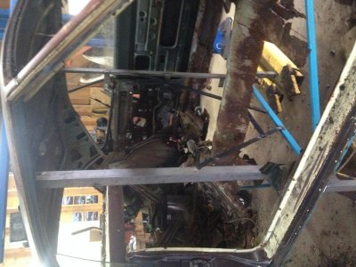

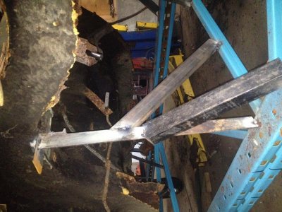

Definatly a huge project, I got my inspiration to even try it from your thread Don! It's on the jig now with quarters gone next step to start replacing the rails front and rear just waiting in the fronts I ordered and inner and outer rockers spring perches and crossmemebers. Once it's structurally sound I'll either "massage" the inner fenders as they are a little twisted in front or replace them haven't decided yet, then go to swapping the rear part of the inner roof structure and package shelf from my charger shell over. Helps having a father in law that is a certified auto body and got his ticket in the 70s working on these! Thanks again guys I'll need the support!

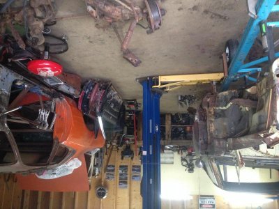

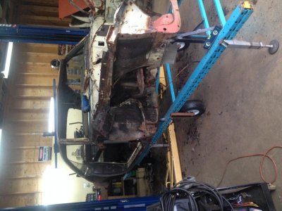

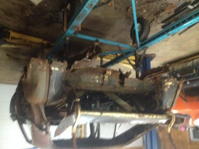

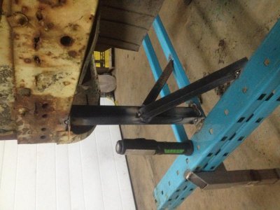

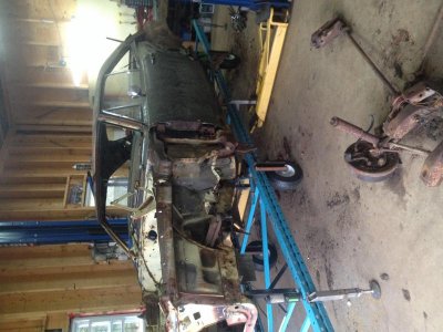

here are a few pics all jigged up, second pic you can see my 73 waiting to be finished. still dont know why these pics up load all flipped around? IMG_2084.jpgIMG_2085.jpgIMG_2086.jpgIMG_2087.jpgIMG_2088.jpgIMG_2089.jpgIMG_2090.jpg
You are absolutely insane. Good luck to you sir!
:beerchug:
Wow!! I think you've just redefined the word 'dedication' for all of us. Good luck with the project and keep us posted on progress. :headbang:

daytona kid, sorry about the pics lol. I have been taking them
with my iPhone and uploading to my computer, they are right side up on the computer but when I upload them to the site they flip all different ways. Any ideas? :confused:

It may have something to do with the way you are holding the phone .. Mine does that if I hold it sideways or upside down.

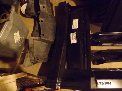

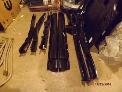

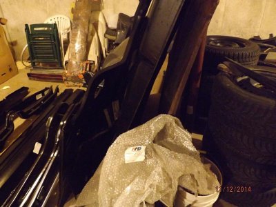

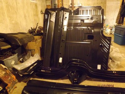

Christmas came early, all new floors front and rear rear frame rails, torsion crossmember, rear crossmember, inner and outer rockers and rear leaf spring perches. everything I need to get started as soon as the 73 is gone!
Good luck Pat! The jig you have will keep it in line and maybe the wife will need to keep you in line if you go to far with parts (mine trys lol) but i bet you'll get it done and it will be a cool ride and a project you'll remember for years to come!
