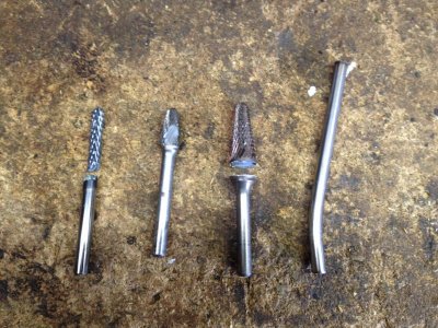

I had to enlarge a couple of holes in my Road Runner radiator support, so I pulled out my trust grinder. I had purchased some new grinding bits from vendors at Carlisle, so I figured I would give them a try.
I'm lucky I didn't get injured...:angryfire:
The first one I tried is on the far right - it was an extended shank bit. When I turned it on it almost immediately bent (I cut the end off after it bent, so you can't see the head in this picture). When something like that bends doing 30,000 RMP, it is NOT GOOD! So then I tried the others - each one broke - I guess they are too brittle. Now before anyone says I wasn't using them right, I have used LOTS of bits and NEVER had these problems.
It is one things if you have a crap tool, but these bits could really hurt someone. Grrrrr....
i have used and misused those types of bits over 30 years and never broke one........ unbelievable
or worse........ could have hurt the car :thumbsup:

No brand name - just bought out of bins from a tool vendor at Carlisle. Proof that it is buyer beware!

Isn't there a grease to put on the bits to keep them from suddenly digging into the metal? You have to be very careful about the pressure you apply to a die grinder. .............................MO
I have never used any grease, but I have ported heads and ground lots of stuff for years and never had this happen. Then I go and buy these bits and they fall apart. When I went back to one of my old bits, everything worked fine, so I do think it was the bits themselves...
