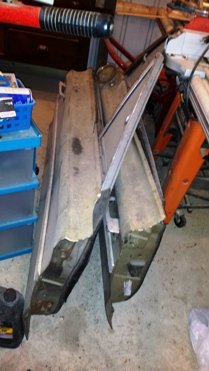

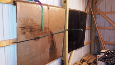

The car as it sits now is in rough shape, although I do have a ton of parts that my father-in-law collected over the years which includes rust free front fenders, 2 hoods, deck lid, extra trim, some interior parts, and bumpers.

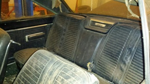

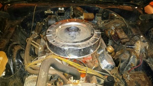

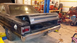

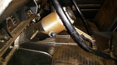

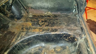

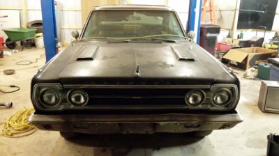

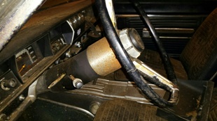

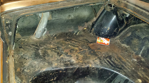

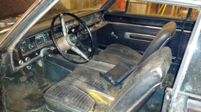

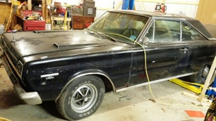

Updated photos
Thought I would send some up to date photos of what condition the car currently is in as well as some of the extra parts that I do have for it.

Looks like a great car to redo. Have you checked under the rear seat bottom for a broadcast sheet. Good luck.

Looks like good raw material. That green color is that same as my first GTX. I don't think that steering column and wheel is original to the car, maybe from a C body?
Yea i seen those tilt-a scope cloumns on C bodies never A B bodie
Judging by the size of the rear tires it looks like it's been back halved? More pics and details would help like what type of rear suspension it has....what's been done to the trans, stall speed etc. What has been done to the engine.....like cam, head work, what heads, crank, rods, pistons, comp ratio and the list goes on. The more info, the better. Same for the trailer. Imo, a 29 is much better than say a 24 and pics of it would help too. Brand, any cabinets inside, winch, etc....
Looks like a very nice GTX! You got the car AND the girl! Depending on your experience, you might want to strip the car down and have someone media blast and prime it,
and then take it to Auto Metal Direct down in Georgia and let them put in the sheet metal and rails correctly. By letting them do the work, you'll know it's all been done right
and you won't get tired of working on the project. You're Father-in-law was really thinking when he accumulated the extra parts! after the car is done it will be beautiful!
