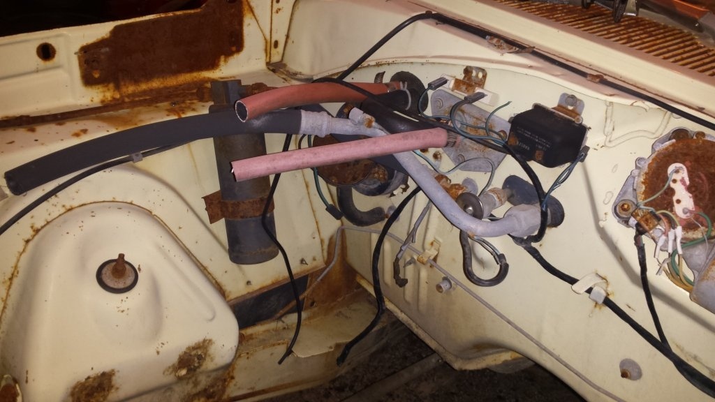

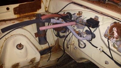

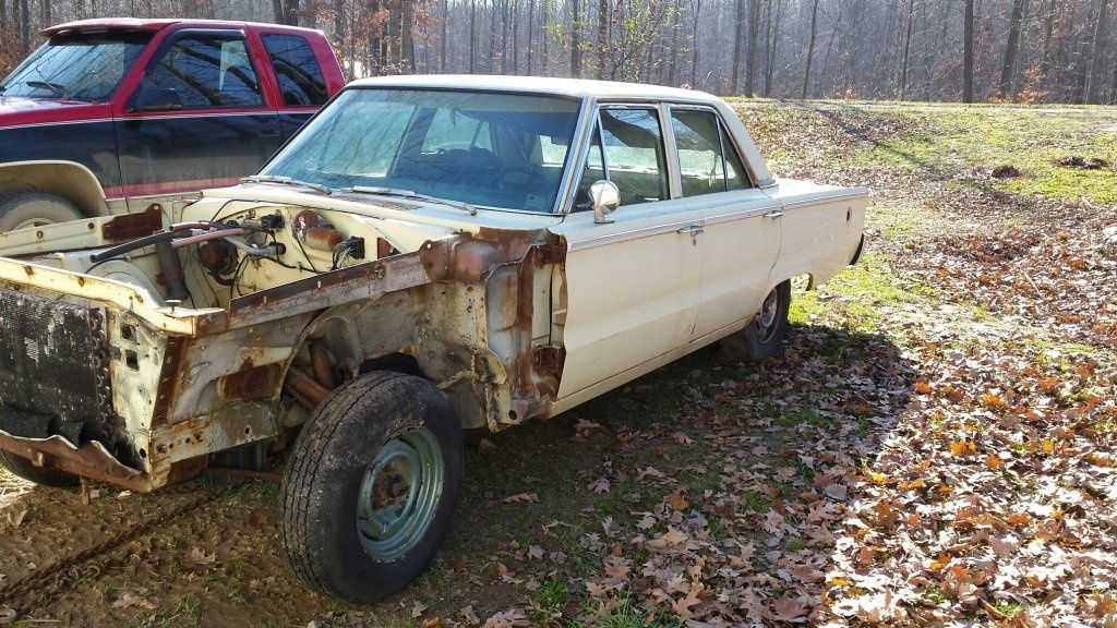

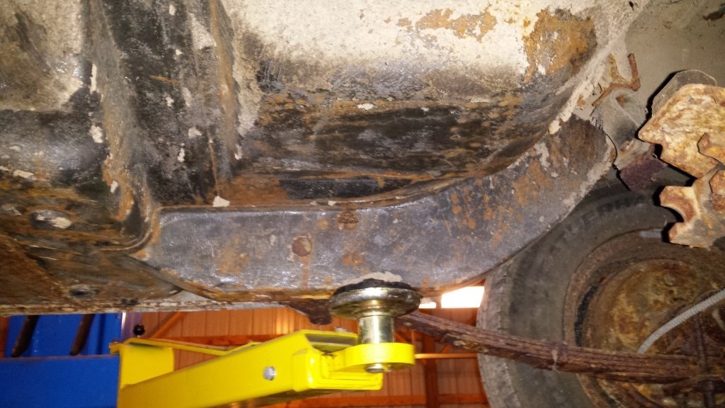

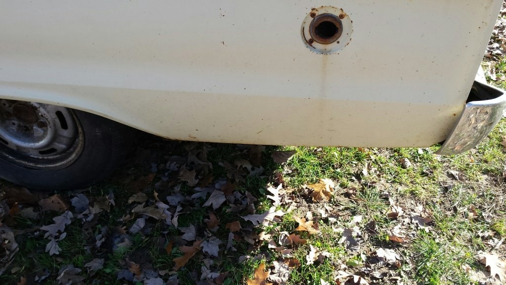

I purchased a '67 Bev. II 4 door for parts and along with the car came numerous parts as well. My main goal in buying the car was for the frame rails, rear wheel wells, and hopefully the floorboards.
When I received the car the drives side rear quarter looks to be really solid so that will be a bonus. The guy I bought it from through in some quarter patch panels as well, I think he said they are from C2C but they could be Sherman parts. I will have to follow up on this. Any case I was able to get the car up on the hoist this last weekend and start cleaning up the under coating to see what I have. So far the floor boards, frame and torsion bar cross member looks excellent.

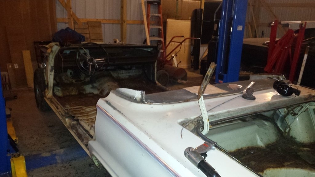

I now have a 4 door convertible!

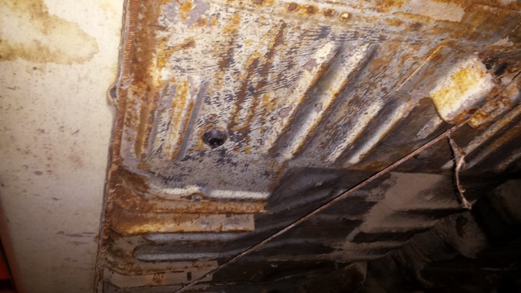

Most of the sound deadening is removed from the underside, boy what a job that is. There is some rust through of the front foot well area of the floor boards so new metal will need to be added. I am thinking I will media blast the floor pan before removing it.
The trunk floor is swiss cheese, so I will be cutting it out, I think I may blast the frame rails before removing as well.

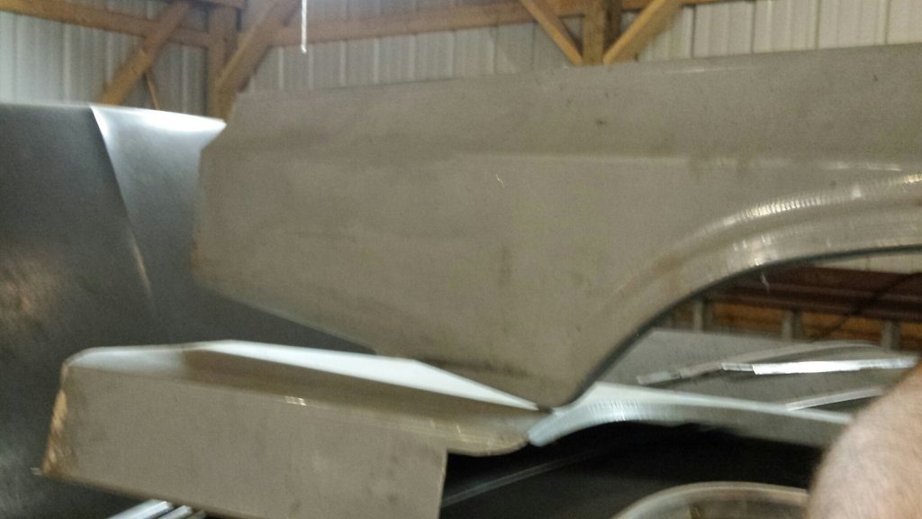

Need suggestions on how to replace rear quarter, I am kind of thinking of doing the rear quarter and wheel well all together instead of separating them and then putting it all back together.
Any ideas or opinions?
