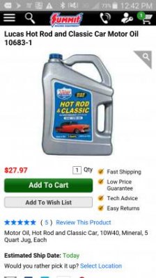

Never run a flat tapper cam without either adding a zinc attitive or an oil with it already in it. I use Lucas, they offer an additive that treats an oil change but I just buy the 5qt jug of their 10W 40 (I believe it's called Hot Rod oil??). I think some diesel oils like Rotella still have the zinc too.

Yes, if you use their additive then just fill it up with regular oil. I like using the oil I pictured because if you have to top it off you don't have to worry about thinning out the additive.
