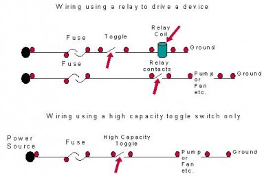

I am not an electrical engineer but I spent my whole working life with low voltage DC current. While I understand the use of relays in street and more modern cars, I have an issue with using relays especially in race cars. First of all, the 12V supply is from the same single source. The general delivery of that 12V's is through a set of contacts. Whether it is through a relay contact or the contacts of a switch the same considerations apply. That is, the supply must be constant and within a proper voltage range. The contacts are more than adequate to carry the load and that the wire used to carry that load is also more than adequate. The path is still the same regardless. The power is delivered through a set of contacts. I fail to see how the contacts of a relay are better or have some magic ability to correct any issues with the power source that the contacts of a relay doesn't have. The fact is, contacts only pass the power source to the device.
My issue is with the design when using relays and that is the introduction of additional points of failure. I once tried to figure out the difference in those points of failure when using relays vs a single toggle switch. It's rough but this what I came up with. The red dots and arrows are an attempt to show the most common possibilities. Again, my thoughts are mostly confined to race cars and the need for reliability. Part of having a race car is the eternal search for the weakest link.
