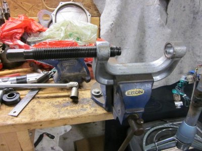

I'd like to be able to check them anyway for piece of mind. What's the best way (without a press) to pop the pins out? I was thinking of heating up the rod ends and pressing them out with a large c-clamp I have if I can find the right size sleeves.
Don't recommend heating the rod ends, not with the pins in place. Both rod end and pin itself will expand, so no help there.
If you have a service manual, it shows the factory tool used to both remove and install the pin. Might give you some ideas what is needed. That tool is something I should have found, or made, many moons ago!

Forget the C-clamp bit. It won't cut it.
Worth paying someone to press 'em out, and be done with it. Easier on the rods, too.

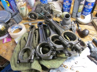

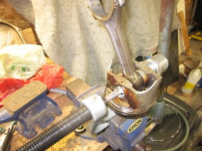

My questions about these rods was really to gather opinion on their usefulness. I'd like to check them myself, which requires removing the old 413 pistons. I have pretty good measuring tools, but I'll have to check their tolerances. That's about where I stop. After I check them, I'll have a shop check them and advise the next course of action. The shop will install the pistons onto the rods. While saving a few bucks is always good, it still has to be done properly. I plan to do the rest of the assembly myself and am pretty confident in my abilities. This is the fun factor for me...
As far as the C clamp goes, I think it will work with proper sleeving. This clamp is quite large, used for ball joint removal. I'll do some experiments this weekend and see what comes of it.

Sounds like you have a good apitude just lack of eperience. If you had ever pressed a pin out of a rod you would know that a C clamp isn't going to cut it

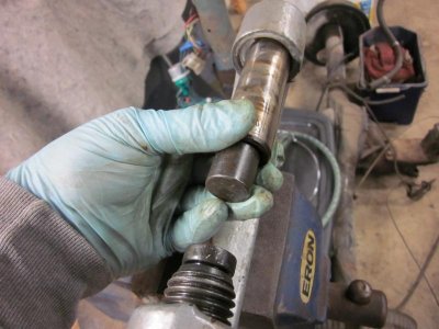

The C clamp worked very well. Here's my set up...

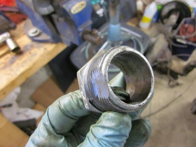

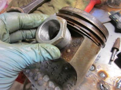

I had to find a way to put a sleeve against the pin bore. I used a rigid reducer which I flattened one side to fit between the pin bore and the piston top. Then I milled out the sharp threads inside to smooth it all out.

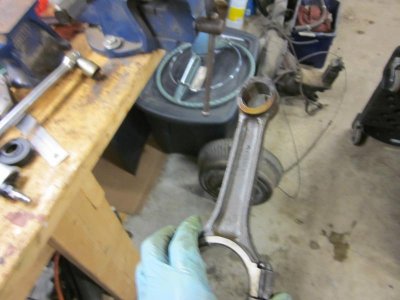

Wella, all 8 done which took 5 minutes each.

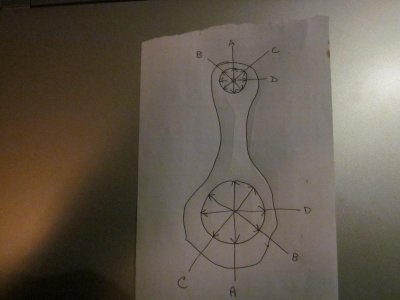

I did some checks and here's my numbers. I'm not sure how good or bad they are though. Thoughts?
