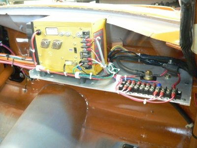

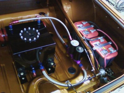

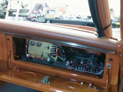

It can be tough if you don't know what to look for. I wire prototype cars for Chrysler. We deal with this stuff every day. Loose terminals, bad grounds are by far the most common. But some of the stuff gets way over the top with radio, magnetic, inductive interference. Follow the diagram, make sure the grounds are good, make sure the terminals and crimps are good.
Doug

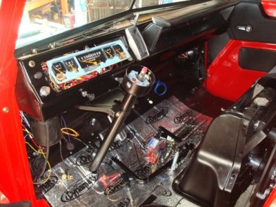

wired my own car, complete from front to back. using the wiring diagram (as well as reading glasses) to put it all back correctly. take your time, and look over the diagram time and again to make sure it's right. i'm a novice too. was my 1st. attempt at wiring.

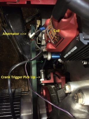

Yes thanks I will look into it I do have the coil and pickup for the crank trigger relatively close to each other

They really need to be separated. MSD sells a shielded cable (PN-8862) that is always a good idea.

Here is the alternator coil and crank trigger together
The Green Arrow is where the crank trigger wire comes very close to the alternator

I use twisted pair shielded wire with a 3rd bare ground wire. Ground the shield to the MSD box ground stud at that end only. Never an issue.
