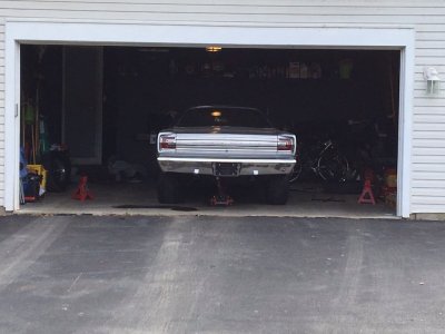

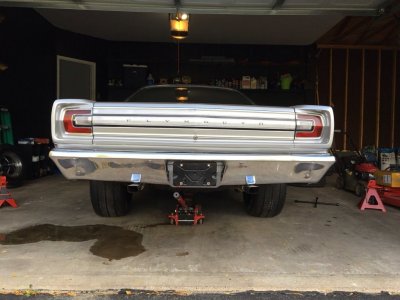

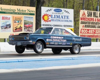

Started as a street strip car and morphed in a strip car ultimately running 9.88@ 134. No rear wheelhouse alterations, 9 or 10 inch x 28 inch slicks.

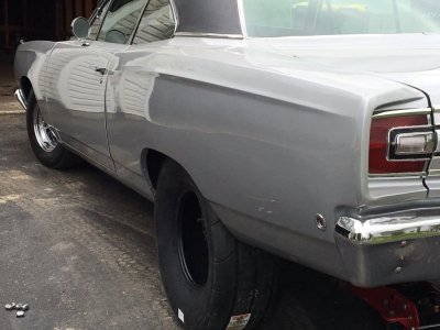

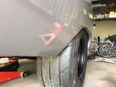

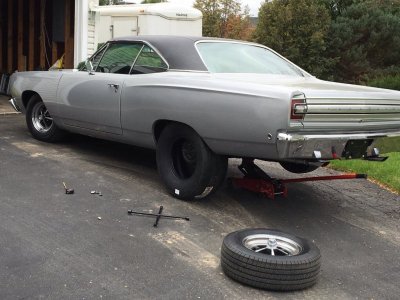

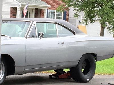

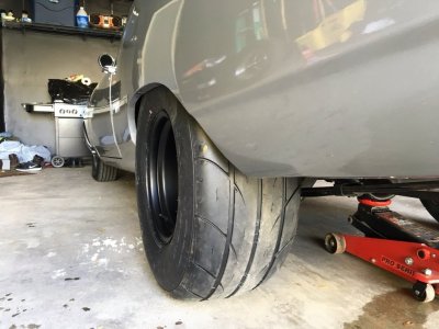

Wheels came today! The fit is good, but looks like I will need the +1 inch lift split mono springs with the Caltracs...and shave the inner lip. Gonna order the Moser Muscle Pak 60 stock width, stock spring location!!
The inner lips will definitely have to go.
Any body lean will destroy those side walls.
Looks bad ***!
Beautiful car! Moving the springs gives you flexibility, a narrowed rear also makes tire removal much easier. When I ran the stock width, needed to unbolt the shocks to let the rear drop far enough to remove the tire. Dana 60 is the way to go for unmatched durability. FYI I don't use a pinion snubber, with the correct spring package, totally not needed. If you can afford the CalTracs, that's got to be the best, otherwise the SS springs are still good.

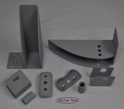

Thanks guys, just waiting for this to arrive...
Should be here Wednesday! Will see where the spring perches need to be before I order the rear end. These seem to have three different spring attachment points so maybe I won't need the +1 inch springs. I'll mock it up wth the current rear and see.
