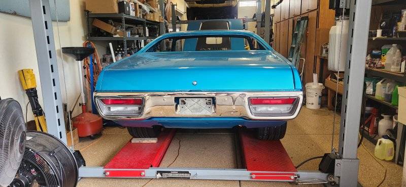

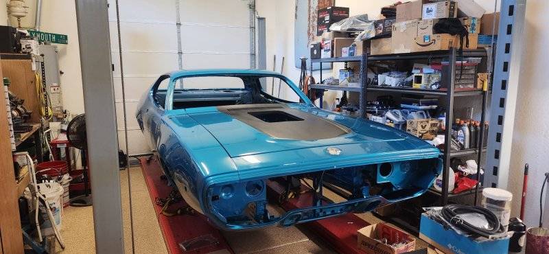

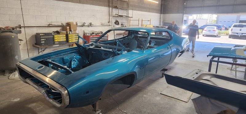

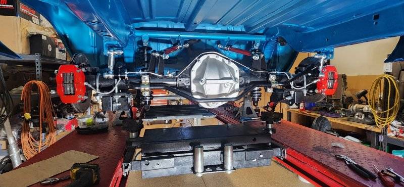

Its been well over a year since this derelict Satellite followed me home. The paint is done. Now all the shiny and/or new parts can go back on.
The link is from a year ago when I started the dissasembly. I dont like yellow cars, and currently I have a 73 in yellow. So the 72 had to change colors. Satellite anyone?
Kinds looks KB5.
I like it.

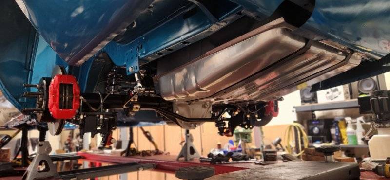

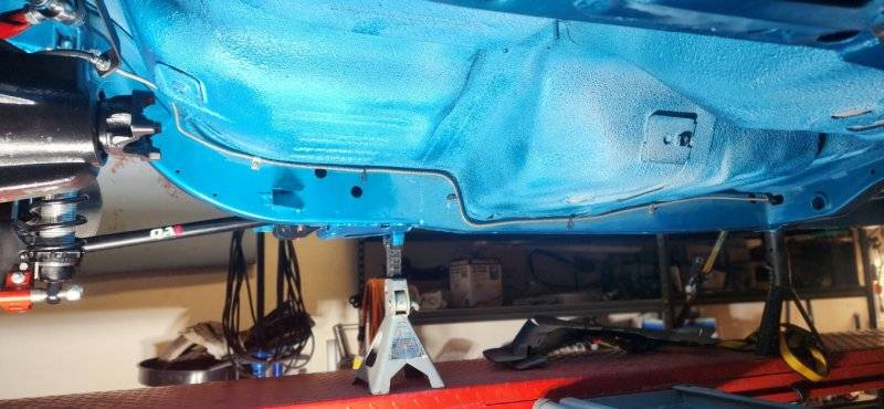

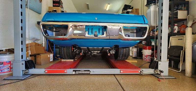

That is a really unusual way to mount a rear sway bar.
Nice color....I love B-5!

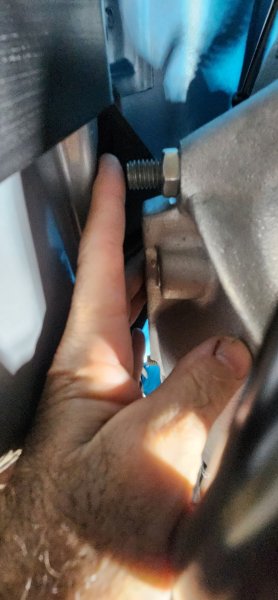

I know, it is odd going to the rear. Putting the rear end in the car now with the cast aluminum diff cover, with the axle up to the bump stops the bar was contacting the cover. Had to make some 3/16" steel plates to shim the bar away from the axle a little. When test fitting it I had a stock cover on the Dana, lots of room. The big diff cover was also touching the fuel tank. flange. I rolled the lip on the tank for clearence, I hope it dont leak.
It is actually Q5 Coral Turquoise Poly. Looks a lot like B5, just with a hint of green depending on the light.

That's $3000 leaning against the wall right there. Man this world is getting crazy.
I think I am very happy with that choice though. 315/40's on the back.

I don't know how you can work in such a claustrophobic space! That's would drive me nuts.

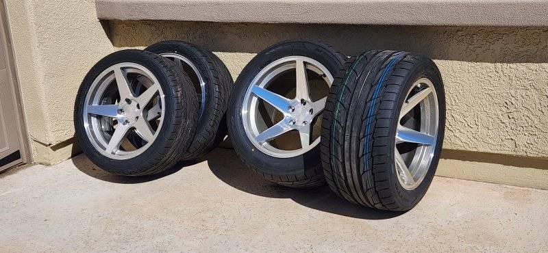

That's an interesting wheel.
Kinda hard to find "modern" styled wheels that look right on classsics.
Can we see a full on or 3/4 side shot with the wheels on?

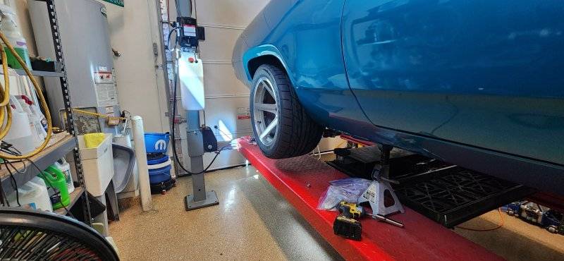

Wheel choices are very few when trying to get the correct offset and wide width. The rears are an 18x11 with 5" back space. Fronts are 18x8 with 4.5" backspace. They were off the shelf, not custom made. A custom wheel would have cost twice what these were.

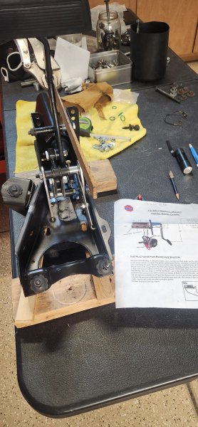

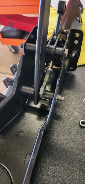

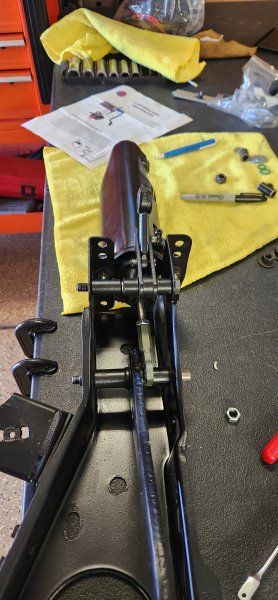

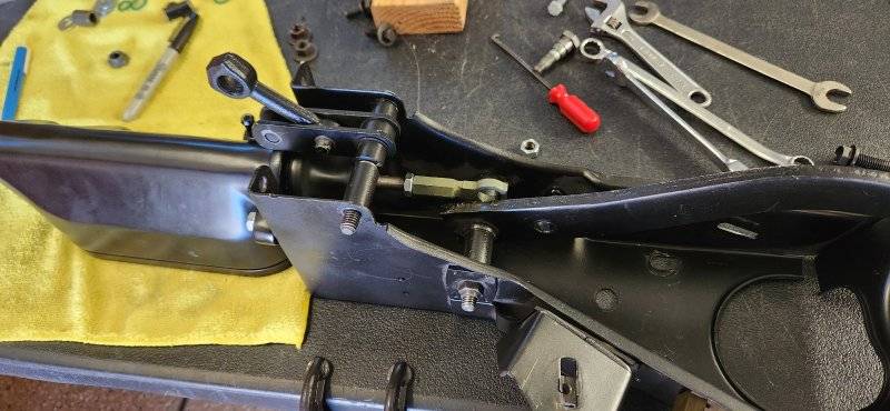

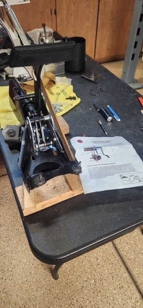

This week I have accomplished quite a bit. Brake master cylinder is fitted to the brake bracket. The stock power brake linkage did not work with this system. It is a pressured master cylinder from ABS Power Brakes. I refitted the linkage in the bracket, upside down and reversed to get the ratio and pedal travel required. Fabbed some mounting brackets to hole the linkage.

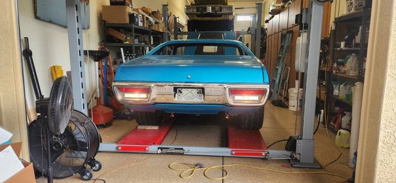

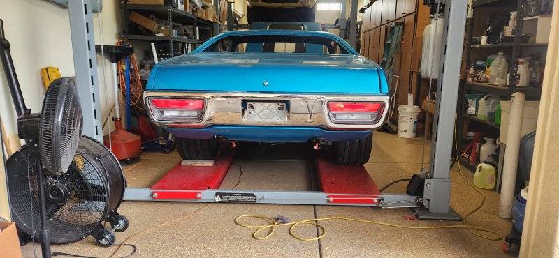

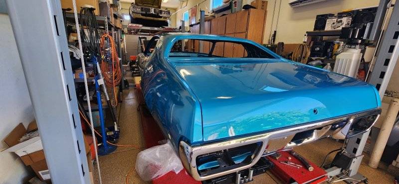

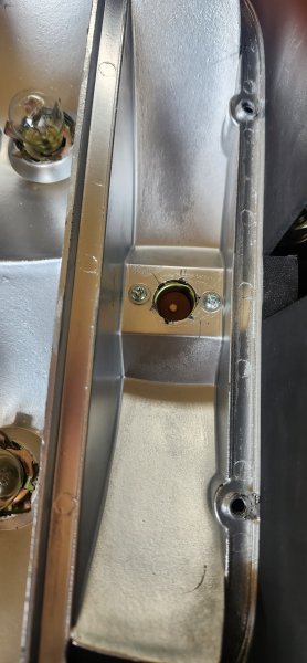

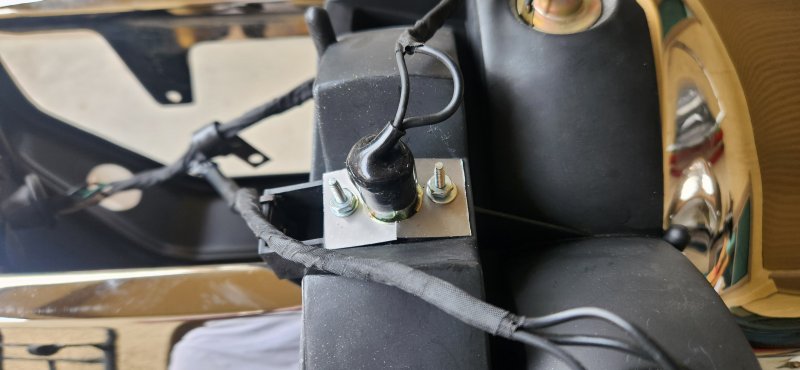

The rear lights are installed in the bumper. All rusty old sockets were replaced re-using the stockish wiring. It took a conglomeration of housings, wiring, and new sockets to get here. Had to make a retainer to hold the reverse sockets in place. Not the best looking, but it will last another 50 years.
Front lights are in and aligned. Looked for replacement turn signal lenses. $250ish for aftermarket. Going to polish these lenses and see how they turn out.
