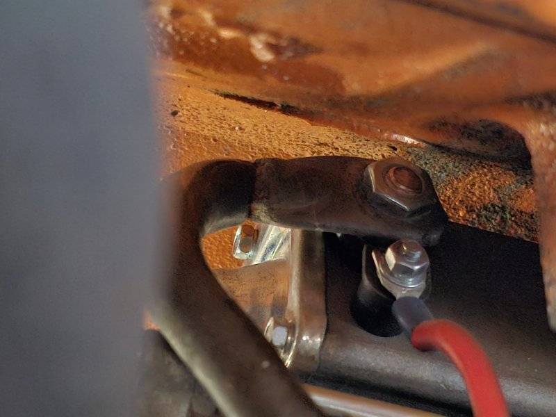

Hello,
I installed this Dakota starter on my 440 about a year ago. It works great and I have not had any problems but I always wonder if my battery cable is too close to the block. I know they make a relocation adapter for the cables. I did not use one. I just removed the block that came on the starter and connected the cable using the shorter nut that was used to hold the adapter on.
Its about 1/8" away from touching the block. I just worry that if it ever came loose maybe the cable could rotate just enough to make contact with the block and short out. Am I worrying too much about it? Should I get the relocation kit?
You could wedge in a piece of plastic if it worries you.
I have a similar condition with 2 of my cars. I've been concerned too but with the cable secure, it has been fine. I also have my cable coming in from the other side from the firewall forward.

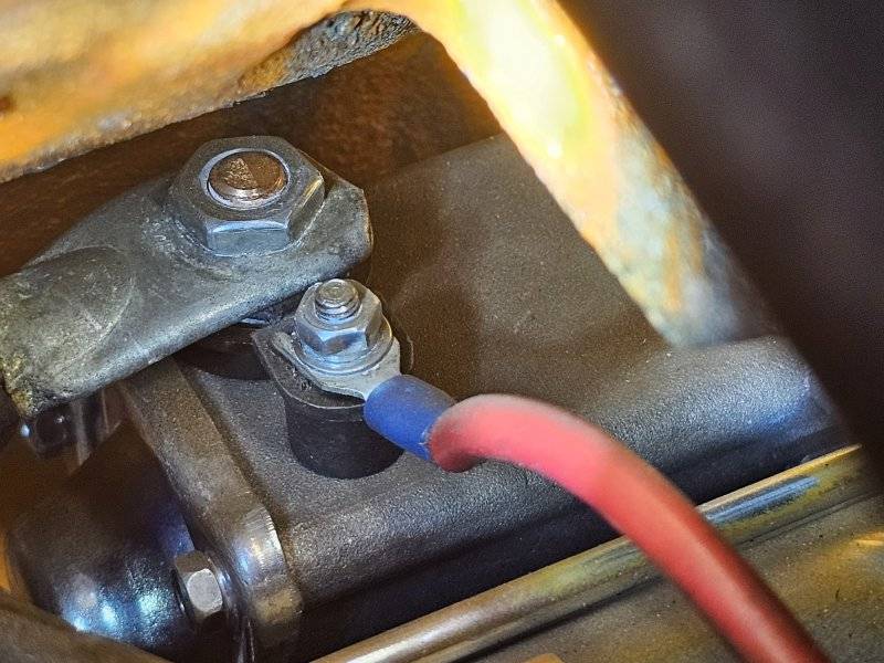

Here are some better pictures. There is also about a 1/8" gap between the 2 terminals. If it were you, would you leave it or get the relocation kit?
It is easy for those of us with nothing to lose to tell you to not worry.

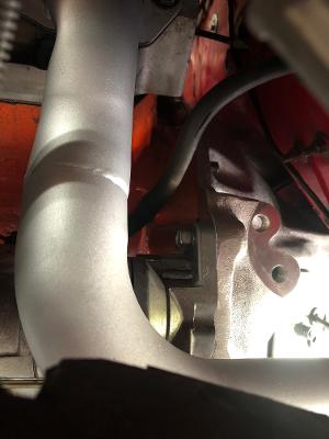

I've had a few different mini starters in the big block cars. They came with a bolt on offset terminal adapter, I run without one to keep the cables closer to the block and away from the header.
I know that it is tight up in there. You can't simply wrap it with tape. you're sort of stuck either buying a different starter or trying to convince yourself that you will be fine.
My car looks similar and I am not worried about it.

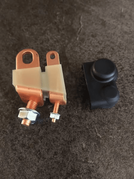

I would just buy and use a Dakota starter lug relocation kit.
They are around $12 and it makes life a lot easier. I have them on all of my Dakota starters.
Tom
It's "Probably" fine.. but i'm a worrier... it's $12 and 20 minutes to fix it and never worry again....
Look on E-bay for the relocation kit. Individually they are closer to $20 with shipping. To get the lower price I think you need to buy a couple at a time.
I think I bought 5 kits at one time to get the lower price.
OK, I'm convinced! I gonna get a relocation adapter. Thanks everyone for your help:)
You do NOT need a relocation lug!
Get some hard plastic that will slide down the gap between the lugs to prevent accidental contact. Silicon in place. Job done!
There are two different adapters, one is horizontal like the above picture and the other is vertical.
