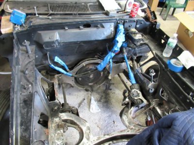

Hell I made my K frame heaver when I welded all the seams and installed Firm Feels bracing kit with skid plate. I wanted to take out as much flex possible.

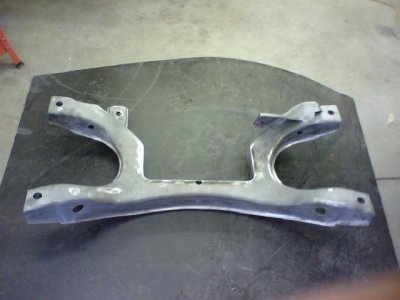

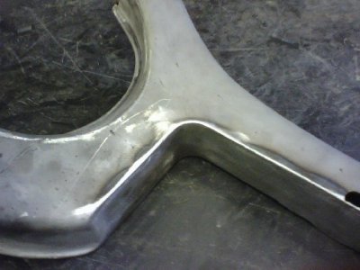

The light weight k members that Mopar built were Magnesium and they cracked and were deemed unsafe. I run "John Holt Racecars" light weight k members in 3 of my cars. He modifies the stock unit and after he is done, it is half the weight. A lot of the SS/AH cars on the circuit today use his k members.
Any chance you have pics of one of these K frames? I checked his website but they weren't mentioned.

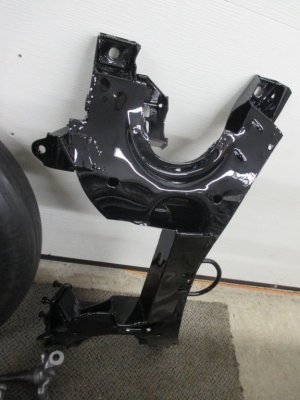

The k frame on my 65 Belvedere started out at 43 lbs, when I finished cleaning and modifying it, it was down to 35 lbs. Was a heck of a lot of work for 8 pounds.

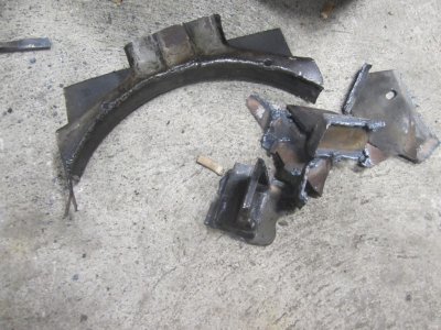

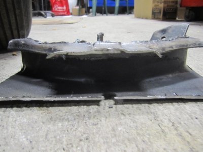

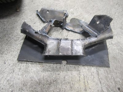

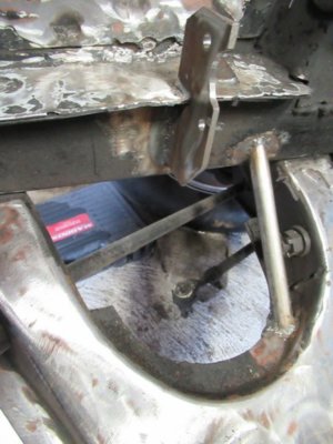

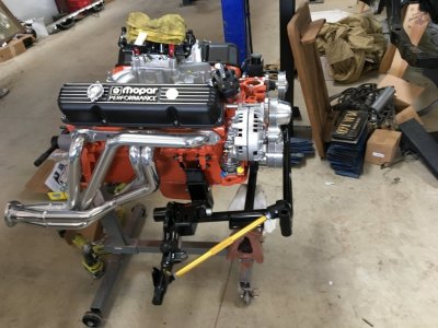

Sorry, cars are put away for winter. He uses chrome molly round tubing and there is no part of the original k member left in the center and all of the 5/8" tab around the edge is gone and then welded. stock steering box still mounts to k frame. Hold downs and tow strap mountings are optional. $750
I do not know if this has changed,but several guys I know that went to a rack lost considerable turning radius............

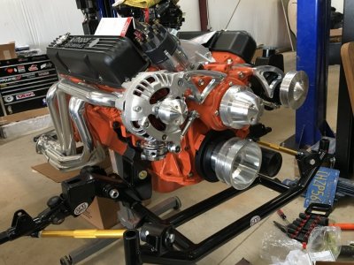

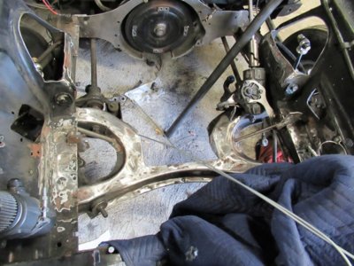

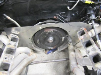

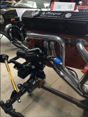

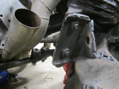

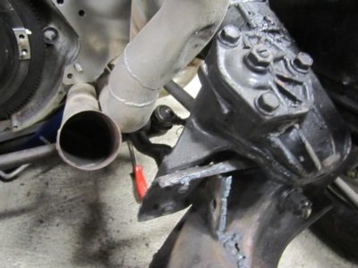

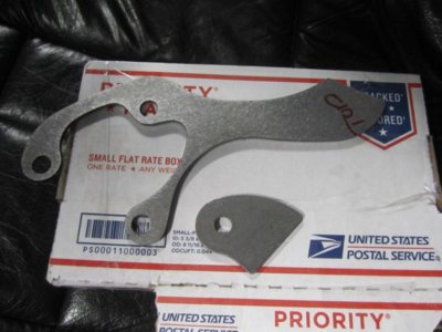

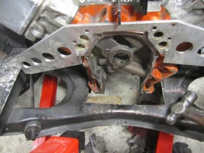

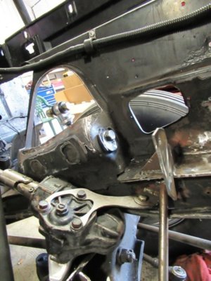

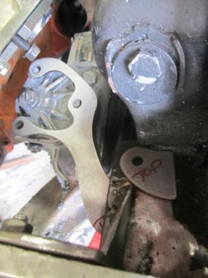

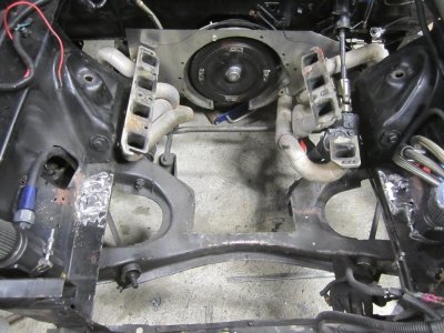

I have a steering box brace because the motor mount was totally removed as I have a front engine plate and a mid plate.Also ran braces to both sides of the modified "K"
Also added "J" bars to stiffen the front chassis.
