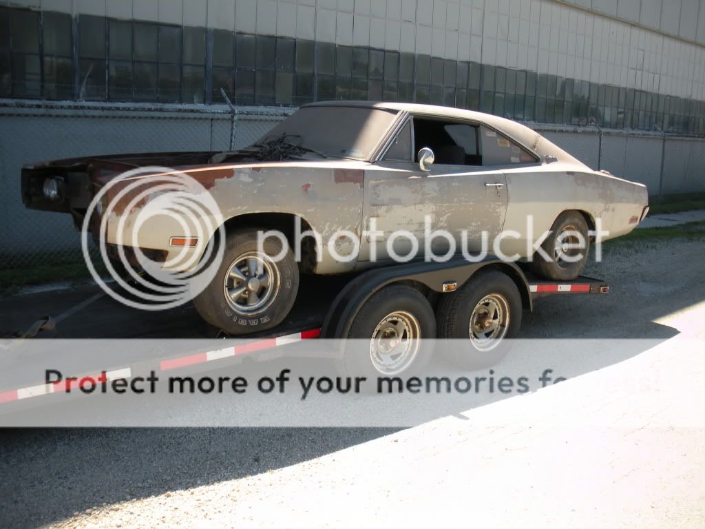

I figured I would finally start a thread here for my '70 Charger. I bought it out of an old warehouse in the neighboring city and drug it home. The PO had already started tearing it down to restore but a roof replacement and ill-timed storm ruined that plan and left him needing to sell. I had my pick of probably 30 different cars ranging from 1910's-1980's but the Charger spoke to me and I had to save it, much to my uncles' chagrin... It was a basket case and I started chipping away at it as I could.

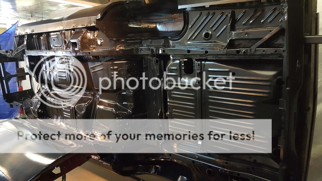

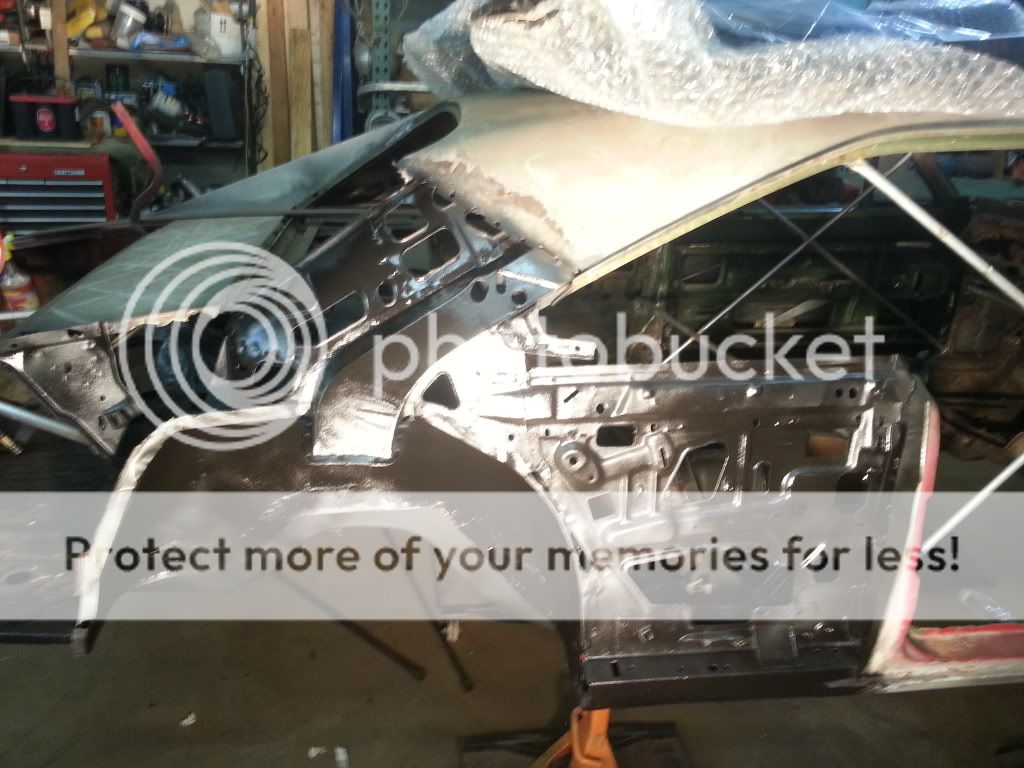

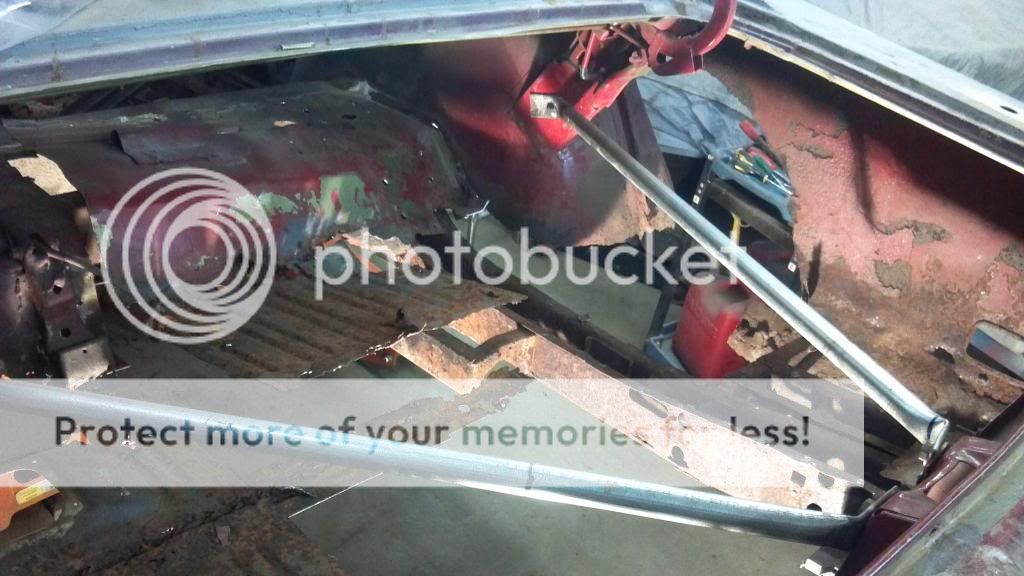

Now I am getting closer to paint and plan on having it ready to drive on my wedding day in September. I still have a long way to go but am excited to get there finally. So far it has been 6.5 years and I have had to do a lot to get her here (floors, 1 frame rail, full quarters, all rear bracing, valence, dutchman, rockers, subframe connectors, torque boxes, torsion bar crossmember, and repair pretty much everywhere else).

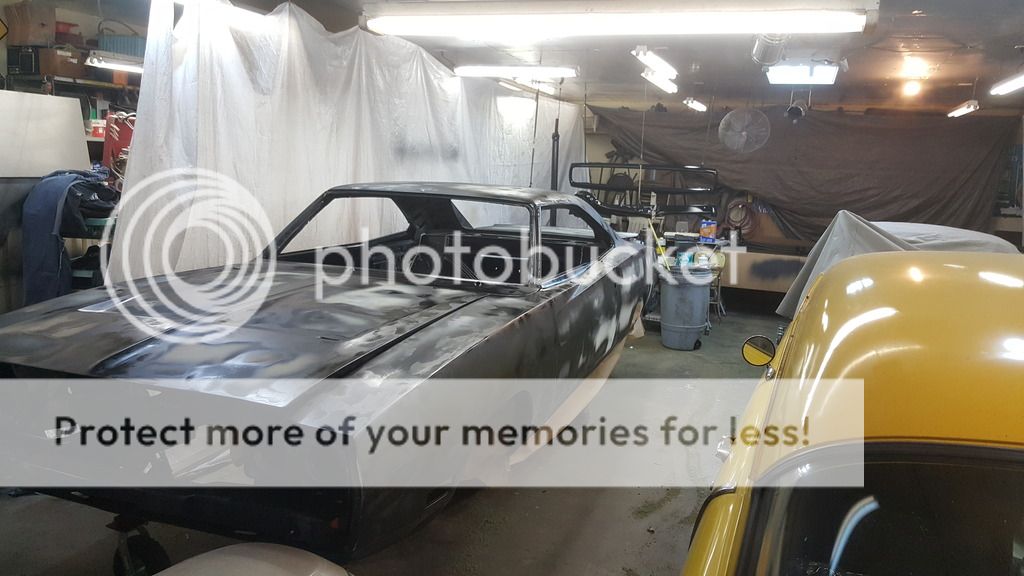

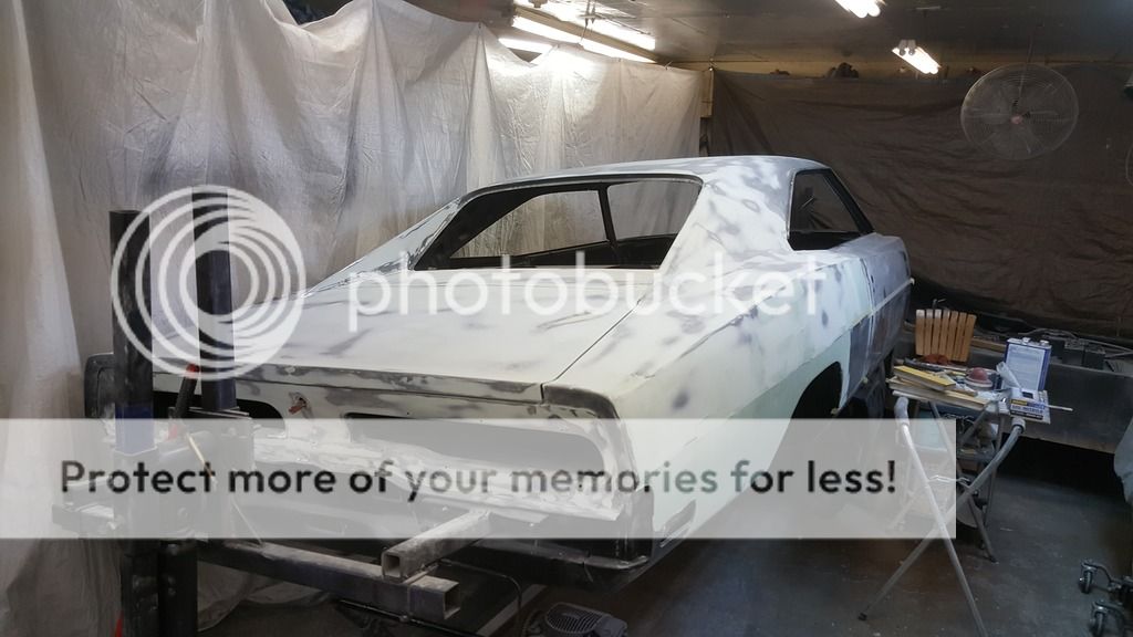

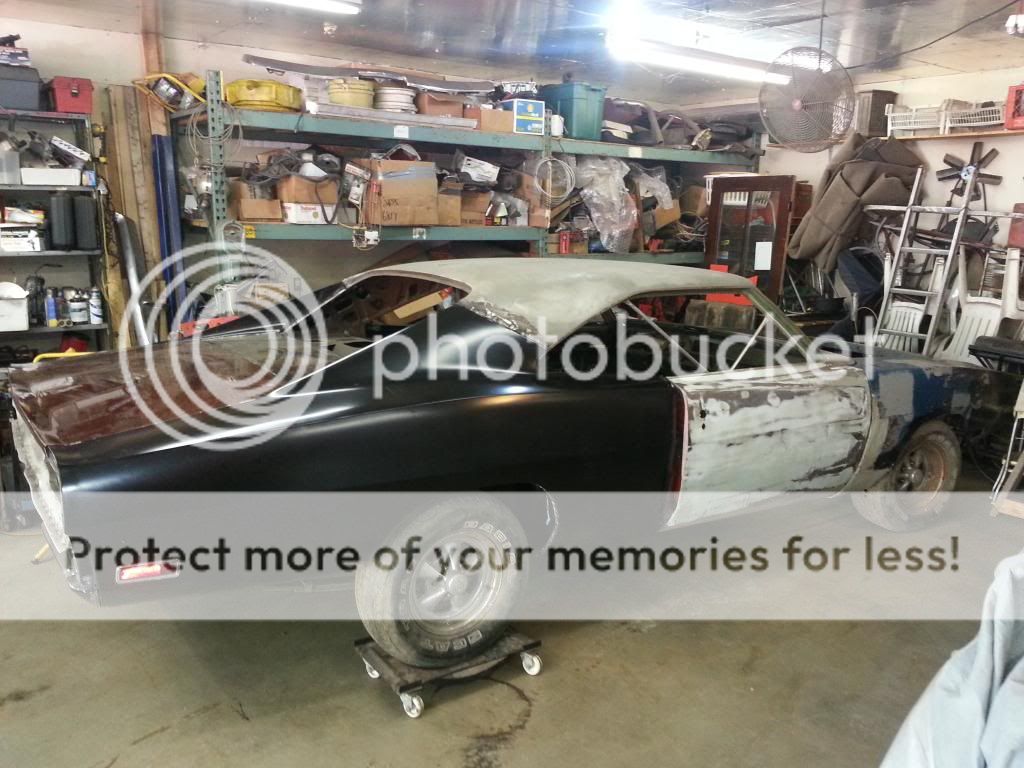

Thanks! I finished initial blocking on the drivers side and have been working on the trunk and tail panel. I will hopefully finish the back of the car and move on to the passenger side.

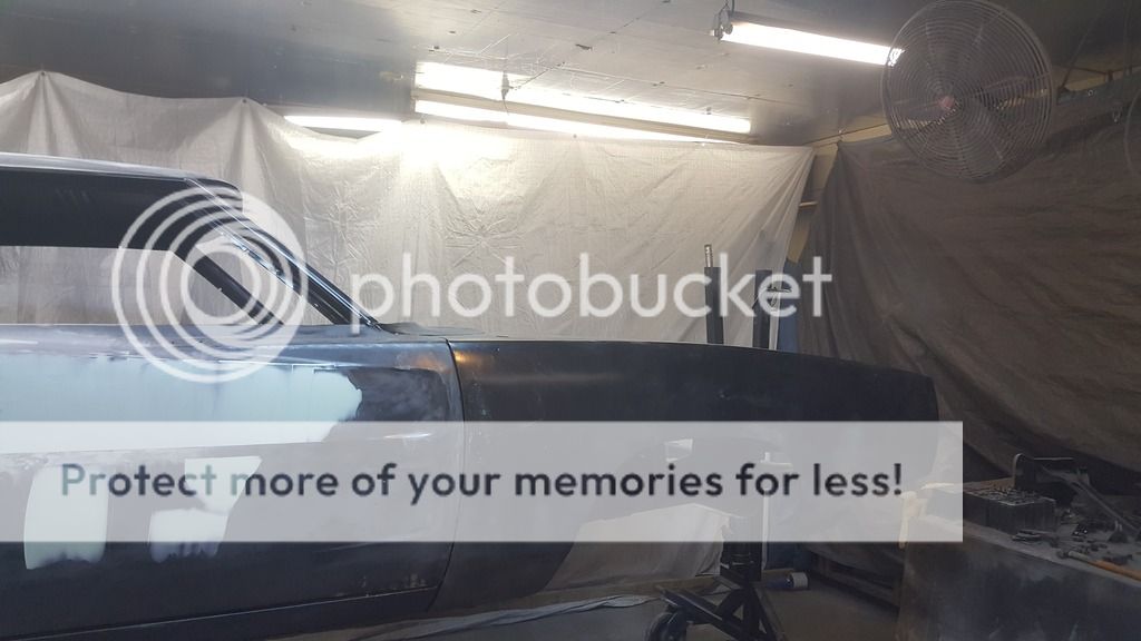

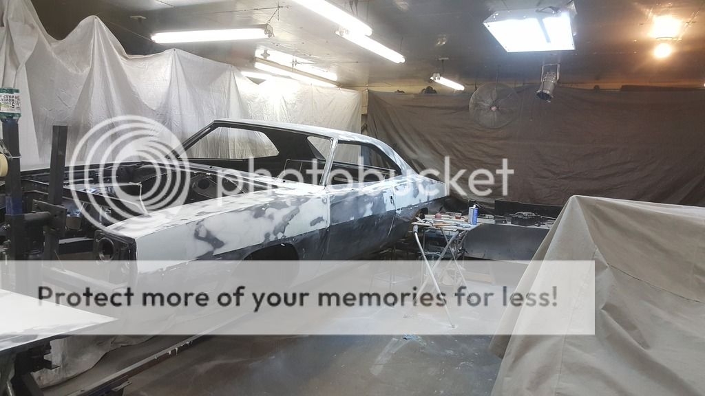

More of the same...

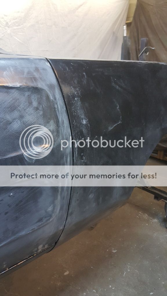

Ps quarter almost done.
Ps door adjusted and fender attached and adjusted.

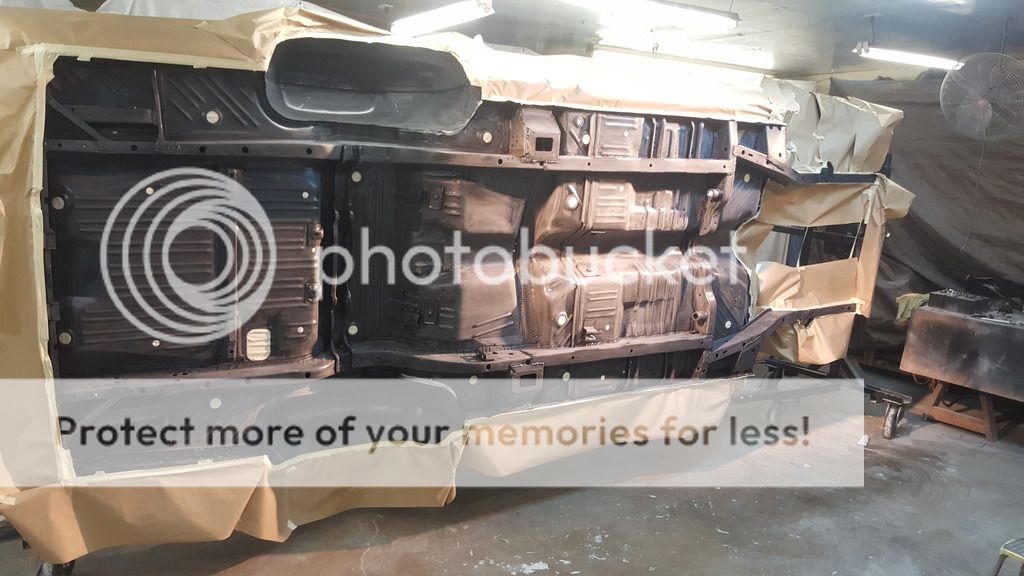

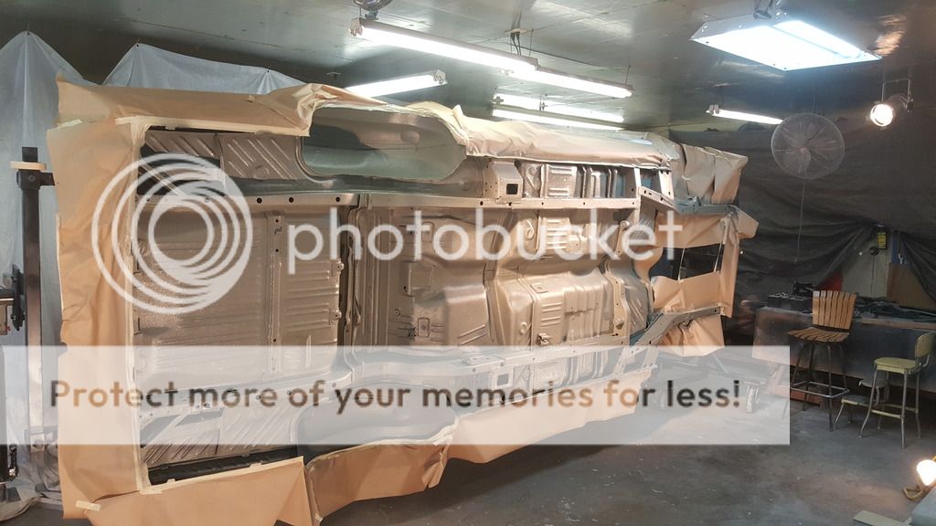

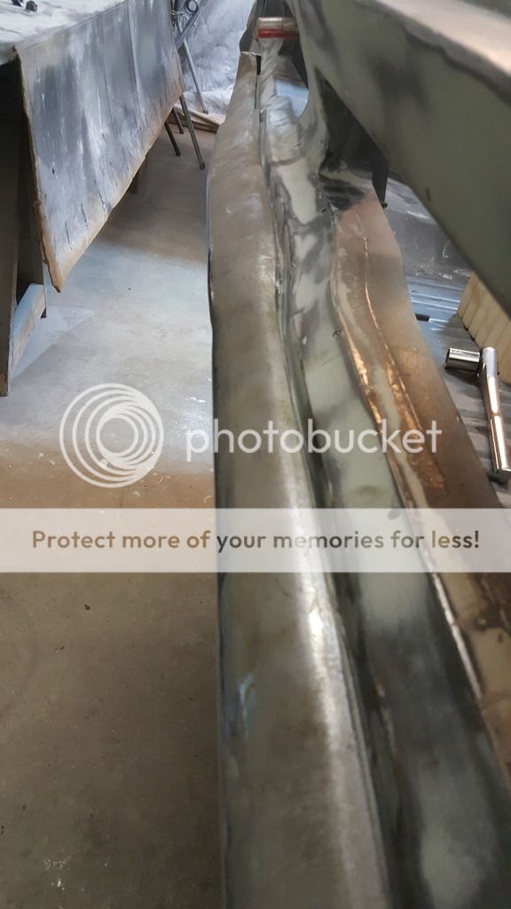

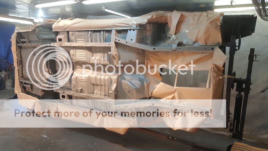

I got the bottom of the car silver! I used UPOL's Raptor Liner to give it a very nice durable finish. The liner is tintable to whatever you desire. I was nervous at first but as it has flashed and continues to sure, the color has gotten more accurate.

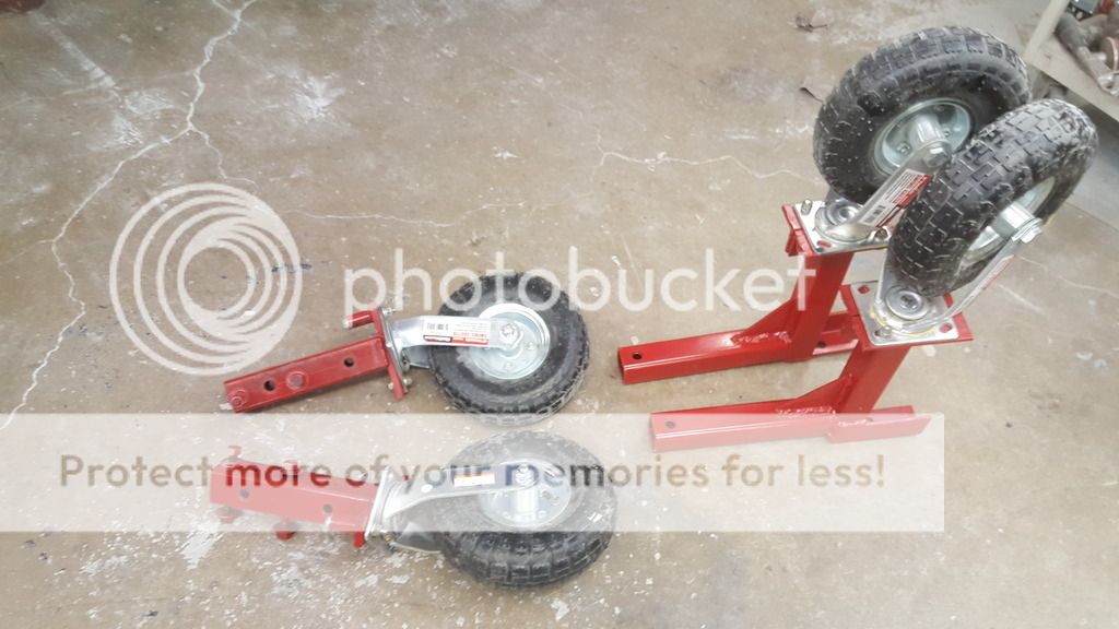

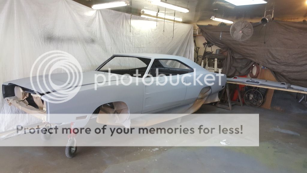

I also built some wheels to get her off the rotisserie and to get ready to roll to the paint shop.

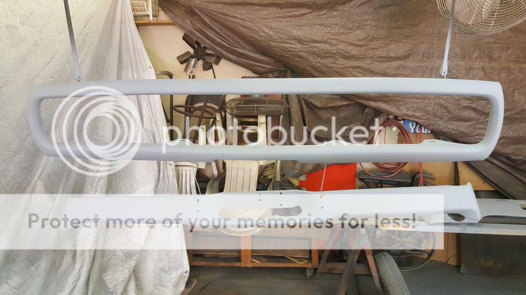

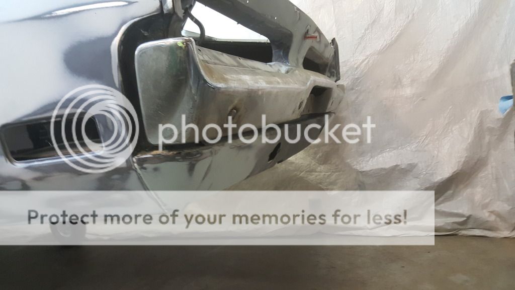

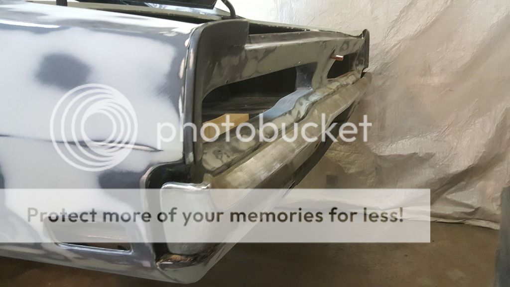

I decided the bumper gap was too much for me and cut almost 1/2" out of the brackets.

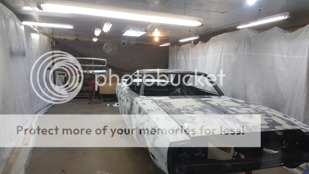

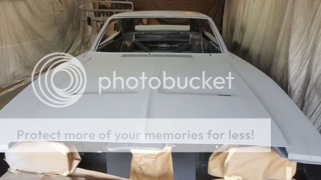

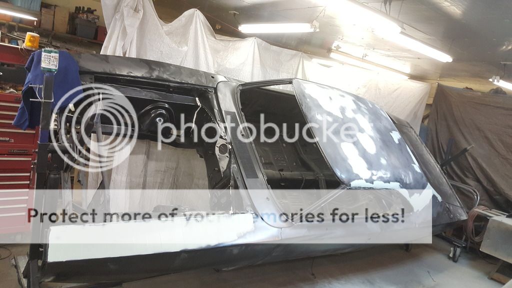

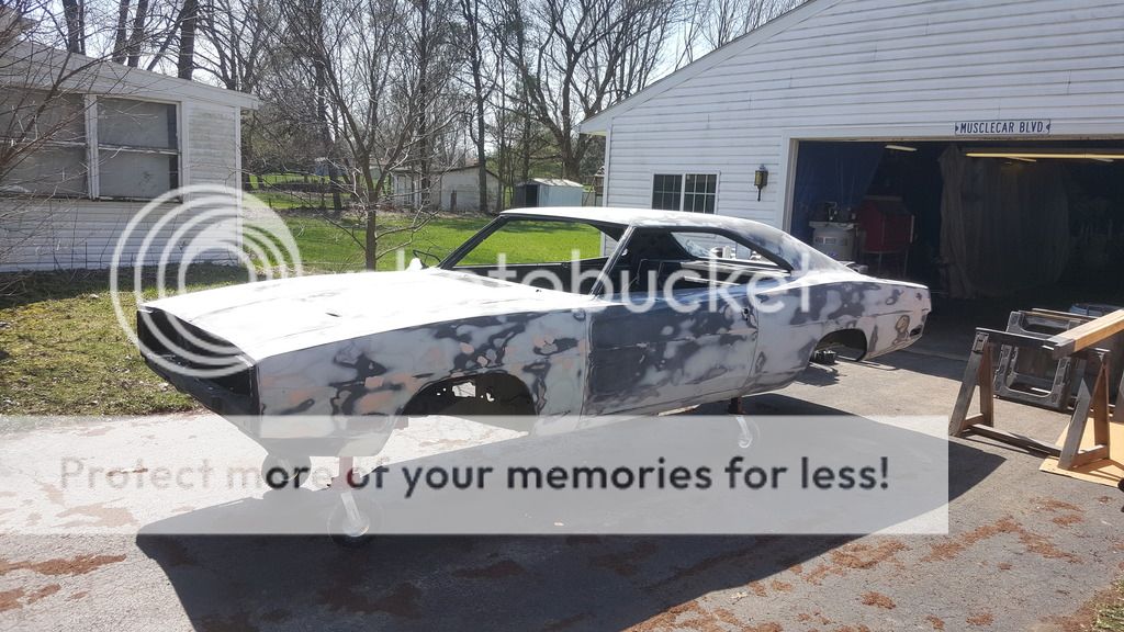

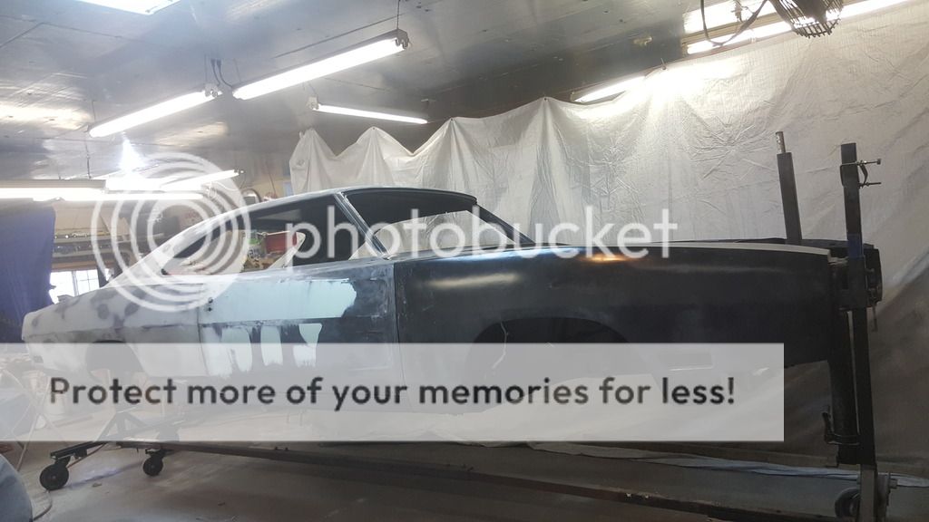

I rolled my Charger outside to blow her off really well and the proceeded to shoot some more primer on her. I had to touch up some areas with epoxy where I had broken through and then shot the high build. I have to admit, I am very happy with how straight she is and can't wait to start blocking her to see what all is left before paint.
