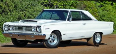

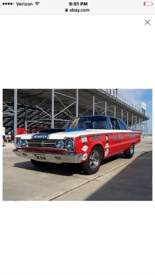

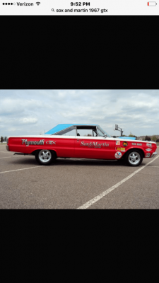

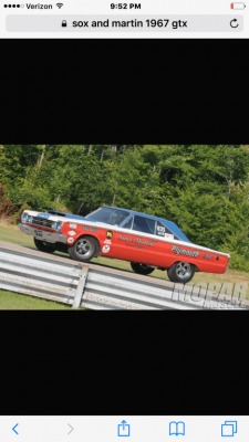

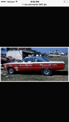

When I first laid eyes on my Belve 12 yrs ago at gas station in Santa Ana it was dumped! I mean it's *** was sagging low-rider style! It had been put on wooden blocks somehow to compress the springs or some loco ****..anyway I got those removed and purchased new leaf springs eventually which I had hoped would push that *** up in the air more! It did a bit,but I still have almost half of my rear wheel covered by the fender. The look I want is stout and sprung I guess.. Here I am now in red, that's my man Petty in blue there, and what I think is perfect posture in white. Ha! Red, white, and blue....'Merica!
How is this posture/stance achieved?

either get your springs rearched or find a set of hijacker air shocks , at least with the air shocks you can adjust the ride height to suit conditions
Get them re arc arched!
Your springs are new, so I suggest you add extended rear leaf spring shackles. Anything like this will work https://www.carid.com/superior-auto...?view=985764&gclid=COCgm7Tnv9MCFZS2wAodlwAKpA
If you go with this "generic" type of rear shackle, keep in mind that you might have to add some washers or something to space it correctly. Better yet, find some Mopar-specific extended rear shackles. You'll also "might" need rear shock extensions or longer shocks (e.g. for a C-body).

I agree the stock spring height ain't working. You can order new springs that are 2" higher, but even then it's hit or miss. I went with Mopar Super Stock springs and air shocks to get my height right.

If your not happy it doesn't matter, they can be arched to achieve the desired stance. I have new leaves as well that were supposed to drop mine but didn't drop it enough, I had them take another 1" out of them.
That stance looks correct, you may not like it but correct

Ok! Now that's cool! So am I to understand that Sox and Martin would have used these air shocks to achieve this appearance? And I'm sure it wasn't just on appearance alone that they put the *** end up. I was under the impression they used super stock leaf springs to achieve that stance for a better hook on launch. Air shocks, super stock leaf springs, re-arch the leaf springs, gas adjustable, make your own brackets like a wizard? I don't want more systems to maintain with compressors and all this. It seems like a headache. I don't weld or have the tools to fabricate right now. But what you've done seems legit. Do you have more pics of the car?

They will lower or raise your rear depending on where you install them. By the way the white car you posted has the perfect stance in my eyes - would love to own one like it someday.
