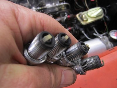

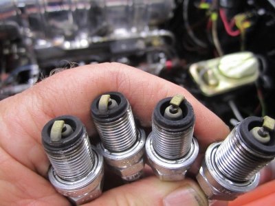

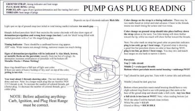

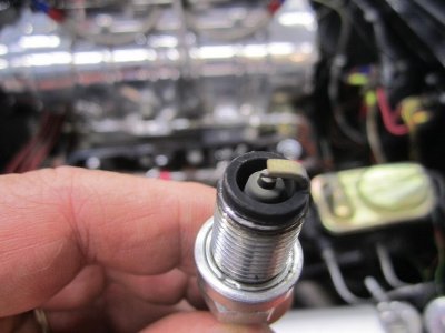

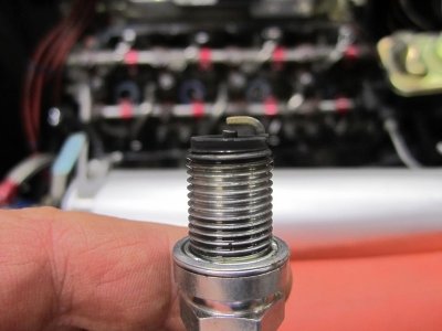

I have a Holley jet set.When I make a move after a plug reading and looking at the racepak data,I go up or down according to what I see.I don't think it makes a diffrence what brand I'm using as long as they are the same manufacturer.
