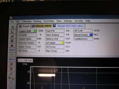

I was able to shave almost a 1/2 second when I started logging. Plus I was able to test without going to the track!

This has been a good discussion . A/F reads are key
Yes that is so true. I would love to see some AF ratio readings on the different jets with the same hole size and different #'s.
