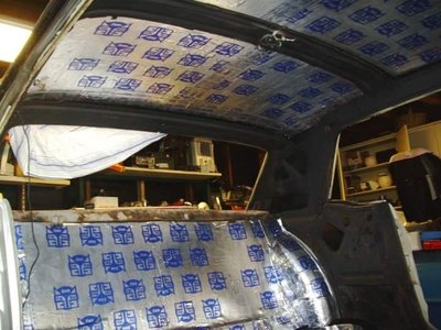

I've done it on 3 cars now, no complaints. Installed on the roof and inside of doors, keeps them from sounding hollow. I covered every square inch,from the firewall all the way up to the package tray.

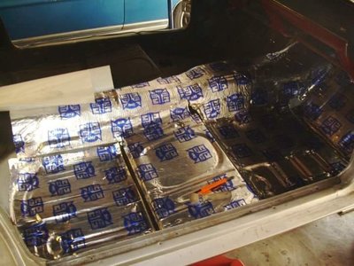

FatMat
If it's a 66-67 use extra under the backseats where the muffler is. That section moves up and down like a woofer at a Funkadelics concert.
My vote is for homemade lizard skin! Or even name brand. At least if you decide to remove it it's not a total horror show like the butyl is. It's just like removing regular paint.
FatMat

Never heard of fat mat..whats the difference with this and dyna?
