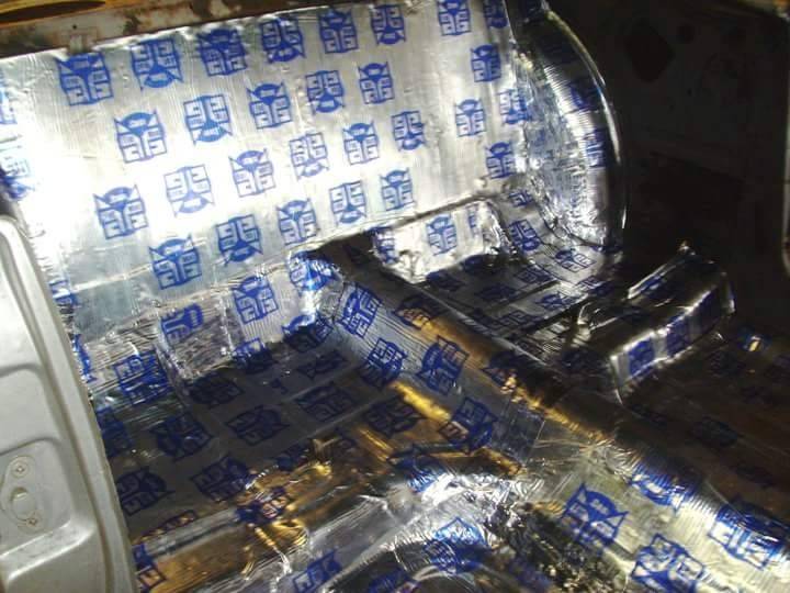

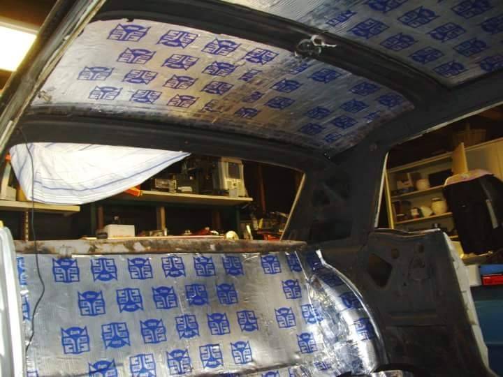

I've done it on 3 cars now, no complaints. Installed on the roof and inside of doors, keeps them from sounding hollow. I covered every square inch,from the firewall all the way up to the package tray.

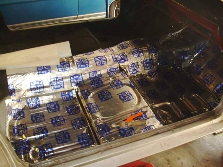

One recomendation is to put it down last, I put it in first on the Mustang and after several months of crawling around on it compressed it which may affect some of the heat deflection...it sure makes it easier on the knees though!

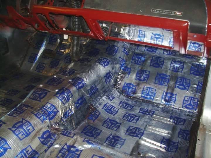

About 1 1/2 rolls, I think I bought 2 of the 25sqft of the 50mil. That was in a 68 mustang coupe so a b bod would probably use 2 full.
One recommendation is if you do have any left over double it up on your trans hump and footwell/ firewall where headers pass. Or up grade and get the 80 or 110mil. It works pretty well as a heat shield though its primary function is sound dampening.
