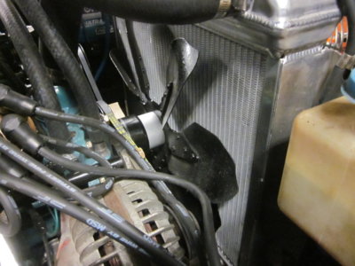

While a shroud should help with temperatures in traffic, can it make any difference with engine compartment temperatures?

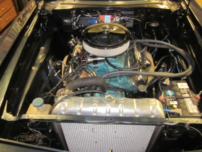

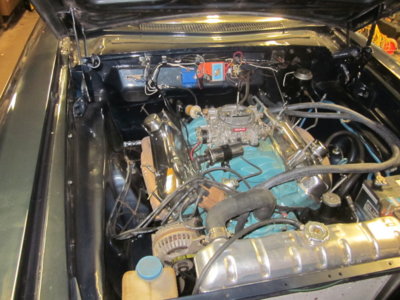

Here's the engine specs and some analysis info.
Engine 413:
bore 4.25", stock stroke with Ohio H-beam rods, CP flat top pistons with valve recess
906 heads, with stock valves, new guides and gasket match porting, stamped rockers and Comp 911 springs. Did not cc heads but estimate compression to be around 9.4
Lunati 60303 hyd cam:
Basic Operating RPM Range:1,800-6,200
Intake Duration at 050 inch Lift:226
Exhaust Duration at 050 inch Lift:234
Duration at 050 inch Lift:226 int./234 exh.
Advertised Intake Duration:268
Advertised Exhaust Duration:276
Advertised Duration:268 int./276 exh.
Intake Valve Lift with Factory Rocker Arm Ratio:0.494 in.
Exhaust Valve Lift with Factory Rocker Arm Ratio:0.513 in.
Valve Lift with Factory Rocker Arm Ratio:0.494 int./0.513 exh.
Lobe Separation (degrees):110
Melling HV oil pump
Summit Iron HV water pump
OER Alum Rad with two 1" tubes
7 blade fan
HP Manifolds
Edelbrock PErformer 440 intake, no crossover
Edelbrock 750 with 1/2" phenoilc spacer
Carter fuel pump
orange box and stock distributor. Timing was set at 12-13 BTC. The mech adv is stamped 9* and vac adv seems to bump it up by 10*.

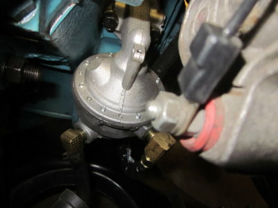

5/16 Fuel line was installed at the rear and a sock added when I first had an issue a few months ago.

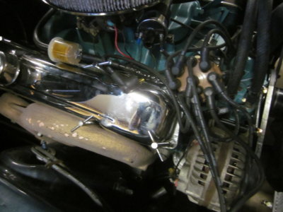

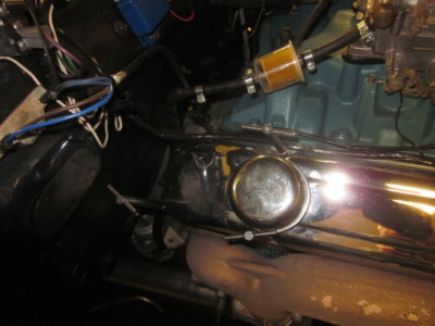

I relocated the fuel line yesterday, thinking the heat is too much at the firewall. My feet while driving on Saturday were roasting, even with the insulated mat and carpet.

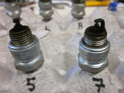

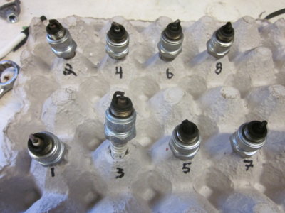

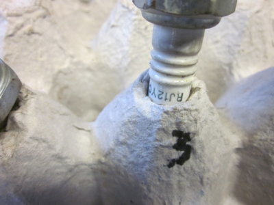

Pulled the plugs and they look rich to me.

I tried backing off the timing to 10, 7 and then 5 btc, but the engine would stumble when throttling the carb a bit. I also went higher to about 20*, which ran ok and brought the total timing to about 30* with the vac advance left disconnected and plugged off. Once I add the vac adv, the timing would climb to over 40 at a few thousand rpm. I thought the vac advance wasn't used once the rpms climb?

Hard to tell but looking at the plugs you may be running rich, also like moparnation said timing could need adjustment.

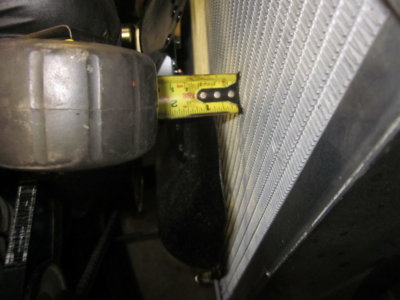

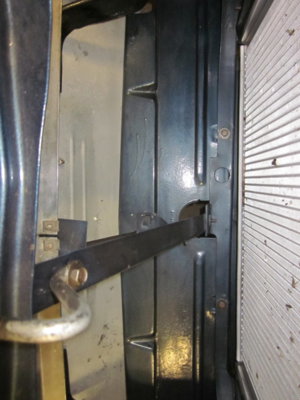

X2 on everything said but that fan distance without a shroud is a killer....Im betting that is most of your problem at low speed and in traffic.
There's not enough negative pressure across the whole area of your radiator to cool it effectively. You can take a small strip of a paper towel and hold it in front of the radiator and see if it gets sucked to it. I'm betting anywhere outside of the circumference of the fan is getting no flow...JM.02
I thought that the ideal distance for the fan was about 3/4" without a shroud. I know a shroud will help to cool better, but wouldn't that throw even more heat at the engine? I haven't had overheating or related issues until we hit 90F. I also haven't driven it much more than 20-30 minutes at a time on the hwy until Saturday.

You need a shroud definitely, ur running a direct drive fan & not channeling the air correctly. Total timing oughta be 34-38* range revved up w/vac advance unhooked. Forgot the t-stat ur using, if u said, nothing higher than 180*. Do u have the hood-radiator rubber seal that seals on the rad.support? That helps too.
It is the fluid your cooling and shroud allows the fan to pull air from the whole perimeter....without it you pull he circumference of the fan....That area not pulled equates to a decent percentage of fluid not cooled
