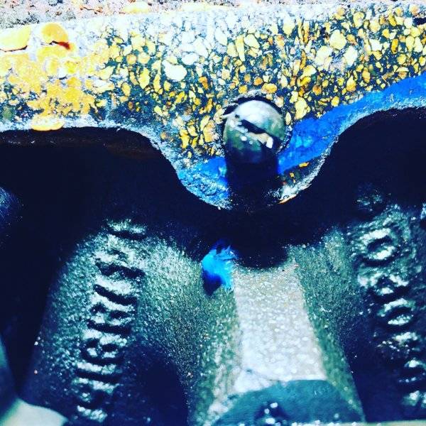

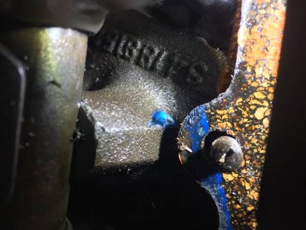

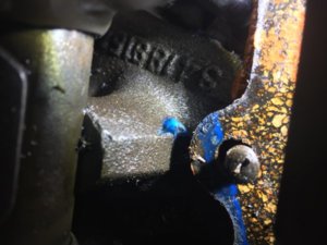

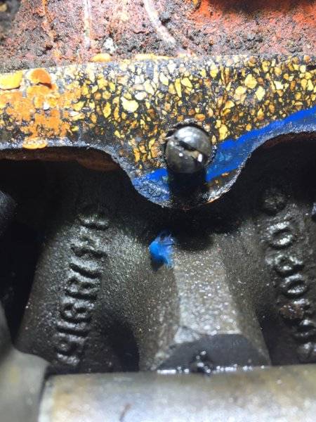

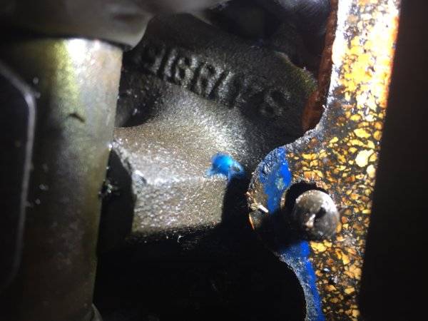

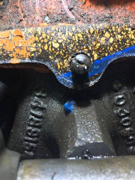

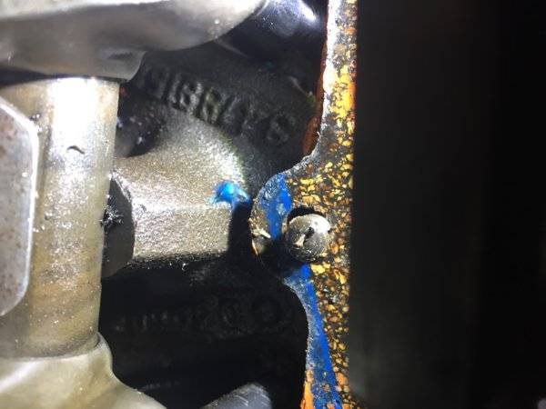

Hmm my phone seems to b adding these much simpler than the past here are several pics that I already had but it’s still -10 so fresh pics will wait lol
4F354699-EF52-43BD-BAF7-C129D25DED62.jpeg B6B64ACB-CA65-4184-A017-7E1032474CF2.jpeg 5C1B7596-E2BA-4754-AF2F-EC79271995DD.jpeg 035AC192-1631-4252-890C-A68CD8892477.jpeg CA256618-0610-4701-8F52-71F698D818B5.jpeg B0CB6E57-17D7-4B04-BB55-AA404EB5074E.jpeg F63AE1BA-D230-4406-9B7E-8013924568B0.jpeg

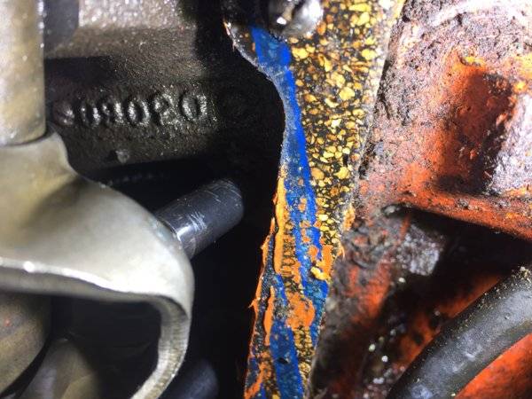

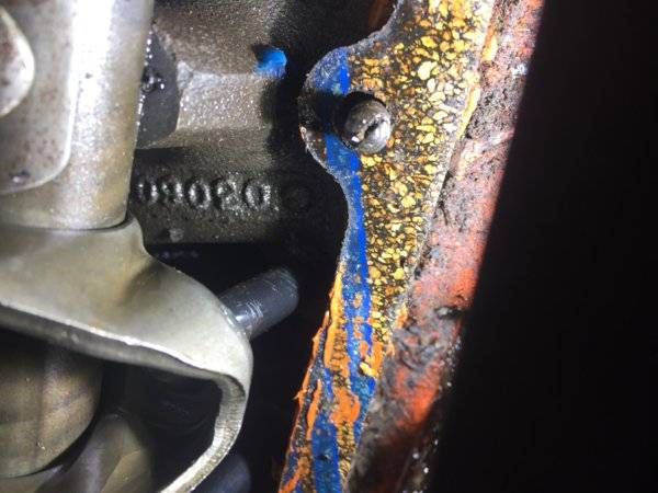

Yeah looking at the pics again I was even worn on the number it looks like it’s 9020 not 2020 so idk what that little plate means but I don’t think it helps us Id these. but it does look like the pushrods may be offset but I’ll need to look much closer to tell
Letter head stamping ID is on the outside of the head by the spark plug on ether end of the head.
So what does that number on that plate mean? Obviously some sort of I’d number but are there any numbers to match it too?
Casting ID numbers. Useless to me. The letter ID followed by valve size and condition is all I would need to know for purchase or useage.

TA heads would not have stamped rockers.
X or J will be obvious at the spakplug hole
