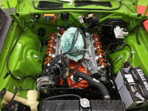

Hello all! And so it begins, again ... another build. I had just finished restoring a 1973 'cuda last year, a 3 year project, and planned to drive it for many years while I saved up for my unicorn ... a 1968 Charger. However, while showing it at the Atlantic Nationals this year in Moncton, New Brunswick I sold the car. It wasn't for sale, but someone wanted to buy it and as they say, everything is for sale for the right price. You can see the build before / after of the 'cuda here - http://www.cuda-challenger.com/cc/index.php?topic=96878.0 I enjoy building these cars as much as I like driving them.
With cash in hand my search began for a 1968 Charger project and after looking at many, I decided to move on the one you see in the photos below. It's a project! It's mostly complete, but needs a lot of work ... and that's the way I like them ... the satisfaction that comes from bringing one of these cars back. I do all the work myself - from metal work, body work, paint, mechanical, motor and drivetrain. I do outsource a couple things - like media blasting.
This is a hobby for me ... my work profession is IT related. I fit in time between work and my young family. I look forward to all your support and expertise as I restore this Charger - I will have lots of questions!
In September, I hooked up the trailer and my oldest son and I went on a 3000 mile road trip from Halifax Nova Scotia to Pennsylvania to pick up the car. We weren't far from Summit Racing in Ohio so had to stop in there! Sure wish I had one closer to me.
Here are before and after of the cuda as well.
