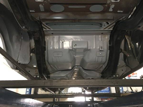

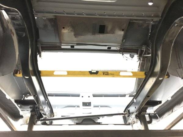

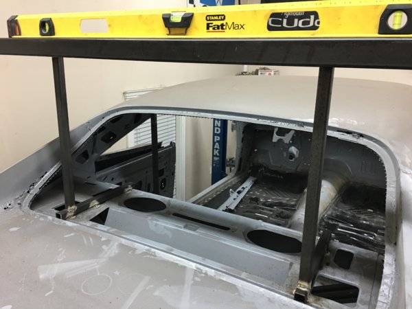

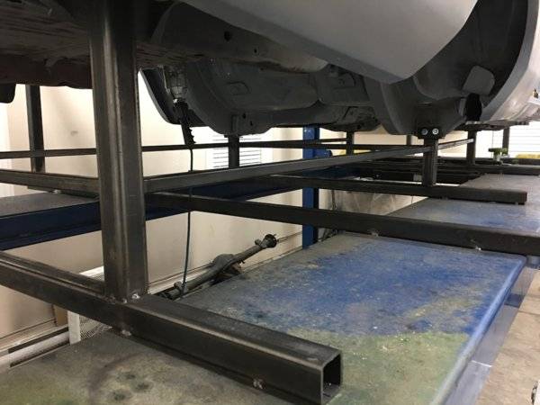

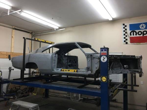

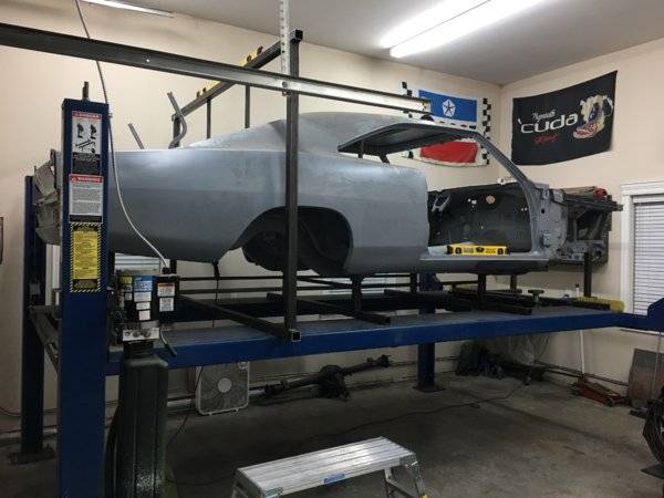

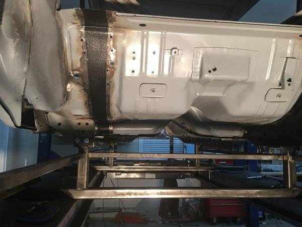

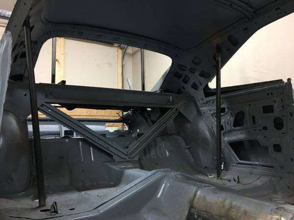

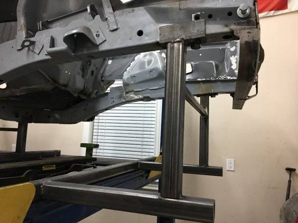

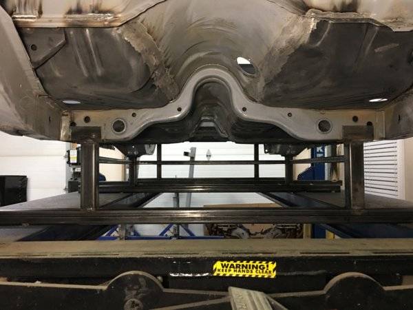

The frame/chassis jig is complete, measurements and pictures taken ... this baby is ready for surgery!
9FA5310E-C4D2-4561-9402-B3CF0473D33D.jpeg BDFB5CEB-A863-47EC-8329-221A614FA3B7.jpeg 1E4D4DB0-CEBC-446D-82C9-DE33961E6707.jpeg FC6F9B0B-5A2E-4CC4-9652-44E79E63104D.jpeg 97B9387F-6CC0-477E-B570-FA629EA938AE.jpeg FA13DD38-9633-4955-81B6-FB837C8D80A9.jpeg 5E1CA941-0A94-453F-80F1-6CB3B405648C.jpeg

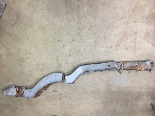

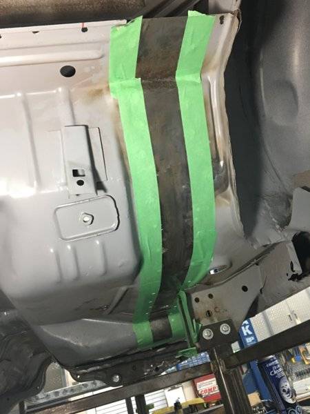

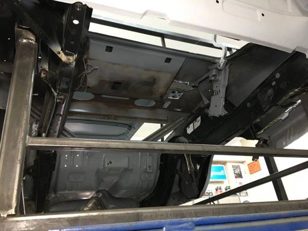

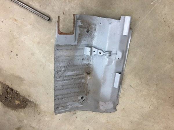

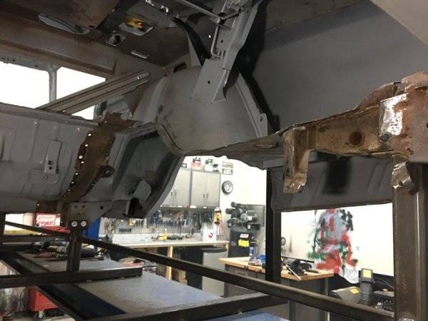

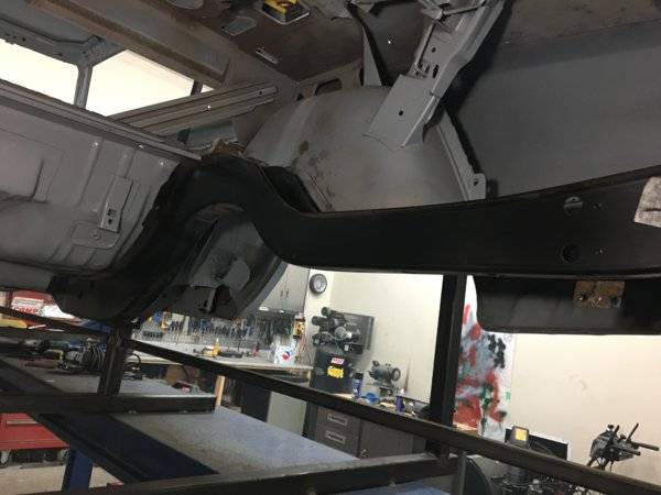

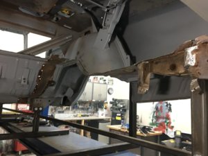

Surgery has begun. RH rail out and put the new one in for a quick test fit - great fit! Next step is to clean up the areas that are staying, place for it’s final fit and tack it in! Progress!
29CE944F-239D-477A-8AC2-120046219AEC.jpeg 55D8080E-3FEE-4E60-B49D-BFEE2317A859.jpeg AC843A24-876C-40BC-AD10-6657BDA1B41E.jpeg

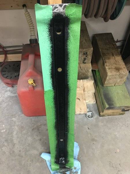

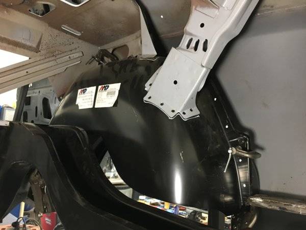

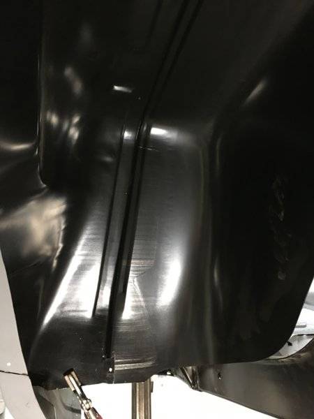

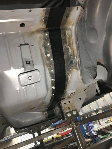

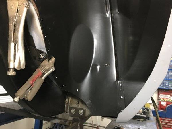

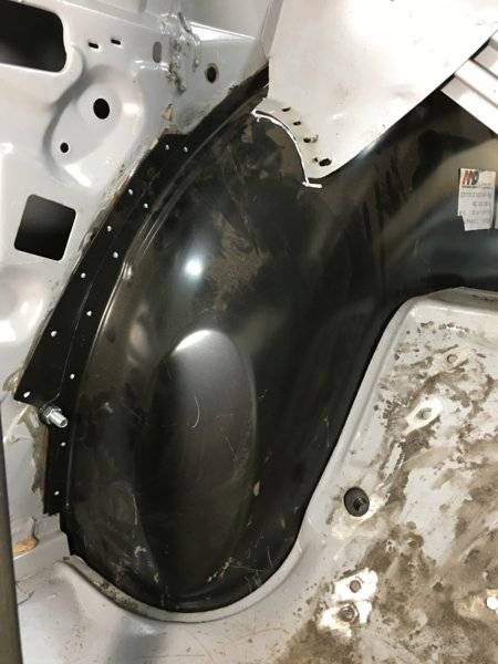

Work continues ... both new rails and spring hangers are tack welded in. Just cut out the right side wheelhouse and have the new one in for a test fit.

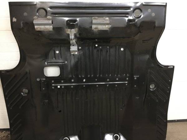

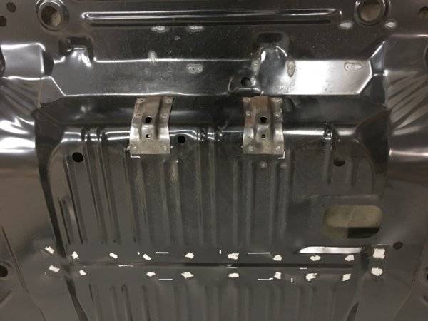

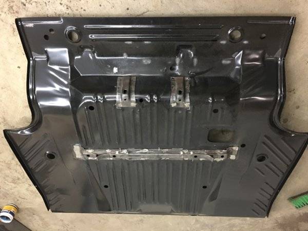

Also saved the gas tank brackets/hangers and spare tire brackets and welded them to the new trunk floor. So it’s ready to go in once I finish up the wheelhouses.

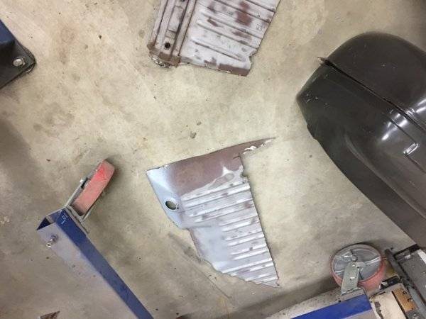

Great work. What are you using for a spot weld remover? That is the most difficult task out of all this to me. I go through bit after bit even hi quality ones....
I rarely use the spot weld cutters, unless I need to save the piece underneath. I use a 3/8 drill bit and find it so much easier. And my trusty air chisel are what works for me.
