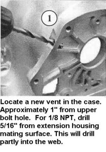

Guys: Looking for advise on where to drill to vent the case on the rear of a 727 Torqueflite. What type of vent is best, hole size, 1/8 or 1/4 pipe thread? Ebay sells the small plastic vents and any experience and advise on those would be good too.
I've added a few pictures of where I'm at.
I have taped and plugged the front pump vent already.
This is where I want to put the vent. Have any of you guys installed the vent in this location? It's open just behind the bolt boss which would allow venting from the rear housing.
Yes, that is the right location. Also, I drilled a small hole in web part below the hole so any trans fluid can drain and not fill that area.

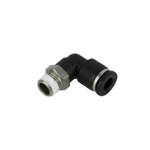

I have these fittings with nylon air brake tubing running up to the fill tube and zip tied. I haven't had any fluid come out the vent tube.
https://www.amazon.com/gp/product/B00B6J1X8M/ref=oh_aui_detailpage_o02_s01?ie=UTF8&psc=1
https://www.amazon.com/gp/product/B00CLXGHQU/ref=oh_aui_detailpage_o01_s00?ie=UTF8&psc=1
I like that fitting and using synflex line. Thanks!
