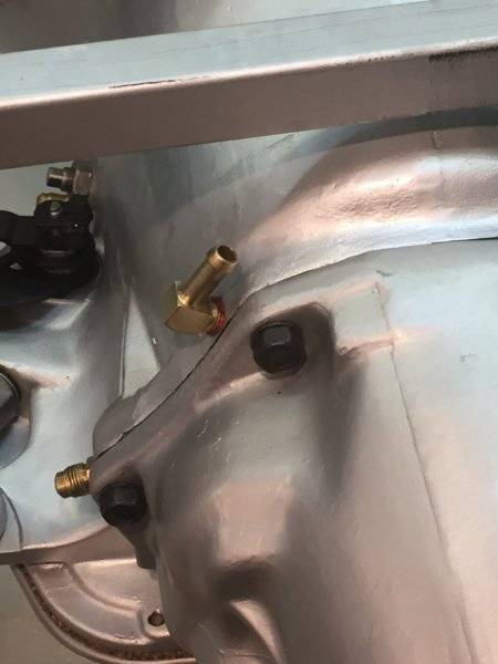

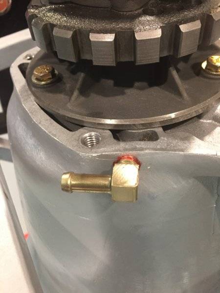

Guys, thanks for all your help with the positioning of the rear vent. I drilled, taped and threaded a fitting in this morning. Appreciate the help and advise as always!

Malex ,
you may want to adjust direction of fitting , when it goes in car pointing straight up may be close to floor . Mine points to front of car .

Ok thanks Tex, I will be watching for that.

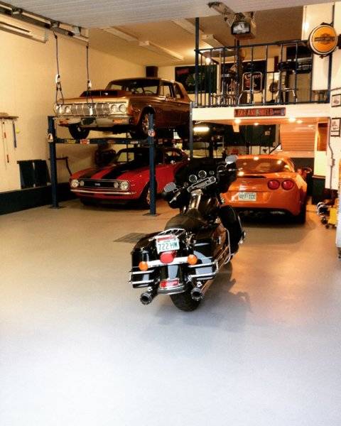

Very interesting stuff.... I do have a question Malex, just looking at your floors I have to ask are you working in a hospital??? Holy sterile operating rooms!!!
Really neat trans dolly to!
Yes, that is the right location. Also, I drilled a small hole in web part below the hole so any trans fluid can drain and not fill that area.

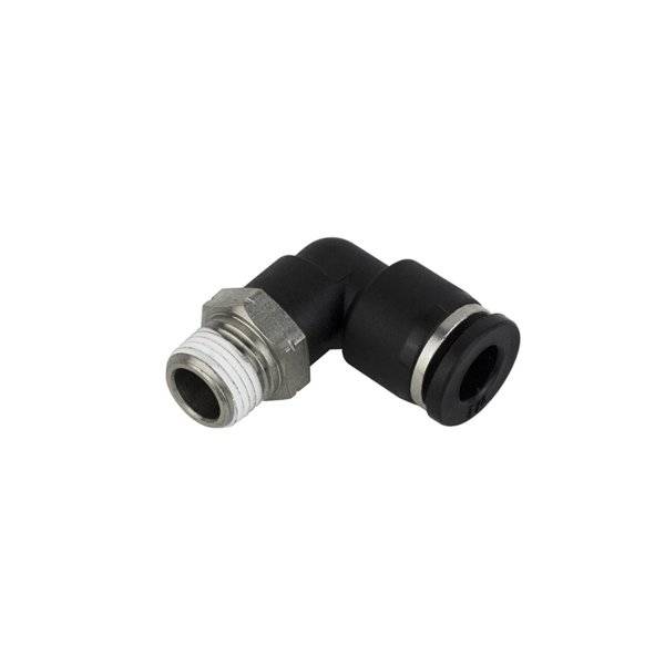

I have these fittings with nylon air brake tubing running up to the fill tube and zip tied. I haven't had any fluid come out the vent tube.
https://www.amazon.com/gp/product/B00B6J1X8M/ref=oh_aui_detailpage_o02_s01?ie=UTF8&psc=1
https://www.amazon.com/gp/product/B00CLXGHQU/ref=oh_aui_detailpage_o01_s00?ie=UTF8&psc=1
This is exactly what I use. Line usually shows fluid in the line , but no overflow.

Thanks for the compliment Mike! I think.
I like to keep things neat. Not sure if it's a choice thing or a phobia. Lol.
Actually when I built the place I applied 2 coats of Amerlock 2 part epoxy on the floor. Great stuff, tough as nails. That was 15 years ago now. I've top coated it since then to freshen it up and will do it again one of these summers. My floor is heated and sloped to a centre dual compartment drain so it's easy to hose down and keep clean. Speaking of drains, once in awhile the old drain will start to stink like they all do. As soon as I notice it I'll throw a chlorine puck in and just like that, drain odor gone! Lasts for at least a month or more. If you ever run into that, give it a try.
