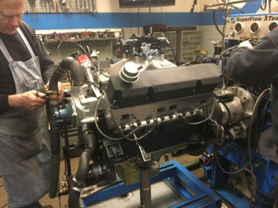

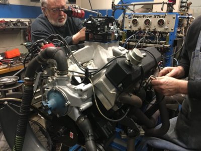

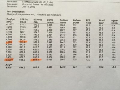

So this Happened today... will post video to my YouTube Channel. Had a leak at the front of the oil pan/ bottom of the timing cover? Sooo that will be fixed. Otherwise made 4 pulls. They adjusted the timing from 36 to 34 once which dropped a couple Hp so stayed at 36. The Wilson spacer gave the best number for the day.
This is “corrected power” data. I’ll share the other data if it is preferred. I don’t know the proper Dyno etiquette.
The numbers are COOL, but I was glad the “Mystery Mudder” turned out well. To be honest it’s more than I really wanted... and I have mixed feelings about it. I have a Cope Pro Street rmv transmission and we are building a Dana. But a long ways to go yet
It started perfectly, no issues breaking in. The Quick Fuel carburetor was literally “out of the box” barely needing adjustment.
We used 91 octane with less than 10% Race gas, but looks like it can live on 93 octane. Which would be cool.
I’ll find the cam card and give details adout the build in the next post from me on this thread.
I’m sharing this for guys looking at Trick Flow 270s. I am not a mechanic or engine builder. So this is as much as I know for now.
Thanks

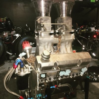

What was I thinkingI this I what I started with:

That is really nice. Oh and corrected power is generally what is shown.
400 block bored .45 over, 12.5:Compression ratio
440 Source 512 Stroker Kit
Comp Cams 324A-8 solid lifter Cam
290/290 duration at .50
108 lobe separation
.650/.650 gross valve lift
Comp Cams 1.5 steel roller rockers
Tick Flow 270 heads
INDY Max Wedge intake
Quick Fuel 850 cam carb
Wilson 2” tapered 4 hole spacer on final pull only
Gary said they did some slight clean up porting on the heads (unshrouding the valve guides?) and everything was port matched to the intake gasket
I sold the tunnel ram, predator carburetors, Stealth heads, oil pan and external remote oiling system, electric water pump, Howard’s solid roller cam and the 440 Source 1.6 ratio roller rockers, and the Milodon gear drive system.

Very nice but that combo was just getting to the good stuff at 6100 when you guys shut her off, lol. I think I would have least gone 7000rpm.
Yeah, looks like it might of had a little more but we built it with 6000 rpm in mind. Already going to be pushing the bottom end at that rpm. And wanted to fix the leak.
