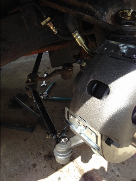

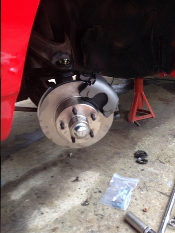

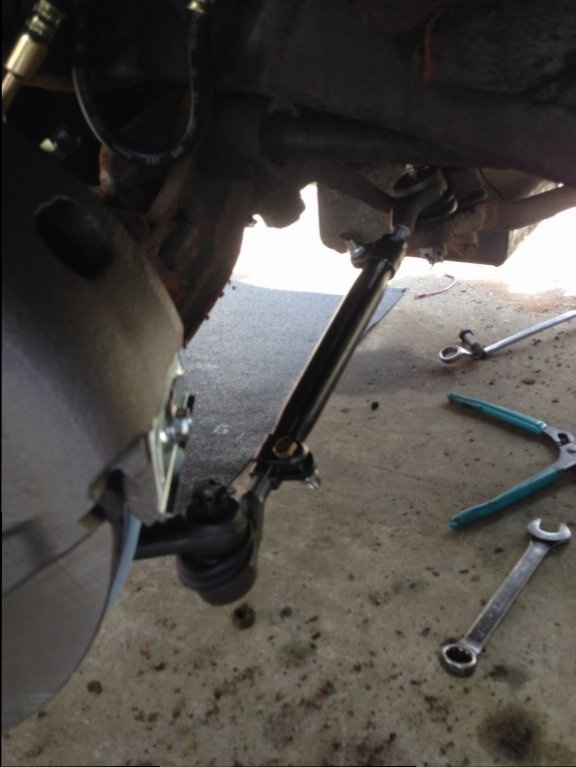

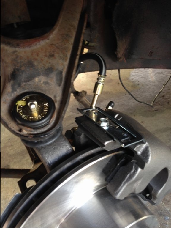

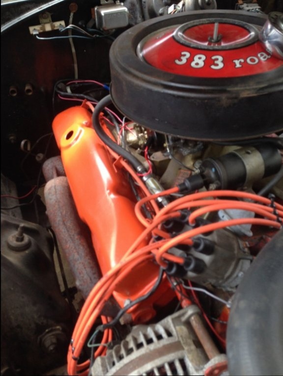

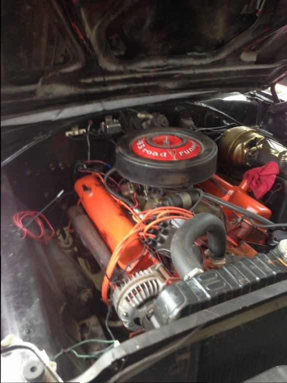

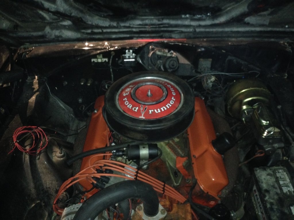

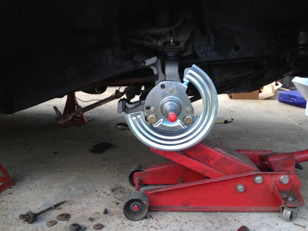

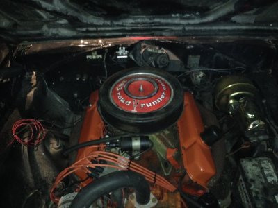

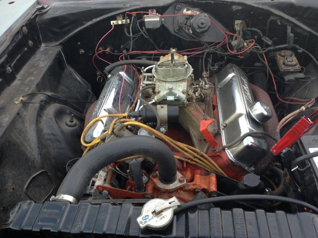

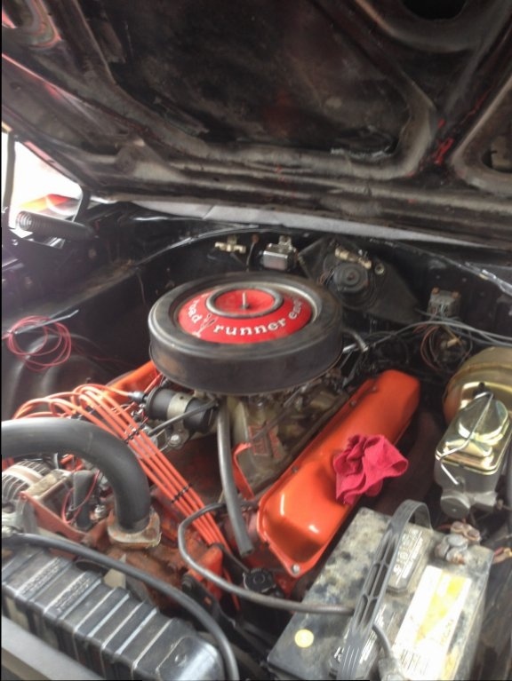

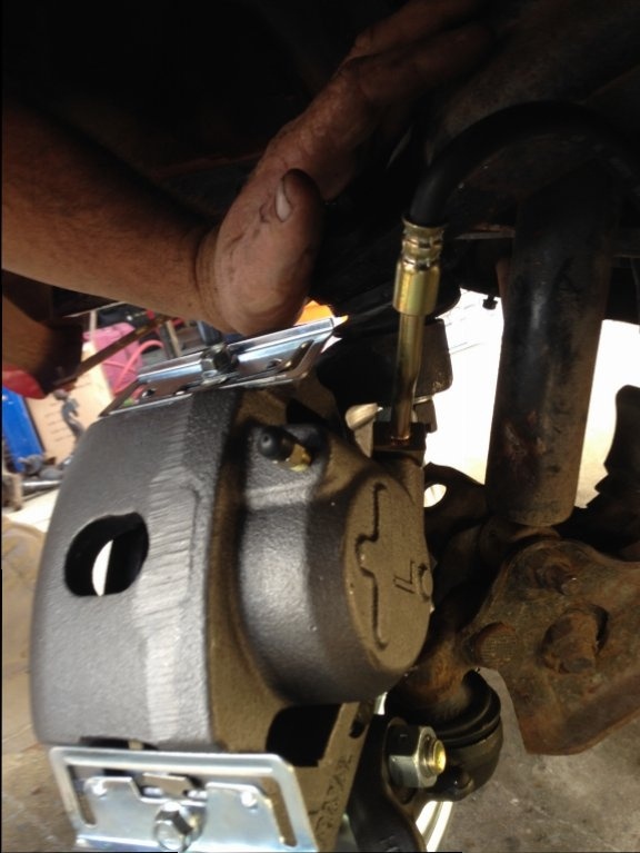

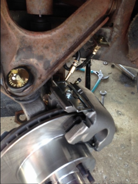

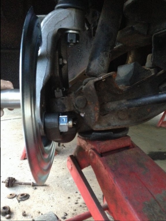

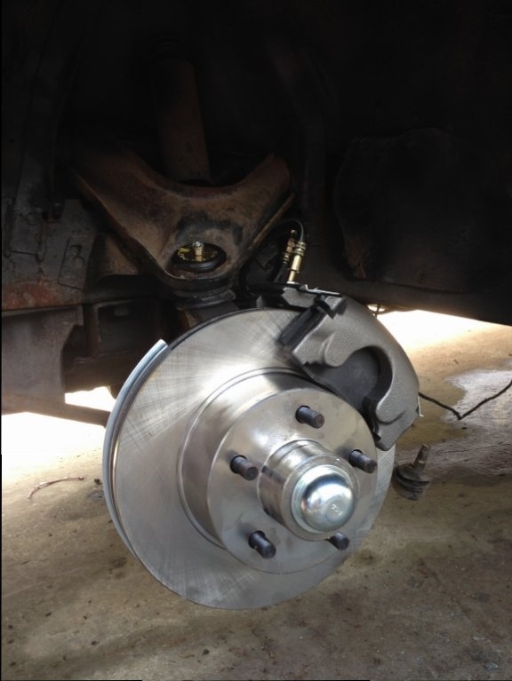

I installed a right stuff front brake conversion on the Road Runner. This kit says that if the wheels came on cars that had factory disc brakes then those 14 inch wheels will work. Anyhow The conversion went pretty easy with a couple hiccups. The dust shields need a little trimming around the large bolts that connect the spindle to the lower ball joint. I have not completed the entire setup yet due to having a crushed brake line at the rear passenger side and a clogged rubber line at the rear end. I have since replaced both parts rebuilt the back brakes with new wheel cylinders and shoes. Then while pulling the rear drums off the axle on the adjuster side of the car came out a little. Turns out the adjuster was crushed and not able to re screw into the adjuster plate. Anyhow 400 dollars later we now have some axles in route to the house. Also replaced all front steering parts with Moog parts. Also couldnt stand the chrome valve covers so I bought some off ebay and cleaned up the engine a little. Before and after pics at the bottom.

The brake hose situation looks interesting. Should there be some concern there? Just curious.

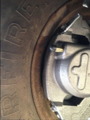

on my belvedere did the front disc brake conversion , i used a doner car i bought , it was a diplomat 1982.
the callipers to wheel clearance is about 1/4 inch tight but don't see any problems with my 14 inch rims.
yours look close . i would grind away the calliper in you have too , or the wheel will
These also have about a 1/4 inch. It looks closer in the pictures but it clears just fine.

I noticed your hoses. Did they come with your kit? That twist looks ,.. well,.... interesting. Just curious.
Yea the hose came with the kit. I tried installing it several ways I was a bit confused by it. But that was the only way it would go on without hitting the ipper control arm and still allow full travel of the spindle. I agree they could have done a better job with that. But it works with no binding.

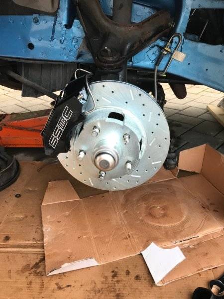

I just converted my fronts with an SSBC kit last weekend. I liked their kit because it used the old drum brake spindle and I didn't have to touch any front end components, no alignment necessary. It took me about 2 hours per side. The kit was complete and all parts fit perfectly. The caliper mounting bracket seems to be coated in a heavy black plastic. Some of that coating got into the threads for the mounting bolts. I just chased them all with the proper bolt before mounting so I didn't cross thread any of them while installing. I'm replacing the master cylinder and installing an adjustable prop valve this weekend. Then we'll see how they actually work !!!! Here's a before and after pic.

I mounted the brakes towards the rear of the rotor. Now looking at that picture of the SSBC setup, wondering if I should move them to the front. That may have been why the hoses were weird. But again the instructions didn't say where to put them as far as I can remember.
The SSBC kit specifically indicated that the calipers mount towards the front. I was a little leery about the hose routing also, but turning the wheels chock to chock, there was no kinking or interference. Going out there now to mount the new master cylinder and prop valve. Hope it all works !!!!
