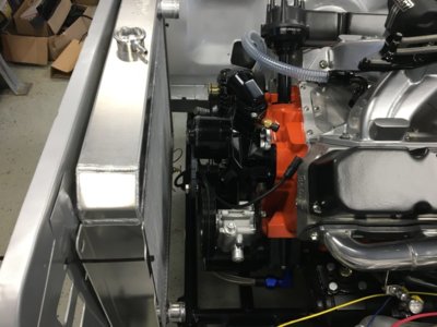

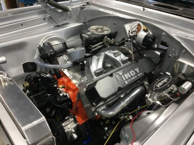

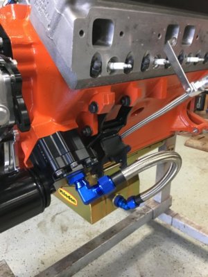

Bought a Milodon external oil pick up for my 440. Supposed to work with stock motor mounts and they offer another version for motor plates which i did not get. It Uses the Milodon oil pump, cover plate and pan so you think it would work together. Not sure what Milodon had in mind but no matter how I run the hose it doesn't work. The instructions say to have the line turn up out of the pump so oil doesn't drain back into the pan causing dry starts but that makes it worse and the hose is like a foot to short togo around under the engin. I am running a QA1 cross member and Borgeson steering box but I would have thought they would help the situation being they are both much smaller then stock stuff.
Anyone have some pics of how they routed there single oil line from the pump to the pan?
Some pics of what I have.
E83F95AE-0687-4D43-8910-02B1B9099B73.jpeg AE76D664-ED8F-4395-869E-721F43A6AC33.jpeg 05A7E80E-ED6B-4058-AA5C-6D7D71405527.jpeg 0AABA328-537F-4C1B-8939-EB79327B9AE8.jpeg
I have always used a front entrance oil pump. So my fitting doesn't leave the bottom like yours. One thing I see that is reverse from how I did mine. The 90 degree fitting was in the pan, not at the pump. That allowed my line to go up and hug the block. Then cross over the top of the motor mount in your case and curve under the header tube into the pump. rather than being laid out away from the block. You can clock it to about 11 and it shouldnt drain back.

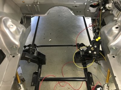

My problem is if I route the hose under the mount and along side the steering box it rubs real bad on the steering box no matter how I clock it, almost to the point of kinking the hose. I see some guys use a 45 on top of the 90 off the pump, this may bring the hose closer to the block and get it off the steering box but I'm thinking I should just come straight up from the pump, then loop around toward the radiator, then come under the oil filter just above the k member and into the oil pan, basically throwing the milodon hose in the garbage. Also another problem is I don't have a single blue fitting anywhere on this car and would really like to change those blue to black fittings. looks like the fitting in the pump is special to the pump with a longer then normal tapered AN fitting then a bulkhead o-ring back up nut. I don't see this in a black version on Earl's or Russell's website.

I called Milodon, This is the fitting they use at the pump. They modify this areoquip fitting by cutting off the first threaded section then putting the bevel back on. He did say it didn't need to be (nor should it be) bottomed out in the pump.

A straight fitting like this has ZERO sealing ability. They put a nut and o-ring on there BUT the oil still seeps past the threads on the nut. Not much but on a pretty car like yours its gonna always have a wet spot around the fitting. The solution is to use pipe sealant on the fitting into the pump (and you could discard the o-ring). Teflon tape doesn't work and do NOT use silicone !!
At the pan you have a similar issue, a straight fitting into the pickup. And of course they supply a nut and o-ring. But the same problem exists here. And the solution is the same - pipe sealant on the fitting into the pickup. And at the pan the best place for the o-ring is inside the pan between the pickup and the pan wall.

Yes you are correct about the taper I meant the taper as on a AN fitting not NPT type taper. Anyway you bring up a good point with the thread sealant on the threads and I wish I would have thought about it earlier cause the pickup is already in the pan attached to the motor already in the car so can’t address that now. I did just order the o-ring/-AN adapter and a 90 -12 hose end to make the turn up and then a 120 deg -AN to start back down towards the radiator and then back to oil pan between oil filter and k frame. This should work. And yes if any oil seeping does acure it’s really going to piss me off. Why wouldn’t Milidon just weld a bung to side of pan instead of using a bulkhead fitting. Then you could use any fitting you wanted at any time without worrying about leaks.
